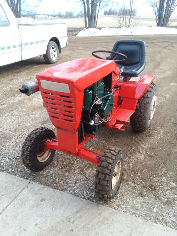

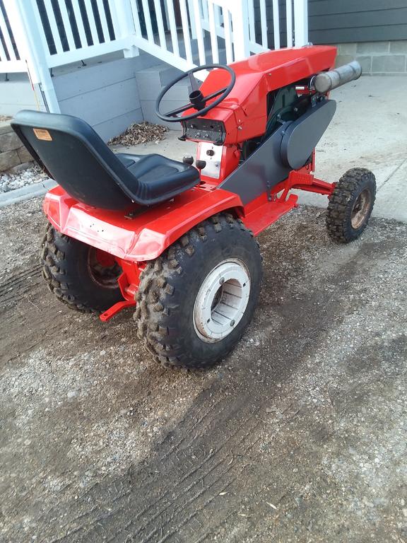

Cvans 1,009 #83 Posted March 14, 2020 Had the Lister WH out for a test drive. Everything works fine except the belt keeps pulling when the clutch is depressed. Made the parts for a clutch brake and will install it in the morning. Then it will be time to pull the big roller. 1 4 1 3 Share this post Link to post Share on other sites
Pullstart 71,482 #84 Posted March 14, 2020 Looks great! As for the rear end, 1.5-2 qts aughtta do! 1 Share this post Link to post Share on other sites

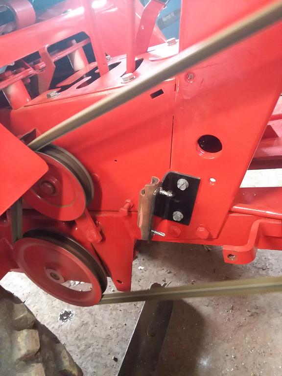

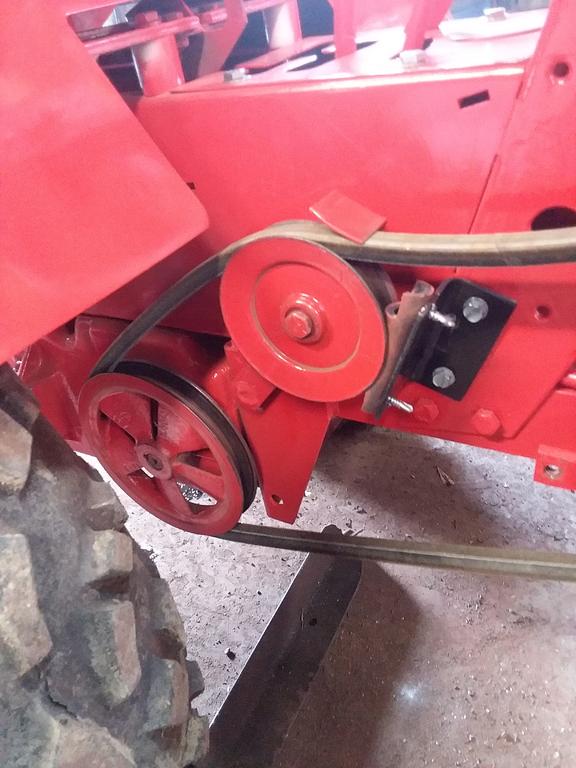

Cvans 1,009 #92 Posted March 14, 2020 (edited) This is a simple belt brake that seems to work fine. Can shift now with no problems. Edited March 14, 2020 by Cvans 3 Share this post Link to post Share on other sites
