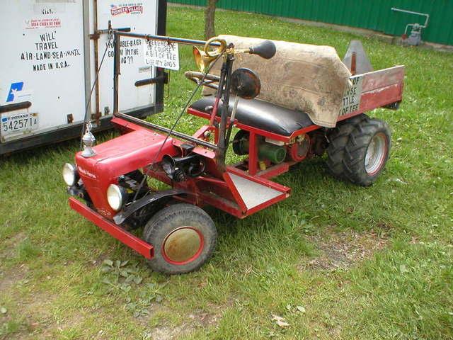

wallfish 20,618 #151 Posted January 25, 2020 Wheel Horse version? Just throwing stuff out there because ya never know what triggers the light bulbs! 1 1 2 1 Share this post Link to post Share on other sites
19richie66 17,935 #152 Posted January 25, 2020 44 minutes ago, wallfish said: Wheel Horse version? Just throwing stuff out there because ya never know what triggers the light bulbs! That’s cool Share this post Link to post Share on other sites

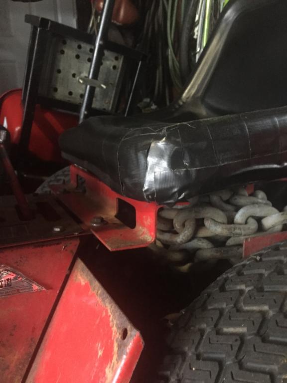

oilwell1415 563 #153 Posted January 25, 2020 I think you may have mentioned this in the video, but I couldn’t hear it very well on my phone with the background noise I’m in. If you moved the hood forward you would gain a ton of seat space without having to add to the wheel base and adding a little tractor in front of the front wheels will help the proportions since you’ve go tractor sticking out behind the rear wheels. For width, have you considered narrowing the bed? Then you wouldn’t have to move the tires out so far to set it between them. I’m seriously considering taking a foot out of the middle of the little trailer I got, but that’s just so it will be easier to get in the back yard. 1 Share this post Link to post Share on other sites
Pullstart 71,259 #154 Posted January 25, 2020 1 hour ago, oilwell1415 said: I think you may have mentioned this in the video, but I couldn’t hear it very well on my phone with the background noise I’m in. If you moved the hood forward you would gain a ton of seat space without having to add to the wheel base and adding a little tractor in front of the front wheels will help the proportions since you’ve go tractor sticking out behind the rear wheels. For width, have you considered narrowing the bed? Then you wouldn’t have to move the tires out so far to set it between them. I’m seriously considering taking a foot out of the middle of the little trailer I got, but that’s just so it will be easier to get in the back yard. I moved the hood forward after the video was taken and gained quite a bit of room. At this point, I don’t think I need to stretch the frame any more, just figure out where the hood needs to be in relation to a bench seat. I am pretty stuck on not hacking the bed for the time being. We’ll see how it works out... 2 Share this post Link to post Share on other sites
SylvanLakeWH 32,552 #155 Posted January 25, 2020 I think multiple seating would be a plus given your intended uses and family size... Just a thought but why not 3 WH seats side by side on a beam going across? Outside two Act as fenders and take up the width of the bed...when you are alone or with others driver just uses the middle seat... FYI - I just used standard door hinges on The WHrat WHrecker seat and it works perfectly...easy up easy down... Just my ... 1 Share this post Link to post Share on other sites

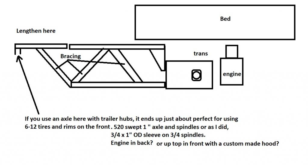

953 nut 69,374 #156 Posted January 25, 2020 On 1/9/2020 at 2:30 PM, wallfish said: Basic idea Do as the fish said, not as he did! With those tall tires on the front I think the one inch spindles are a must. Everything is fine rolling straight ahead, but when you turn sharp the forces a tall tire and wheel will exert are far greater than a smaller 8". Perhaps a "D" front axle or even a custom made set of "A Arms". 1 Share this post Link to post Share on other sites

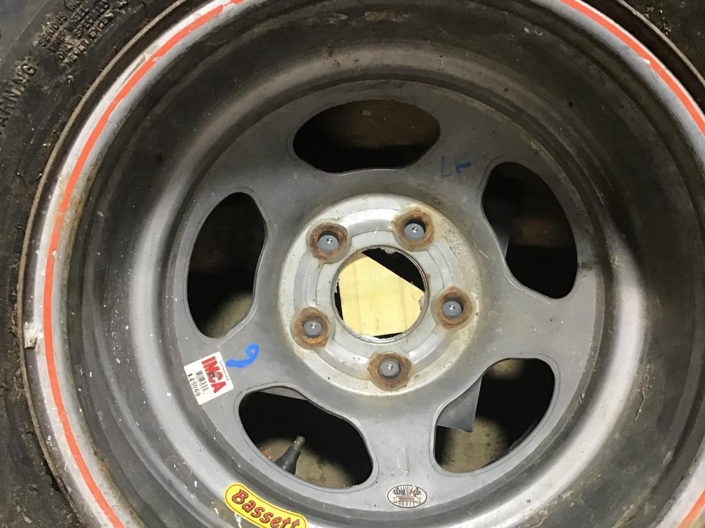

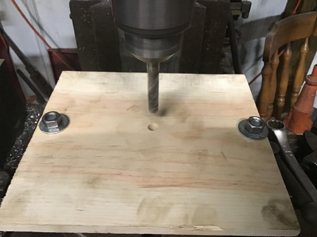

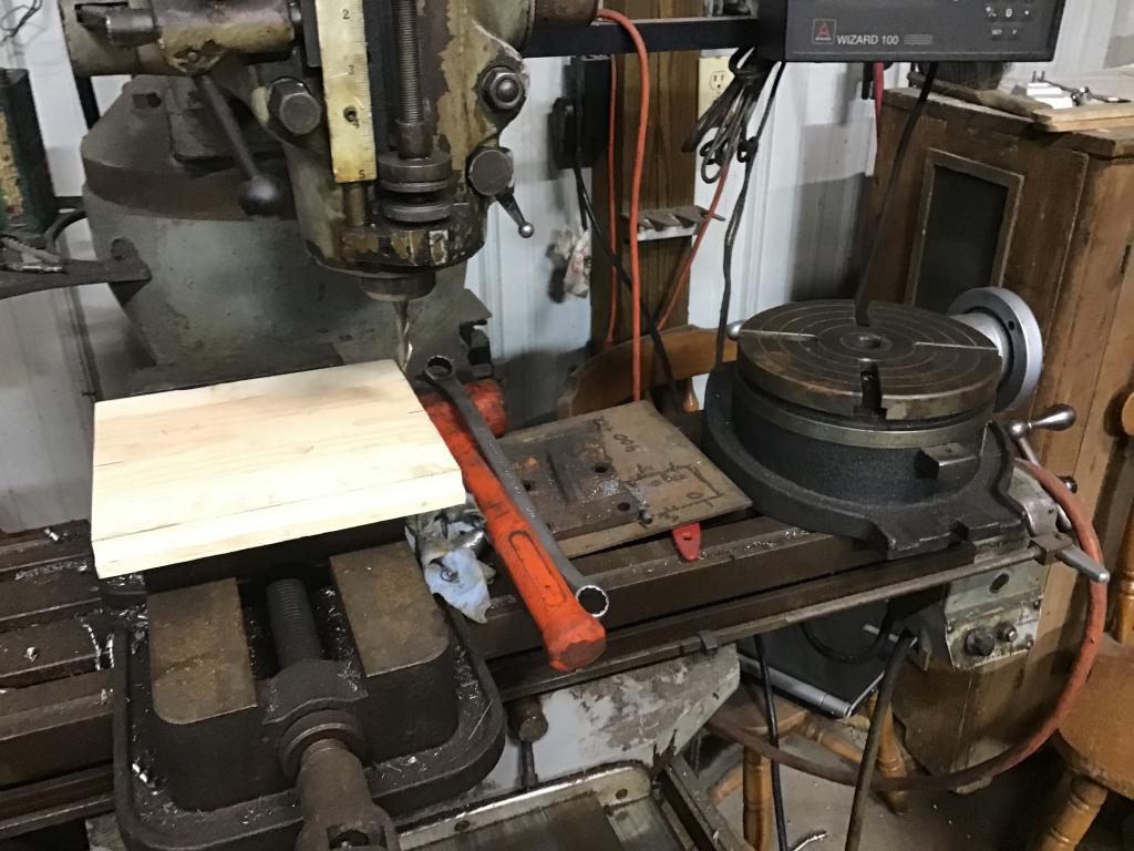

Pullstart 71,259 #162 Posted January 26, 2020 I am going to attempt a set of wheel adapters tonight. Scrap wood is cheaper and more abundant than 1/2” thick steel plate. I’ll start with the wood. Share this post Link to post Share on other sites

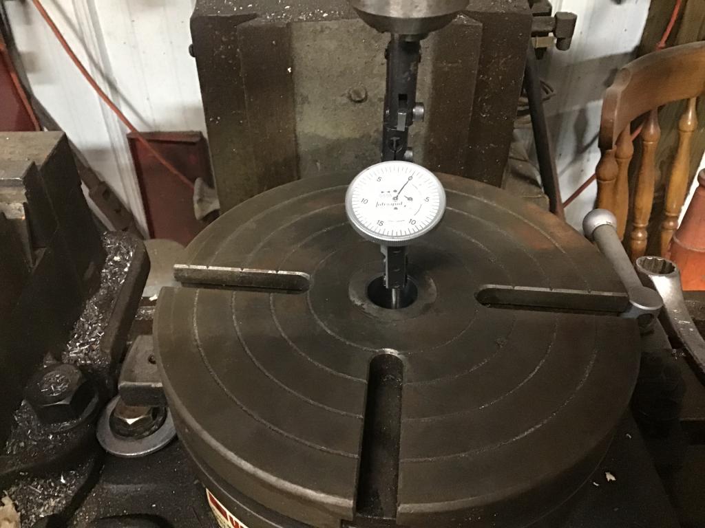

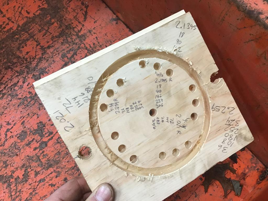

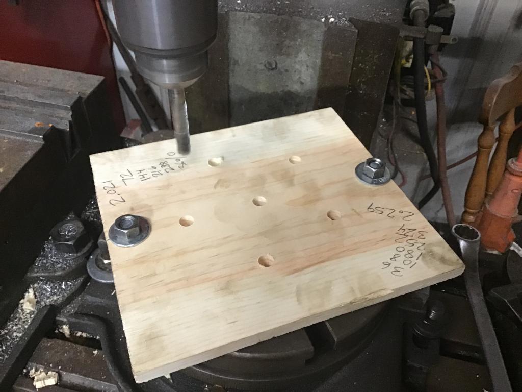

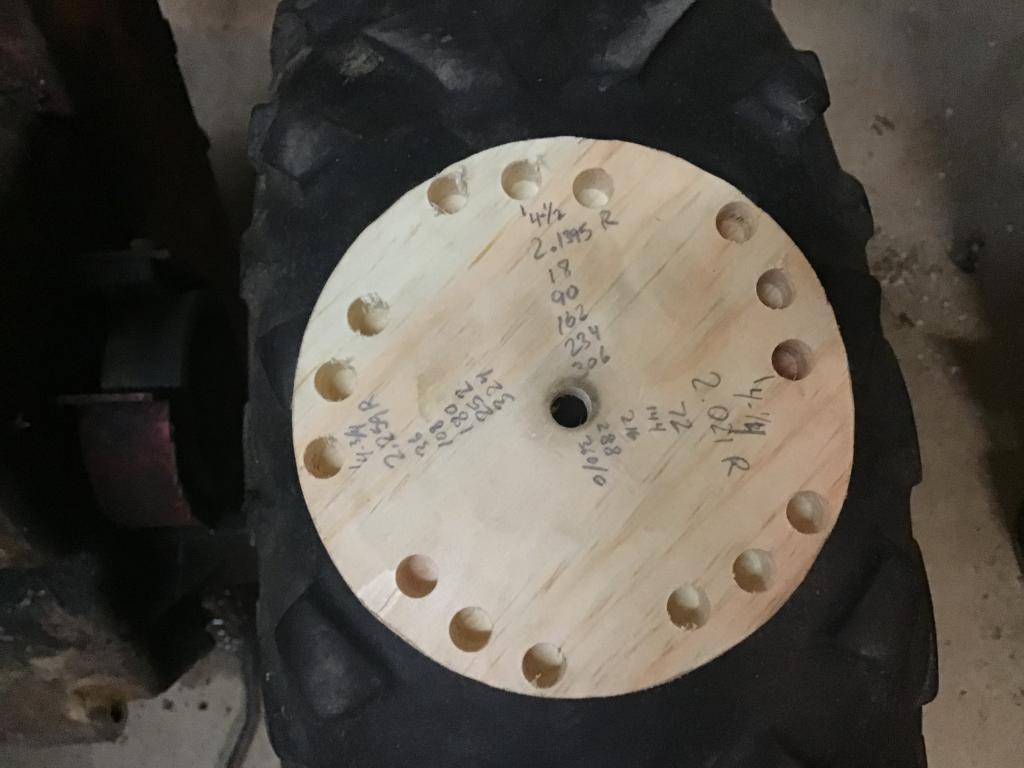

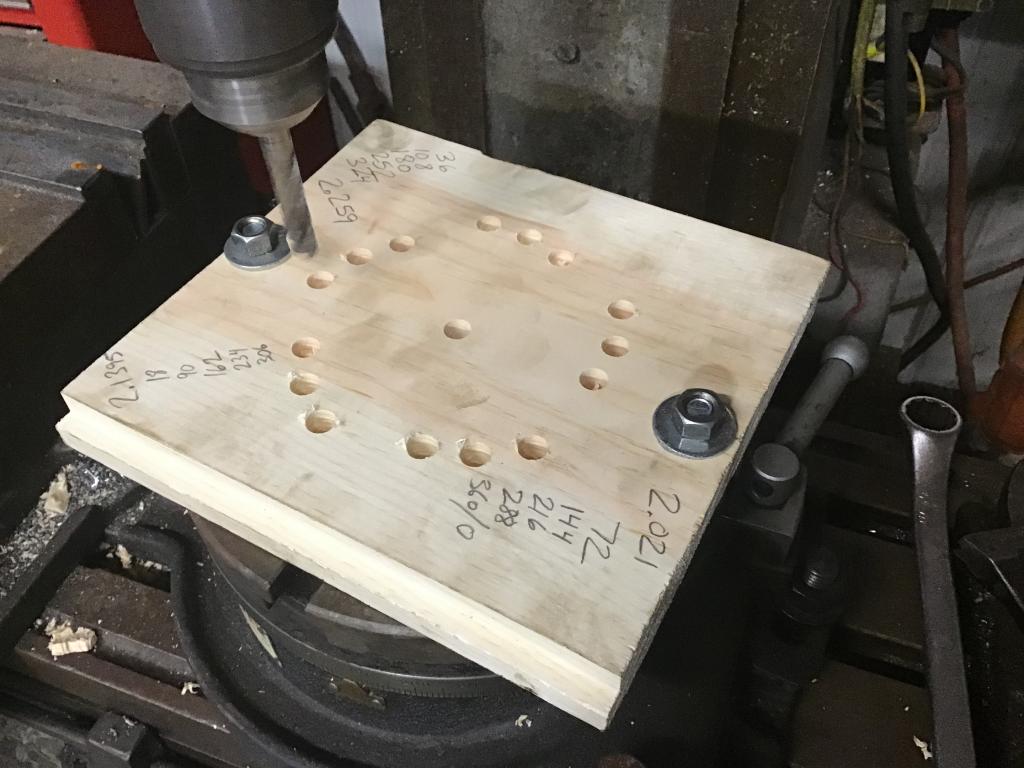

Pullstart 71,259 #166 Posted January 26, 2020 On 1/16/2020 at 1:09 AM, 8ntruck said: I did some trig. and came up with the following bolt center to bolt center distances per your sketch: 5 on 4 1/4 is 4.042 5 on 4 1/2 is 4.279 5 on 4 3/4 is 4.518 The angle you need to turn your rotary table between bolt holes is 72 degrees (360/5). I worked in the OEM wheel industry for 40 years. This is easy peasy stuff. Hope it helps. I built my jig out of wood for finding wheel centers! Thanks again Bill! 1 3 Share this post Link to post Share on other sites
Pullstart 71,259 #167 Posted January 26, 2020 23 minutes ago, oilwell1415 said: Maybe I put too much value on my time, but why not just spend $50 on ready made wheel adapters? It’s Saturday night and I’m home alone. Wife and one daughter in DFW / TX for a gymnastics meet, other daughter at a friend’s house. Why not waste some time building cool stuff? 2 3 1 Share this post Link to post Share on other sites

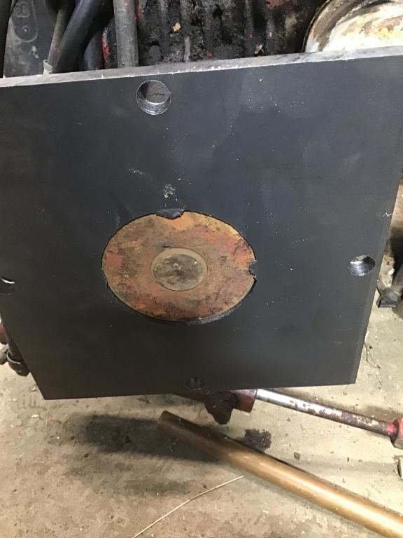

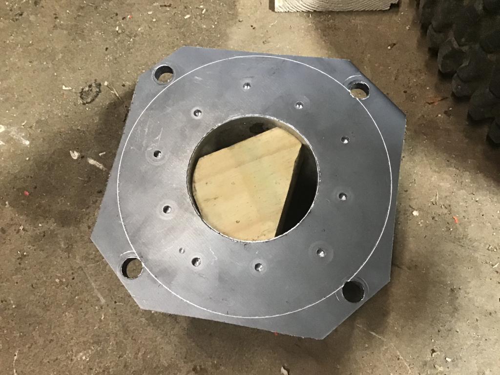

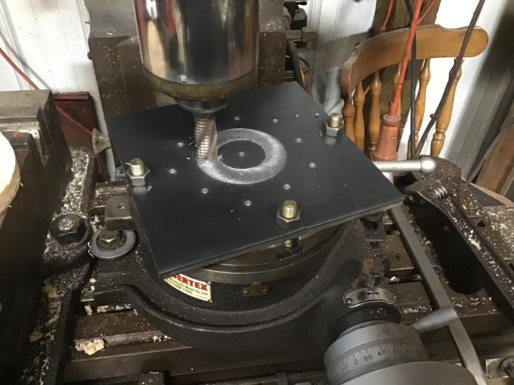

Pullstart 71,259 #170 Posted January 26, 2020 First real attempt... 3 1 2 Share this post Link to post Share on other sites

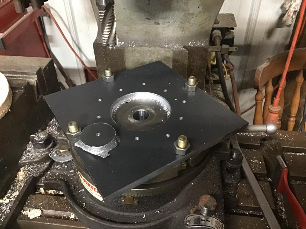

Pullstart 71,259 #171 Posted January 26, 2020 I kept plunging the cutter and rotating the table, until I was able to peel the center out last night. Unfortunately the pattern is a bit large on the wheel side, it it’s spot on for the hub. I’ll keep playing around to figure out what needs to be done, then cut another piece. The 1/2” plate I have ended up not being wide enough to use so I resorted to 3/8” plate. 5 Share this post Link to post Share on other sites

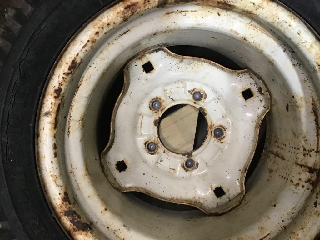

Pullstart 71,259 #172 Posted January 26, 2020 It must have been cross eyes and confusion last night, the adapter fit the hub and wheel just dandy! 2 Share this post Link to post Share on other sites
Pullstart 71,259 #173 Posted January 26, 2020 I smoothed the burrs on the hub clearance hole, chucked it up in the lathe and scribed a line around the outside of the piece. Then I cut the big corners off so I can still drill, but it’s closer to being ready to turn down to a circle. I’ll start the second piece in the mill, then set up for drilling, counter sinking, tapping and finish work on both pieces. 2 2 Share this post Link to post Share on other sites

Tractorhead 9,217 #175 Posted January 26, 2020 (edited) Have you verified you markings with a circle ? as far as i see on the pics, it is just one mark de-centered. But anyhow, good job 👍 Edited January 26, 2020 by Tractorhead Share this post Link to post Share on other sites
