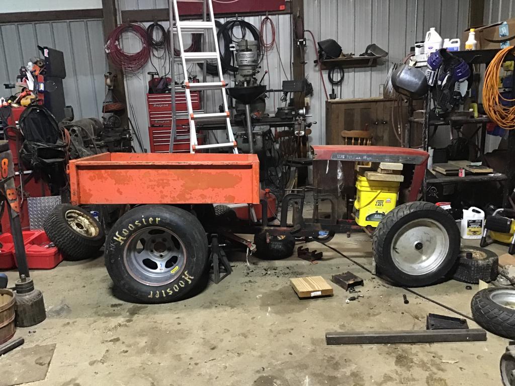

wallfish 20,618 #226 Posted January 29, 2020 41 minutes ago, pullstart said: I am not sure if this is funny or dumb. I have been trying to figure out a shorter hood. The Commando hood is 4” shorter. I can drill spot welds and replace the nose! We just gained 4” more leg room! Use the shorter hood with all the built in character. Is this going to be a trailer queen? 2 Share this post Link to post Share on other sites
Pullstart 71,259 #227 Posted January 29, 2020 40 minutes ago, troutbum63 said: Oh no not a command! Did you get a douner release first? I have no clue what you mean? Share this post Link to post Share on other sites
Pullstart 71,259 #228 Posted January 29, 2020 31 minutes ago, wallfish said: Use the shorter hood with all the built in character. Is this going to be a trailer queen? No trailer queen... but it’ll get to the shows. Time permitting, it’ll get stripped and painted up pretty before we load it with coop poop! Share this post Link to post Share on other sites

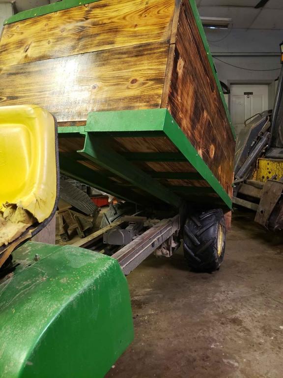

Andy N. 2,812 #229 Posted January 29, 2020 This was just posted a few days ago on FB Marketplace. Wrong color and all, but appropriate to the thread. It's in Lockport, IL if anyone is interested. 3 1 Share this post Link to post Share on other sites

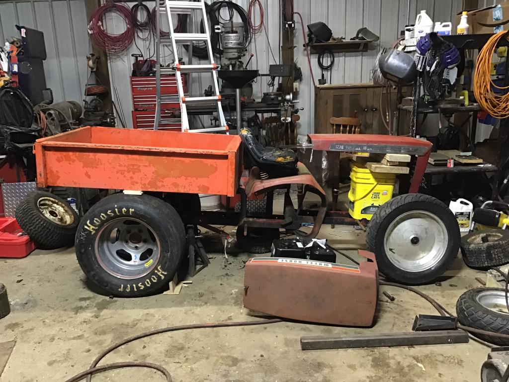

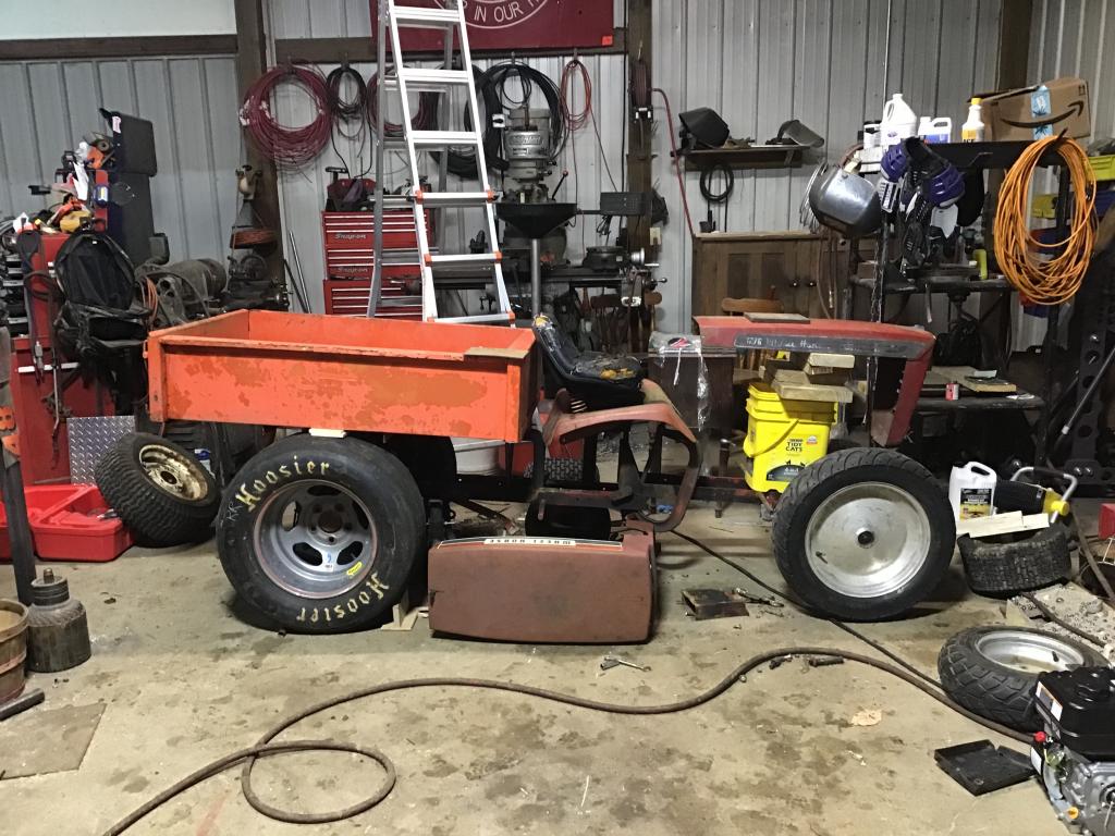

953 nut 69,373 #230 Posted January 30, 2020 15 hours ago, pullstart said: I have been trying to figure out a shorter hood. Why don't you just move the pivot point forward of the frame a little. I doubt that any "Purest" would even notice it on this otherwise unaltered . Share this post Link to post Share on other sites

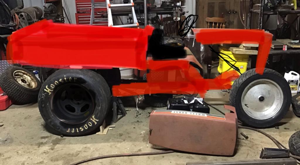

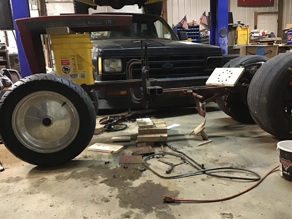

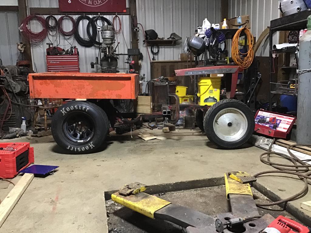

Pullstart 71,259 #231 Posted January 30, 2020 31 minutes ago, 953 nut said: Why don't you just move the pivot point forward of the frame a little. I doubt that any "Purest" would even notice it on this otherwise unaltered . Well you see, I have moved it forward to the point that I’m happy with it. It’s all about the proportion to the sketch! Here is some progression with my fancy jig work to see how it moved forward. 2 1 Share this post Link to post Share on other sites
SylvanLakeWH 32,551 #232 Posted January 30, 2020 The color of the bucket jig distracts from the overall scheme, but I personally like the lines of the hood relative to the dump bed... Please paint the bucket Regal Red and resubmit photos for a final grade by the RS brain trust... Lookin’ great! 1 Share this post Link to post Share on other sites
Pullstart 71,259 #233 Posted January 30, 2020 5 minutes ago, SylvanLakeWH said: The color of the bucket jig distracts from the overall scheme, but I personally like the lines of the hood relative to the dump bed... Please paint the bucket Regal Red and resubmit photos for a final grade by the RS brain trust... Lookin’ great! Oh it’ll get paint. All of it will get the paint. I love the way Frank turned out with the patina from years of work and clear over... but this is getting the paint. 1 Share this post Link to post Share on other sites
Pullstart 71,259 #234 Posted January 30, 2020 Here you go @SylvanLakeWH! My Regal Red dump creation! 3 1 Share this post Link to post Share on other sites

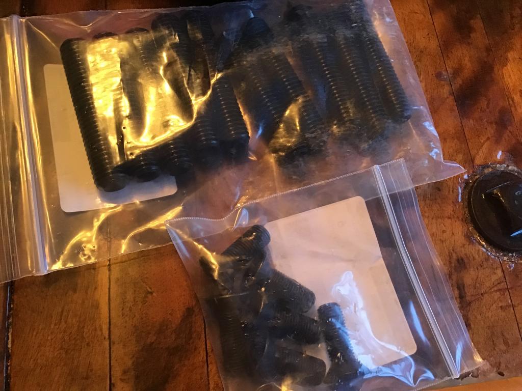

Pullstart 71,259 #235 Posted January 30, 2020 I received my bolts and studs in the mail. I figured because I’ll have more spacers, I can still run a couple bolts on each hub and these countersunk flat head socket bolts can help to center the adapters on the hub. I have room for a lot of spacers if needed, running these 3” studs. The first spacers will have clearance holes to clear the head of a normal bolt. Share this post Link to post Share on other sites
Tractorhead 9,217 #236 Posted January 30, 2020 whow, quickpaint.. 😂😂😂 1 1 Share this post Link to post Share on other sites
wallfish 20,618 #237 Posted January 30, 2020 How about an old school style cab ? Thought you were going 2 seater ? 1 1 Share this post Link to post Share on other sites

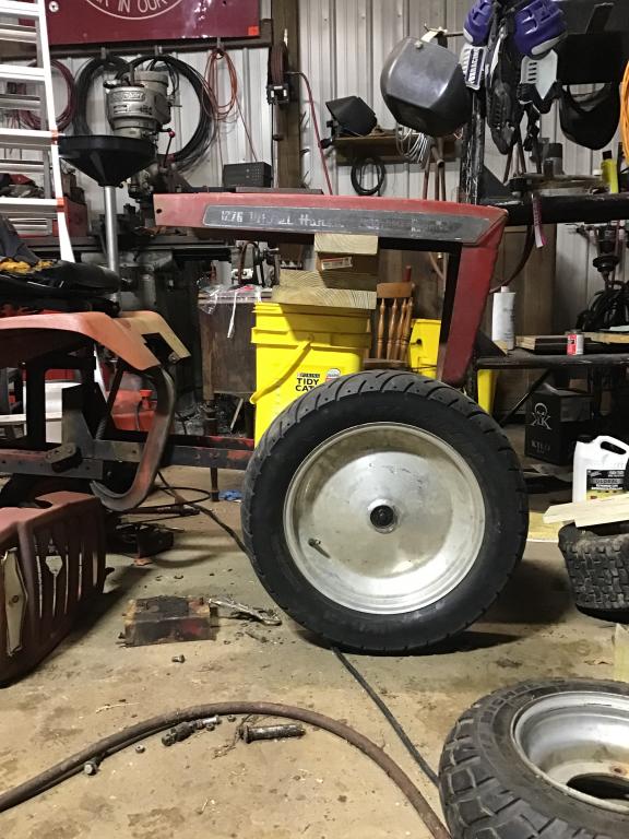

Pullstart 71,259 #238 Posted January 30, 2020 Just now, wallfish said: How about an old school style cab ? Thought you were going 2 seater ? Munster Mobile! I am doing a 2 seater, just using the WH pan and seat for visual mock-up. It’ll all change during the build.. Share this post Link to post Share on other sites
wallfish 20,618 #239 Posted January 30, 2020 24 minutes ago, pullstart said: It’ll all change during the build.. They all do! that's the process which makes things work 1 Share this post Link to post Share on other sites

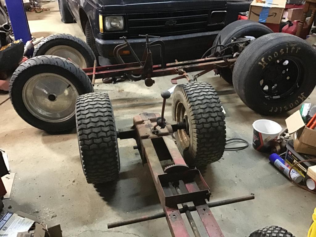

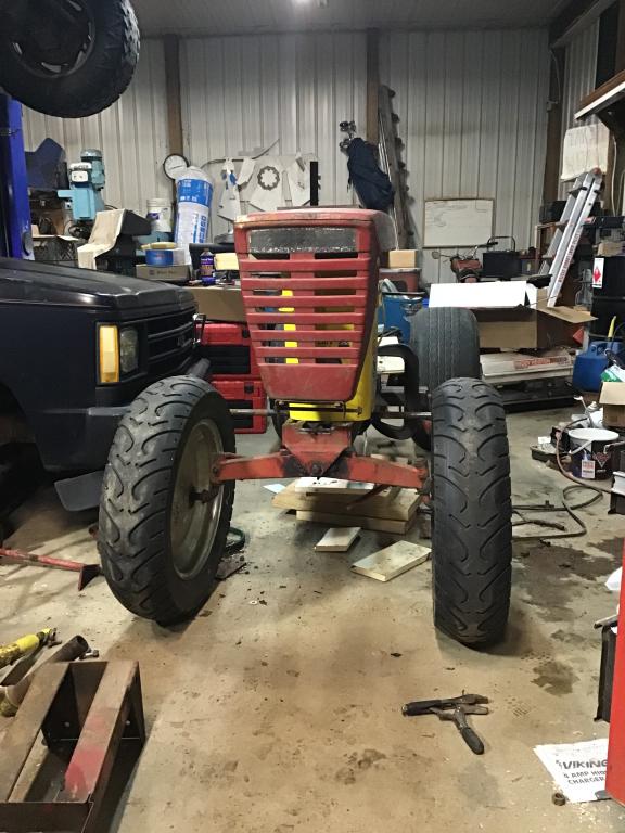

Pullstart 71,259 #241 Posted January 31, 2020 I stripped the roller parts down and took some measurements. Surprisingly I won’t need much kick up in the chassis. The center of the front axle pivot pin is about the same height as the top of the frame at the trans mount! 1 Share this post Link to post Share on other sites

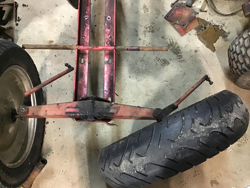

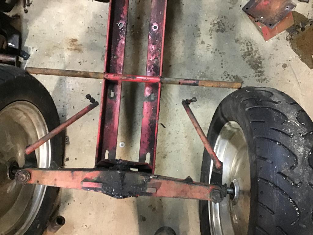

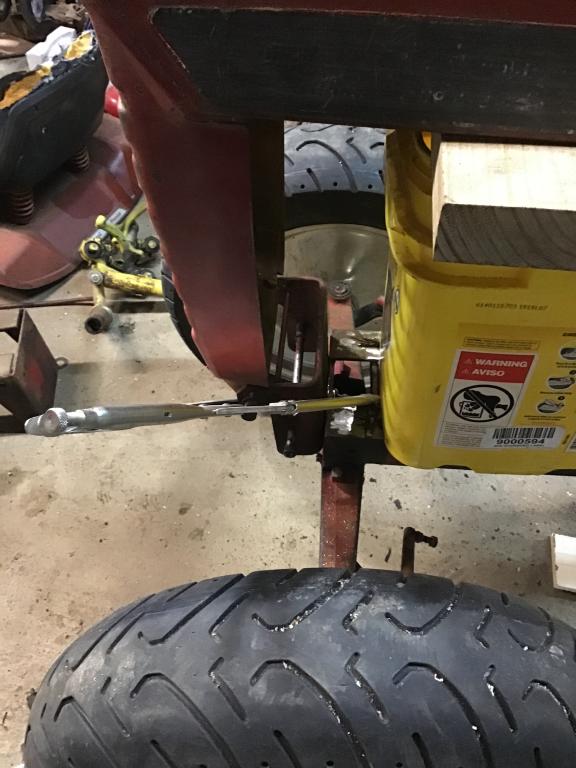

953 nut 69,373 #242 Posted February 1, 2020 How tight a turn can you get with the frame at the centerline of those tall tires? Share this post Link to post Share on other sites

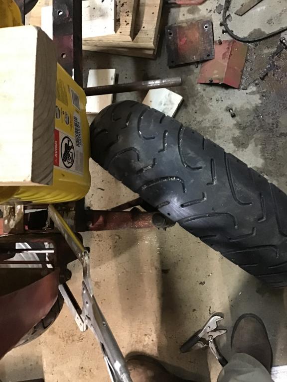

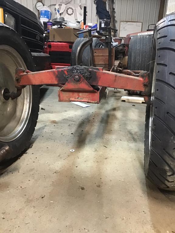

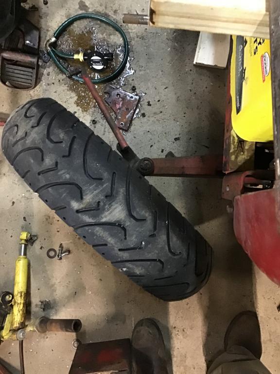

Pullstart 71,259 #243 Posted February 1, 2020 46 minutes ago, 953 nut said: How tight a turn can you get with the frame at the centerline of those tall tires? I’ll see shortly... right now, the 3/4” pegs limit any outward steering. Share this post Link to post Share on other sites
Pullstart 71,259 #244 Posted February 1, 2020 Here you go Richard. I imagine if I move the steering arms and remove the 3/4” pegs, I can have as much scrub as I’d like. Share this post Link to post Share on other sites

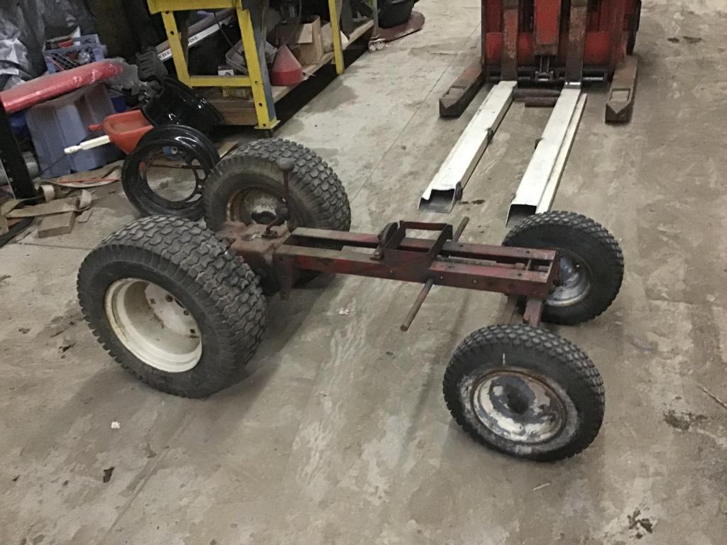

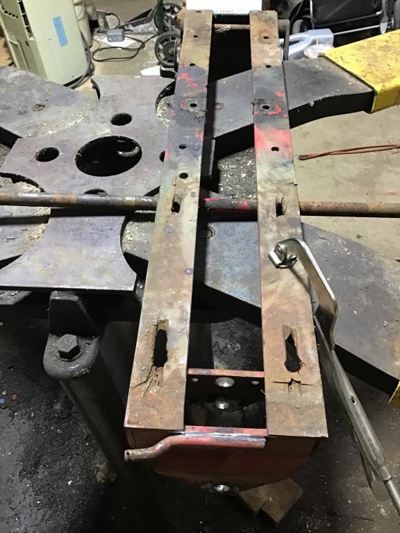

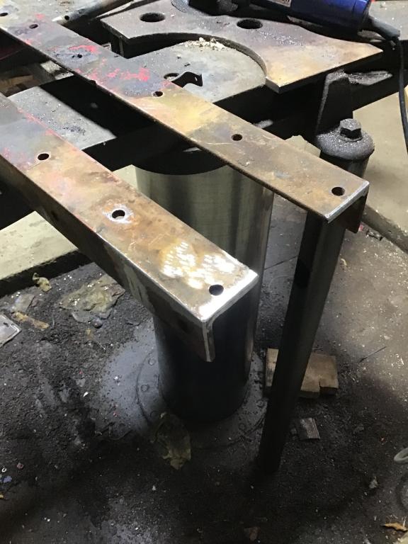

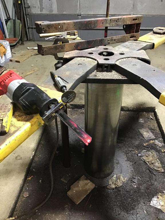

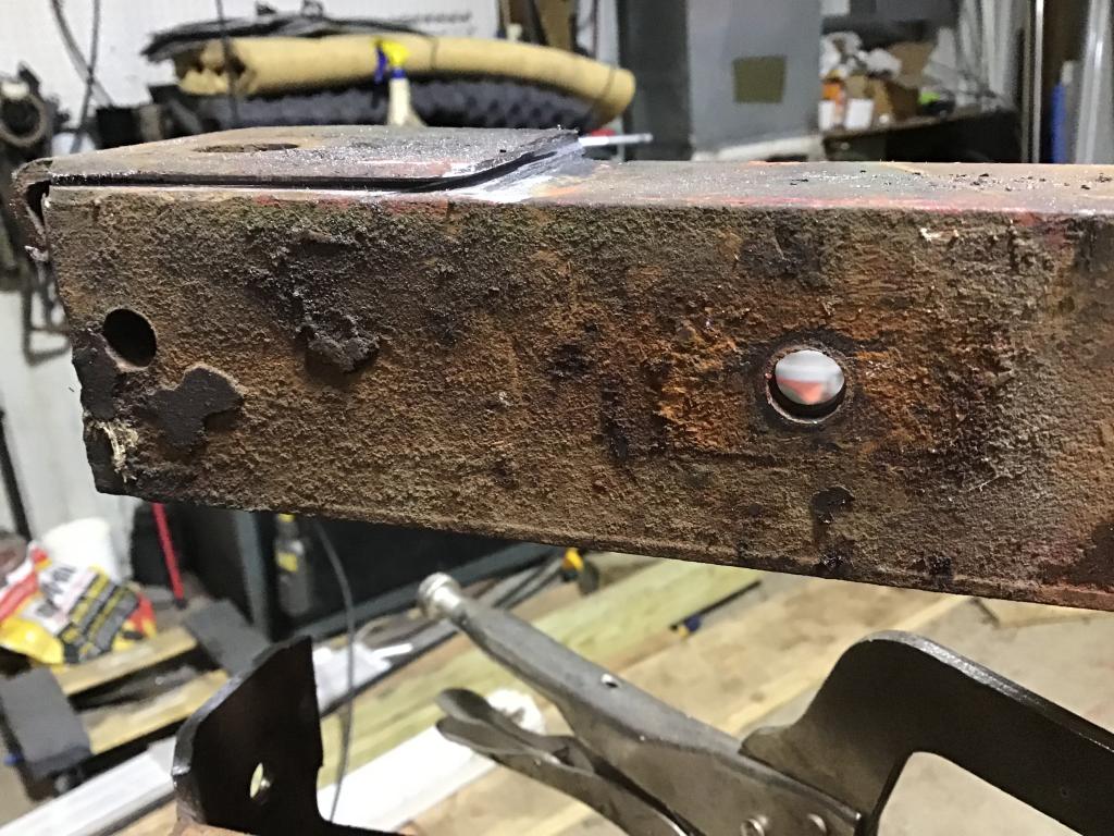

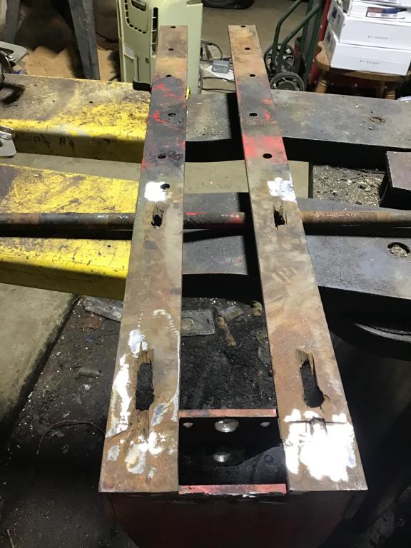

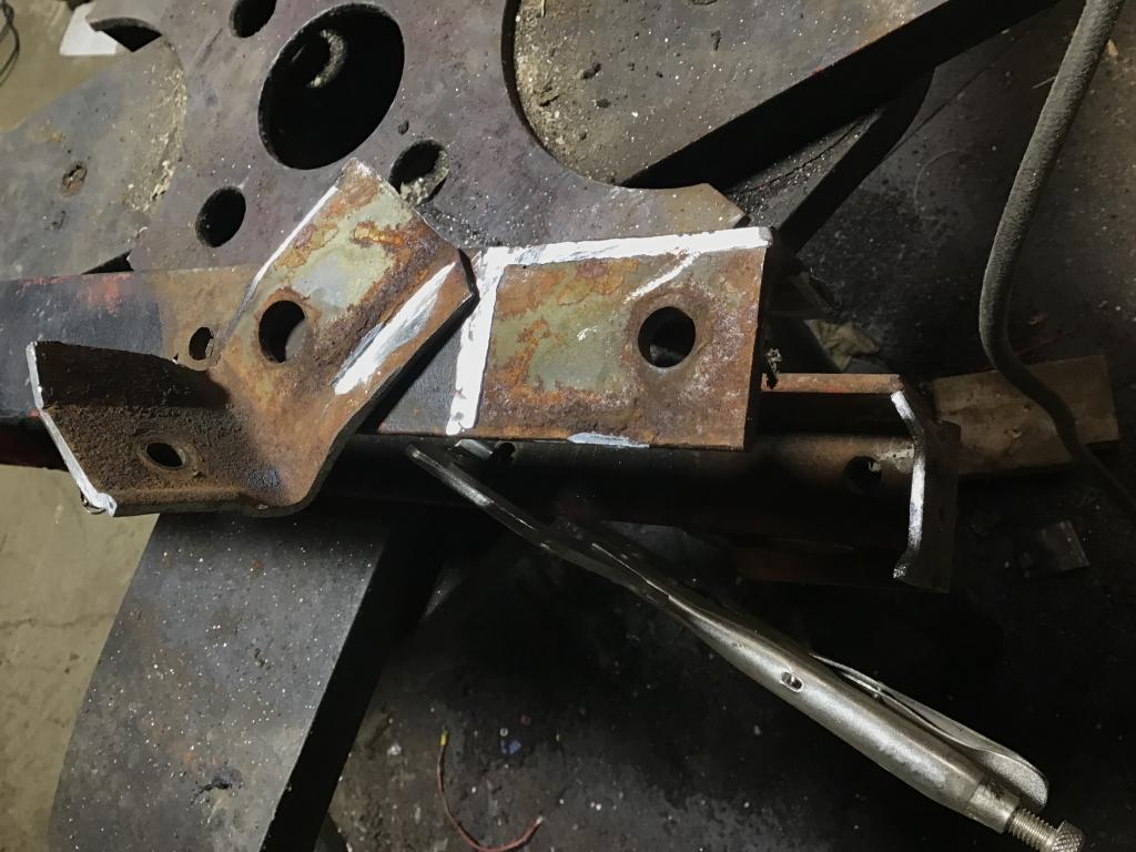

Pullstart 71,259 #245 Posted February 1, 2020 Metal work begins... 1 Share this post Link to post Share on other sites
Pullstart 71,259 #246 Posted February 1, 2020 Can’t wait for this chassis to be used again! 2 Share this post Link to post Share on other sites
Pullstart 71,259 #247 Posted February 1, 2020 With the front half of the chassis trimmed up, a 2” spacer clamped between the two assures me that things will come together quite well. When I weld the two halves together, I’ll push the kickup as far forward as possible to maintain the most leg room. 5 Share this post Link to post Share on other sites
