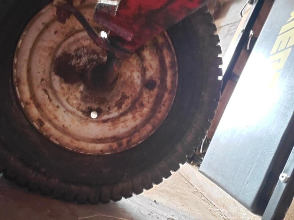

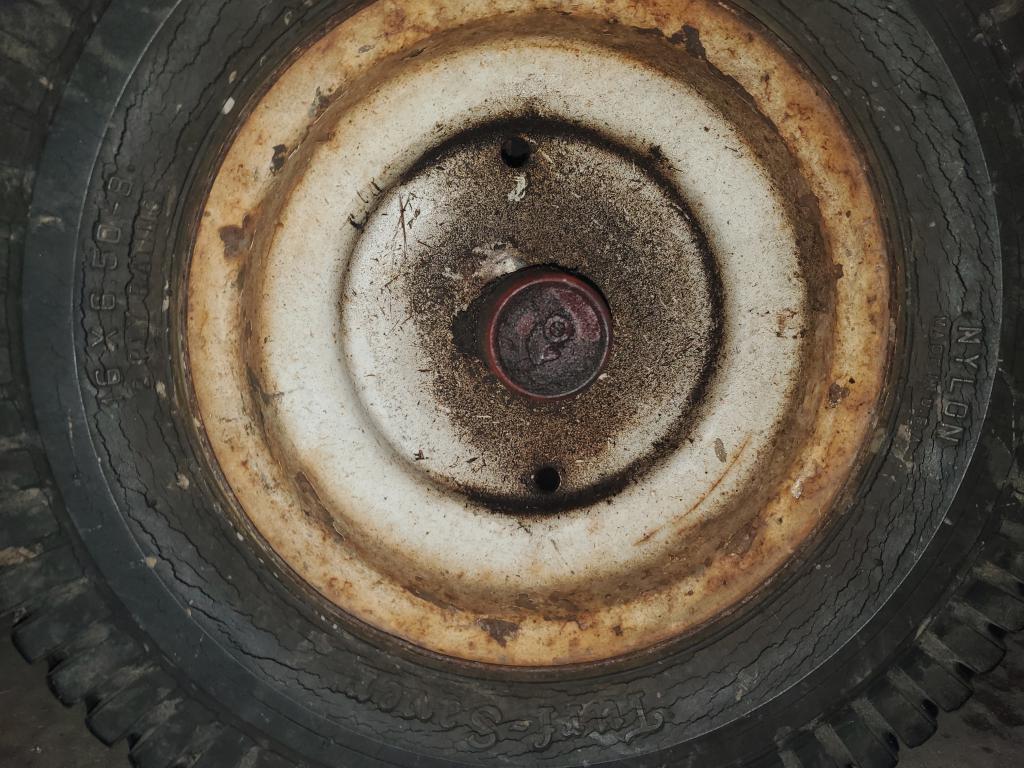

12Horse Paladin 1,038 #1 Posted January 5, 2020 Im looking to pull my tires. Rears are no problem. Fronts...wth, i have no clue...? I see no bolts, pins, nada... *scratches head* Pics are both sides of one; other is same. Stem is on the inside. Help! Lol. Y'all have a good day, n happy new year to everyone. May she be your best yet!😊 Share this post Link to post Share on other sites
Sparky-(Admin) 26,693 #2 Posted January 5, 2020 Pop off that red WH plastic cap and your find either a 9/16’s bolt head or a pin holding the rim onto the spindle. 5 Share this post Link to post Share on other sites
Pullstart 71,520 #3 Posted January 5, 2020 I have found 3/8” bolts (my preferred method) or C clips (pain in the butt sometimes) holding the wheels on. Frank... being a Frankenstein tractor... has one of each! 3 Share this post Link to post Share on other sites
12Horse Paladin 1,038 #4 Posted January 5, 2020 To both above...thank you. But...hmm. Imma go out in a bit and take a pic of the OTHER wheel, now (has no cap; how i got it)...there is no pin (what i was looking for), or bolt, that i can see... Share this post Link to post Share on other sites
Stormin 9,988 #5 Posted January 5, 2020 It'll be held on with a circlip/c-clip. You really need a set of circlip pliers to remove/fit. Though you can peel it off with a blade. Just be careful it doesn't fly off. 1 Share this post Link to post Share on other sites
Pullstart 71,520 #6 Posted January 5, 2020 If it is the c-clip version, you’ll find it hiding under a decent pile of grease on the end of the axle, most likely. 3 Share this post Link to post Share on other sites
SylvanLakeWH 32,823 #7 Posted January 6, 2020 C clips like to fly once they are "free"... Watch out for flying objects!!! 1 1 Share this post Link to post Share on other sites
Pullstart 71,520 #8 Posted January 6, 2020 Yeah... I like to hold a rag over the clip to play catcher’s mit! 3 1 1 Share this post Link to post Share on other sites

gwest_ca-(File Mod) 12,535 #18 Posted January 6, 2020 When you get the retaining ring off take a good look at it. They are stamped when made so one side has rounded edges and the other has sharp edges. In this application you want to install it so the sharp edges face out so it fits the groove better. If installed with the rounded side out side pressure on the wheel can force it off the axle. The groove in the axle deserves a good cleaning also. Garry 2 1 Share this post Link to post Share on other sites
