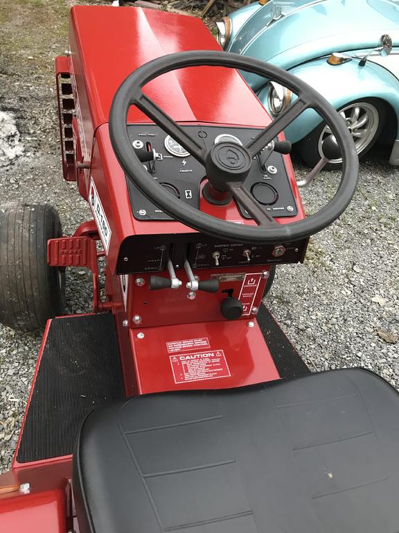

Tractorhead 9,217 #101 Posted April 10, 2020 Hey Dell, for the second instrument hole, maybe a Voltmeter will be a senseful Unit. So you will be simply able to see ahead, if the Battery Voltage is good enough to fireup. To check the Voltage if the Charging system at all works and how it performs, even the Battery loads with less current. Especially if you plan to use electric Accessories like Lights or lifters later on. In my opinion A Voltage gauges is here more helpful. 1 Share this post Link to post Share on other sites

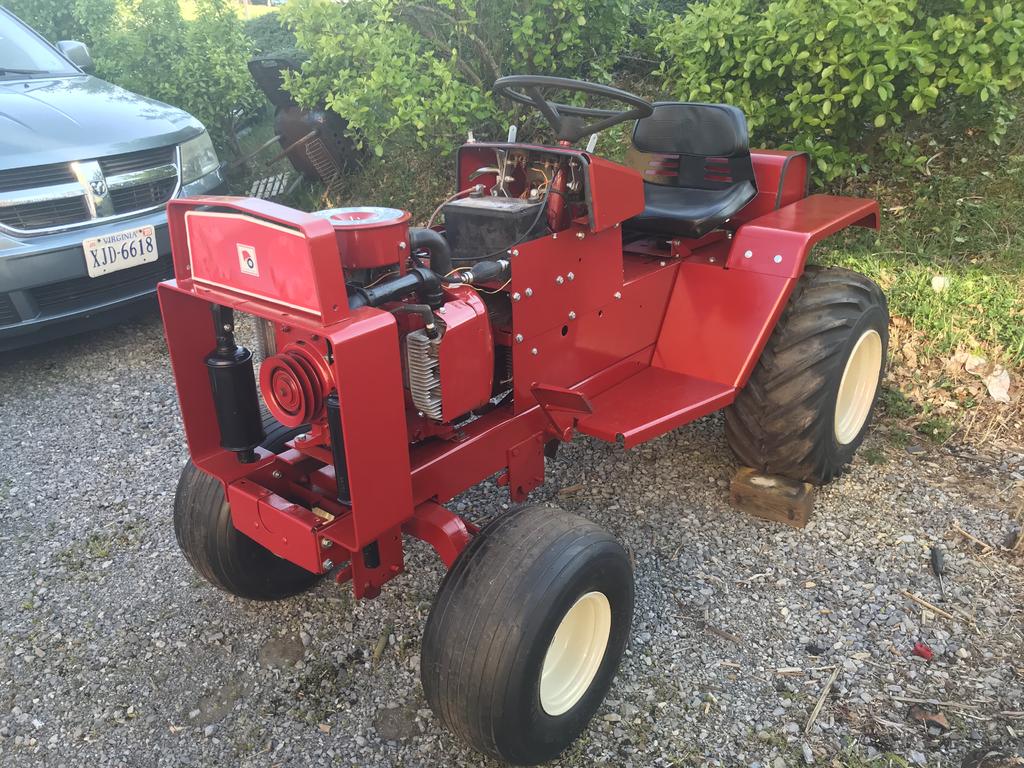

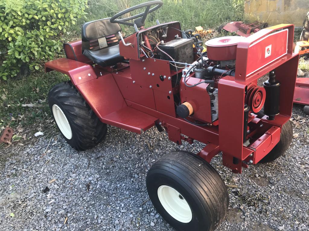

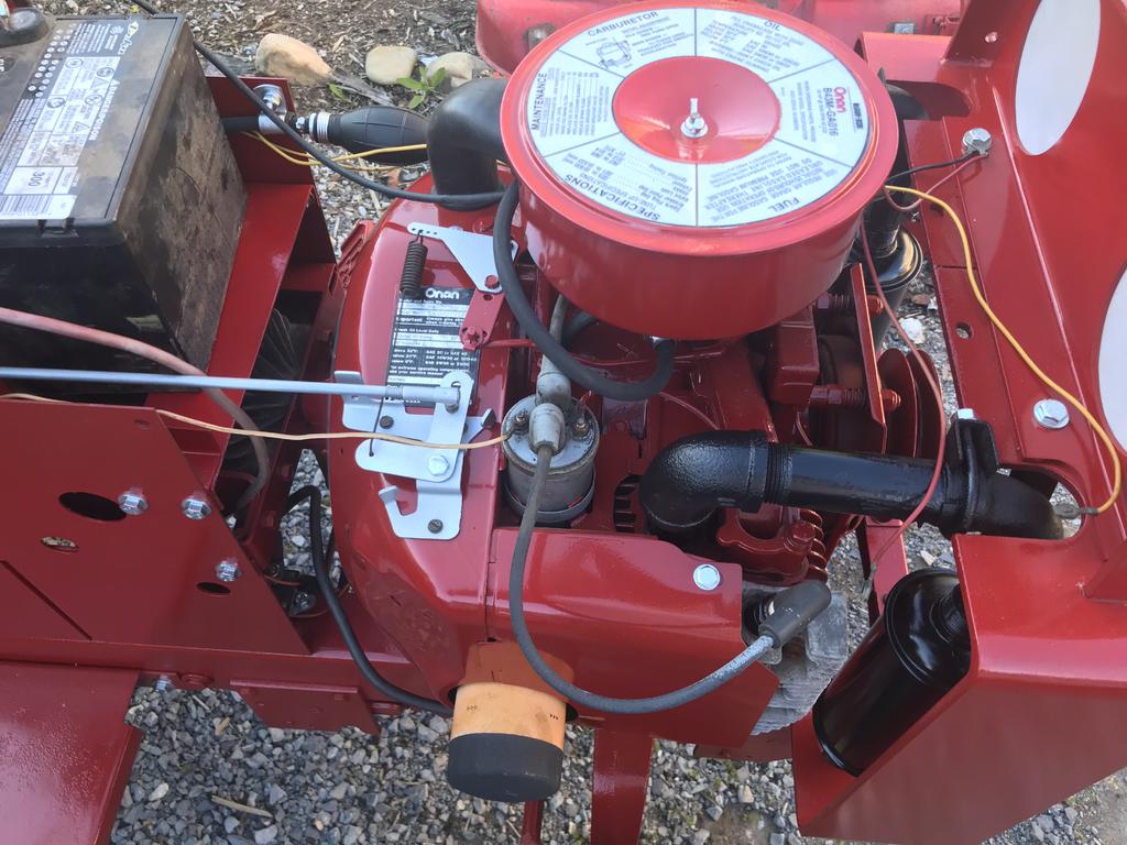

dells68 7,499 #102 Posted April 11, 2020 (edited) Becca wanted to clean out part of the basement and the easiest way to carry stuff out is through the garage, so I busted my hump to get Big Red to the point that I could roll him out and try the first startup. I’m tickled so far. On another note, the trans temp gauge is apparently shot, so I’ll have to source another gauge and sender. Edited April 11, 2020 by dells68 3 6 1 1 Share this post Link to post Share on other sites
PeacemakerJack 11,039 #103 Posted April 11, 2020 Boy—that dude both sounds and looks amazing! Thanks for the update Dells! I love the sound of those Big Twins... 1 1 Share this post Link to post Share on other sites
SylvanLakeWH 32,292 #104 Posted April 11, 2020 Looking great! 1 Share this post Link to post Share on other sites
rjg854 13,330 #105 Posted April 11, 2020 Very nice, Dells 1 Share this post Link to post Share on other sites
WHX?? 57,923 #106 Posted April 11, 2020 Looks nice Dells Don't let Squonk see that orange filter tho you might get a butt reaming. .. best paint it white and put NAPA on it 4 Share this post Link to post Share on other sites
WHNJ701 4,173 #107 Posted April 11, 2020 that thing is monster! what size are the fronts? 1 Share this post Link to post Share on other sites
Pullstart 71,160 #108 Posted April 11, 2020 Wow, looks as good as it sounds! Or sounds as good as it looks! 1 Share this post Link to post Share on other sites

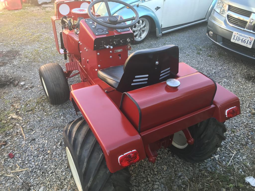

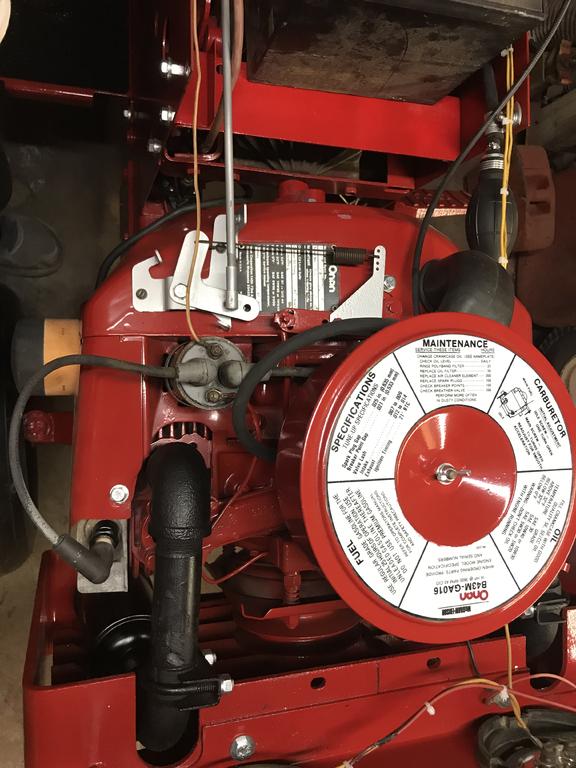

dells68 7,499 #109 Posted April 11, 2020 (edited) 1 hour ago, jabelman said: that thing is monster! what size are the fronts? They are 18x9.50-8. It’s supposed to have 16x8.50-8 on it, but I got a killer deal on these out of season at Tractor Supply a year or so ago. Got them for half price - $32 each. Figured I’d be hard pressed to find a set for that price by the time I had them shipped here. Im not an Onan guy, but I do like this one. I may have to clean the carb out again though. I have to have it setting a little rich to idle up smoothly and run good at high speed. When you idle it down, she lopes around like a Harley where the fuel is about 1/2 turn high. I figure it’s always better to have one running a little rich rather than lean. I let it sit in the driveway to run a little while and cake in the house. Becca said that thing sure is loud, I can hear it in here with the door closed! That’s with two mufflers on it!! By the way, check out that slick seat I got from @BOB ELLISON! It is perfect! Really gives it that brand new look! Edited April 11, 2020 by dells68 3 1 Share this post Link to post Share on other sites
rjg854 13,330 #110 Posted April 12, 2020 You're right about Bob's seats, they are top of line. 3 Share this post Link to post Share on other sites
953 nut 68,843 #111 Posted April 12, 2020 @BOB ELLISON put a lot of love into making the seats for our just right. 2 3 Share this post Link to post Share on other sites
WHX?? 57,923 #112 Posted April 12, 2020 Those are my favorite style of seats and is at the top of my BS list. 1 Share this post Link to post Share on other sites

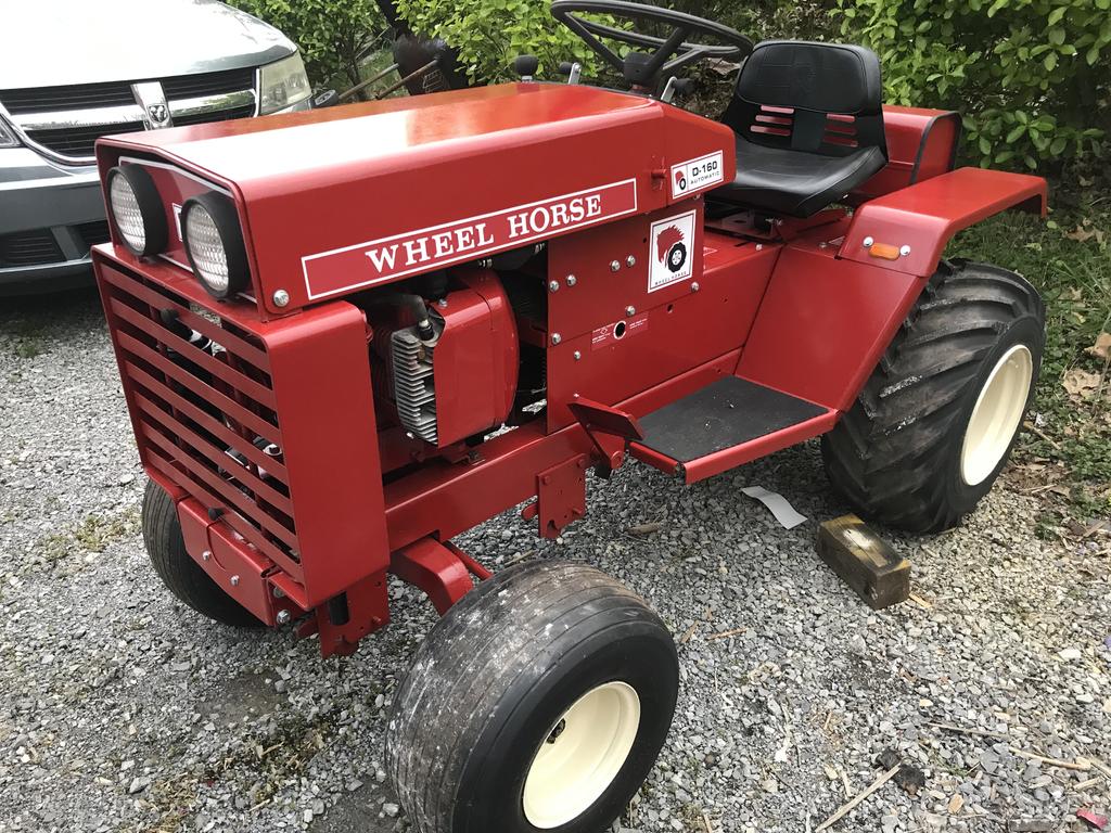

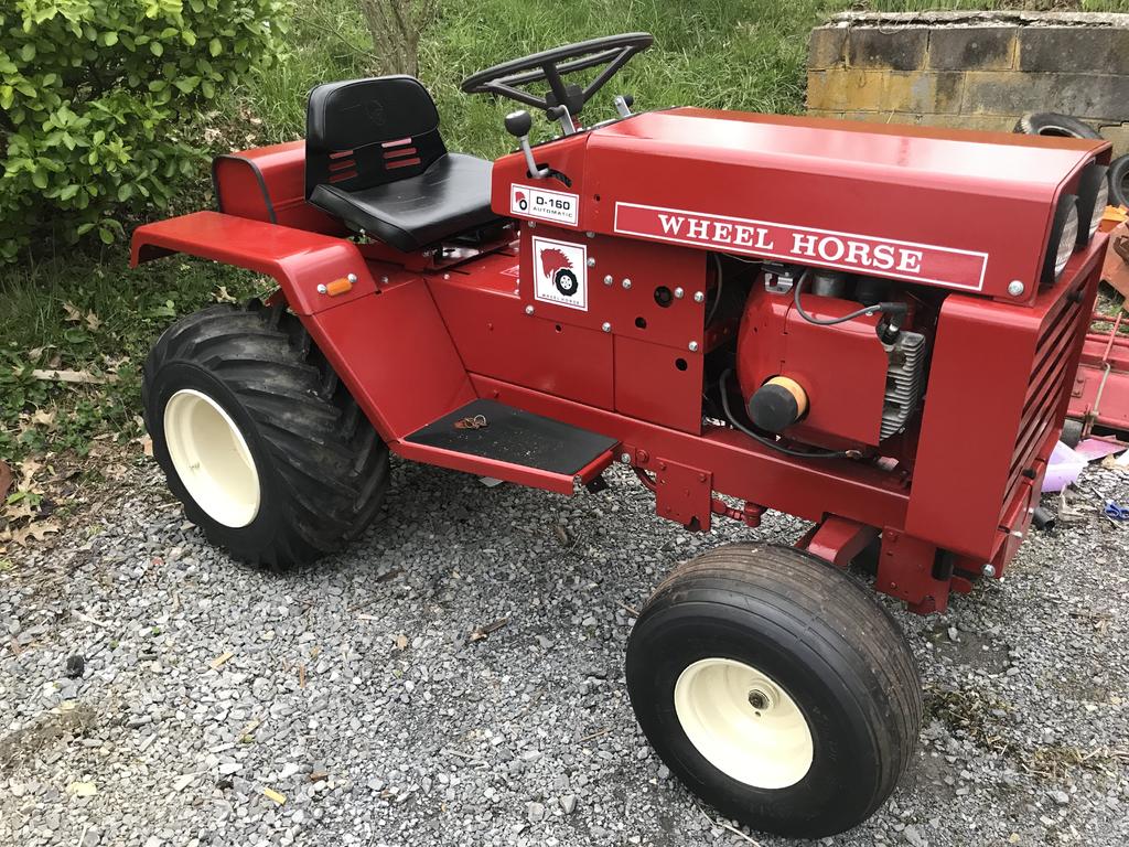

dells68 7,499 #113 Posted April 15, 2020 I finally got a chanc me to pull the ole girl out and install the decals I got from @Vinylguy. They were the perfect touch to make it look like new! The only issue with the finish on the tractor is that it had sat outside for apparently an extended time and the sheet metal has some surface pitting from rust. I cleaned it down really well, but decided not to try to fill all the pits, as I would have had to skim all services with Bondo. I think it looks honest in its current form - not trying to hide anything. Gonna take it for my Dad to see today. He’s been more excited about this one than any of my other builds! 12 1 Share this post Link to post Share on other sites
PeacemakerJack 11,039 #114 Posted April 15, 2020 Looks great Dells!Get a pic with your dad by or even on it if he will let you take his pic... What a beast of a machine! 1 Share this post Link to post Share on other sites
SylvanLakeWH 32,292 #115 Posted April 15, 2020 Beautiful job! Looks Great! 1 Share this post Link to post Share on other sites
WHX?? 57,923 #116 Posted April 15, 2020 Wow Dells ...absolutely freaking awesome... not enough thumbs!!! 6 minutes ago, dells68 said: the sheet metal has some surface pitting from rust. I actually like that in a resto. Gives it character and tells a past story. 1 1 Share this post Link to post Share on other sites
BOB ELLISON 2,983 #117 Posted April 15, 2020 That's a beast. Great job Dells. I would love to have one but I have no need for a monster like that. 1 Share this post Link to post Share on other sites
bottjernat1 2,197 #118 Posted April 15, 2020 What a beast! Beautiful wheelhorse! I soon hope to have one I have to drive 3 hrs to go get it tho. 1 Share this post Link to post Share on other sites
Pullstart 71,160 #119 Posted April 15, 2020 Looks great Dell! 1 Share this post Link to post Share on other sites

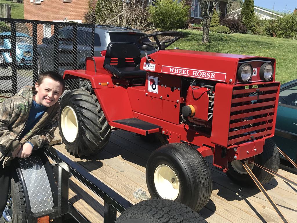

dells68 7,499 #120 Posted April 15, 2020 I got her loader up on the trailer to take to Dad’s. Of course Emory had to get into the picture! 6 4 Share this post Link to post Share on other sites

PeacemakerJack 11,039 #123 Posted April 22, 2020 You never let us know Dells, what did your dad think of the monster machine🤔? Emory sure looks pleased with it!👍🏻 1 Share this post Link to post Share on other sites
