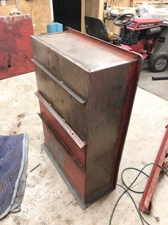

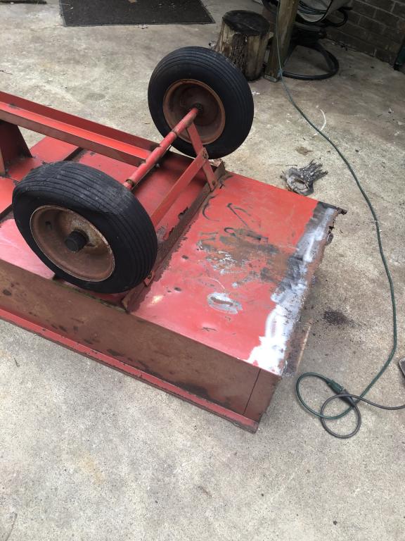

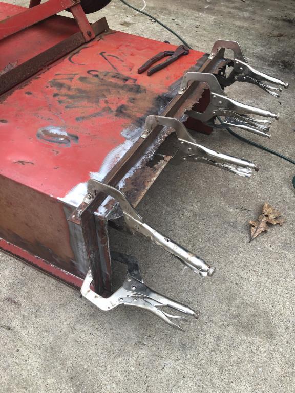

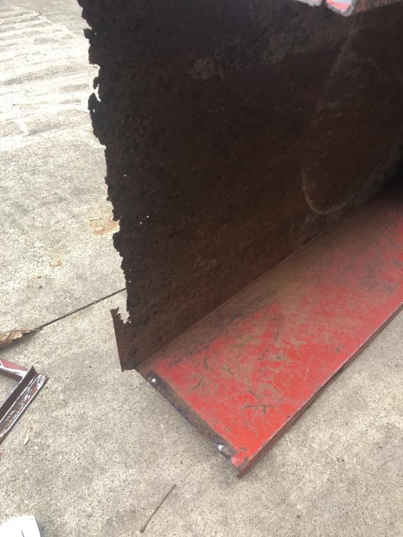

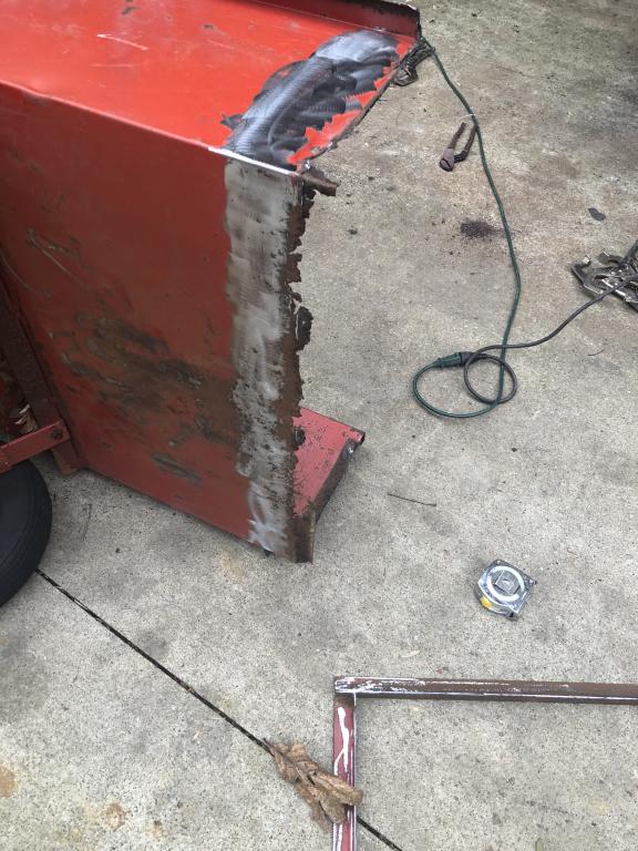

The Tuul Crib 7,340 #1 Posted January 4, 2020 Got this wagon awhile back for next to nothing. Finally got time to give it allitle attention. Most of it was pretty solid with the exception of some rot at the back. l carefully cut the angle frame off and moved it forward about two or three inches. Welded it back on and now all l have to do is put some shoes and a little paint on er and shes ready to use. Not a beautiful fix but a functional one 8 8 1 Share this post Link to post Share on other sites

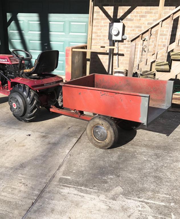

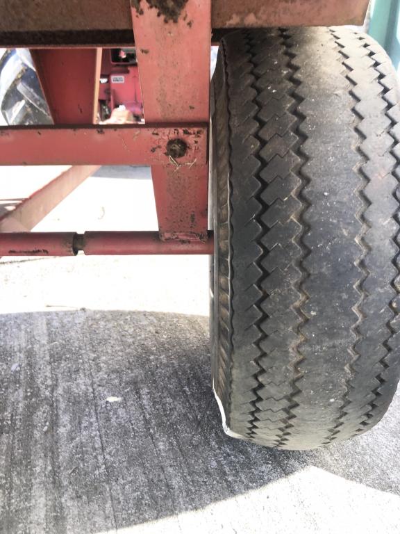

The Tuul Crib 7,340 #10 Posted January 5, 2020 Today I got some spare wheels that I found in the shed and fit them on this wagon. I had to cut some metal off of the frame underneath which made it a little close but it's not rubbing. Got this temporarily moving so I could use it right away then I will probably clean it up and paint it. Oh and l put some hubcaps on it! patina look!! 3 1 Share this post Link to post Share on other sites

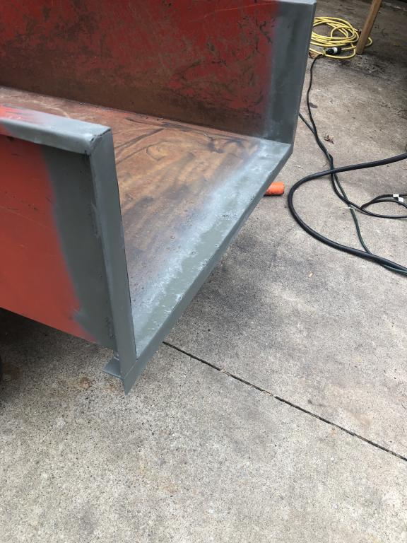

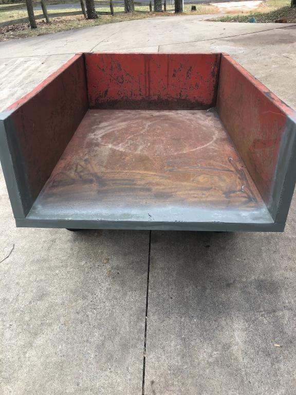

The Tuul Crib 7,340 #14 Posted January 8, 2020 Started to strip the paint this afternoon and ordered some decals from @Vinylguy and this thing should be good to go! I'm thinking about the inside of the wagon what to put on it to protect it. I'm open for suggestions. Share this post Link to post Share on other sites
ebinmaine 74,671 #15 Posted January 8, 2020 Spray on bed liner? Share this post Link to post Share on other sites
The Tuul Crib 7,340 #16 Posted January 8, 2020 I thought about that but the stuff you get in a rattle can you only get half out of the can before it dies . That can get a little expensive.Im going to use a paint sprayer and add hardener to it. Im taking it all down to bare metal. Share this post Link to post Share on other sites
WVHillbilly520H 10,376 #17 Posted January 9, 2020 Roll on bedliner? Share this post Link to post Share on other sites
The Tuul Crib 7,340 #18 Posted January 9, 2020 Roll on . Hmmm what is the source? Any info? Has to withstand shovels and things thrown at it. Share this post Link to post Share on other sites

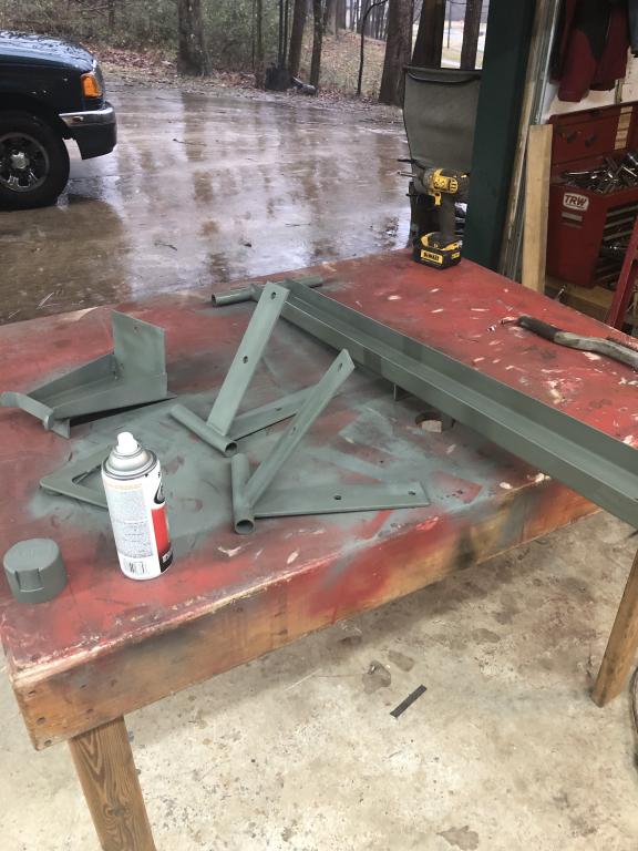

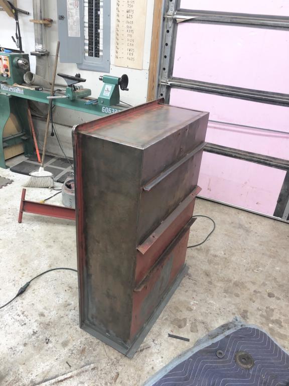

The Tuul Crib 7,340 #19 Posted January 12, 2020 Did some cleaning today on the parts hit them with some etching primer and will eventually paint. Planning on using a spraygun and adding some Hardner to it. This one needs to be a little durable! 2 Share this post Link to post Share on other sites

C_hasbeen 249 #21 Posted January 12, 2020 Nice job! You have a small fortune in vicegrips there! 1 Share this post Link to post Share on other sites
