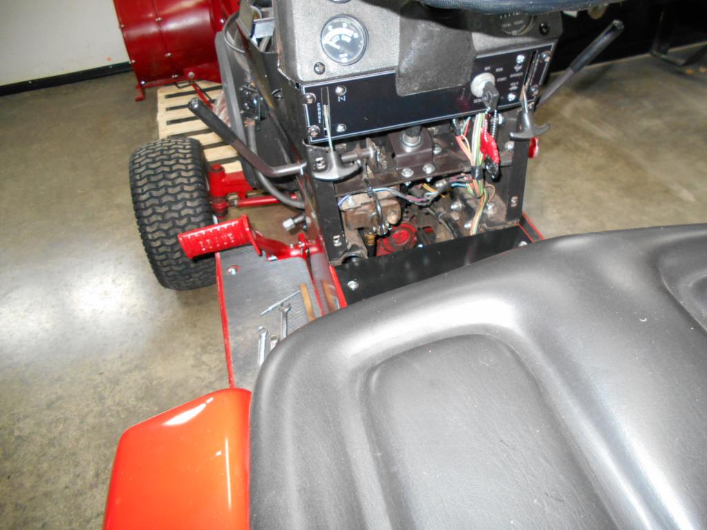

cleat 9,405 #4 Posted January 4, 2020 That would be the simplest. You can swap the front axle and steering quite easily if desired. An upgrade you can do to either steering system in the early tractors is to drill out the support plate and install a flanged ball bearing (same as the front wheels on a lot of Wheel Horse tractors). This makes the steering much smoother and easier and also gets rid of a lot of the steering shaft movement (except rotational play, that is another issue). Just pick the best parts and you can build a great machine. If you can build a tractor with all the leftover parts you can sell it to recoup some money or keep it as a spare (just be careful as you may end up like me and end up with a lot of rebuilt 520's and a very patient wife). I personally prefer the early 520's and do not like either motion control but put on Matt's foot control (i have 2 more on order so every tractor I own will be foot control soon). Share this post Link to post Share on other sites
Ed Kennell 47,809 #5 Posted January 4, 2020 I also have foot control(my own design) on all my hydros. Share this post Link to post Share on other sites

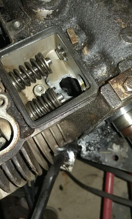

1990Onan520-H 15 #7 Posted January 4, 2020 Just for fun, here's the vent my 90 put in her block at 850 hours on the clock. Believe it or not the thing still ran with no noises on the front cylinder. I'm guessing someone didn't change oil. I picked it up blown hoping it was a simple fix based on how it ran... Not so much. Share this post Link to post Share on other sites
