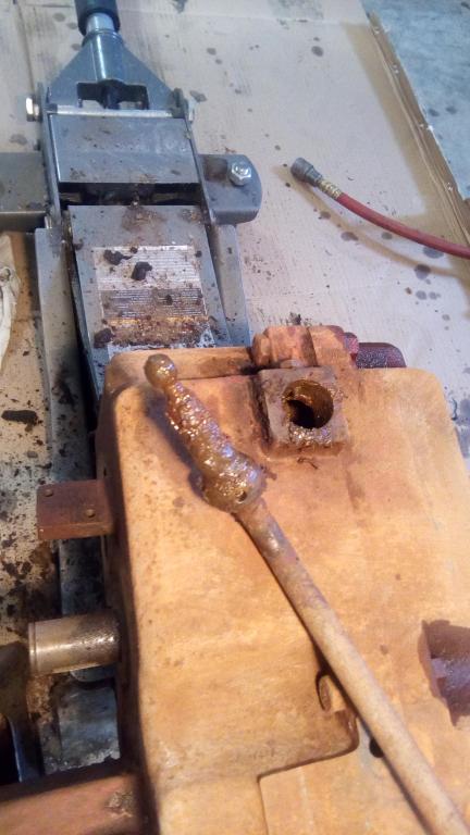

C_hasbeen 249 #27 Posted January 4, 2020 12 hours ago, WHX24 said: Try drilling a small hole in the middle of the case to try and get some lube down in there. You will not be able to split the cases with the pin in. Some guys report using an air hammer on it works. I always try and get the tranny piece loose before I saw as I know then it will hammer out. Slot hitch remains come out in the press then. I have yet to try and put the whole tranny to a press but have no doubt it will someday come to that. See @953 nut s right of passage above. I was lucky the hitch piece you have in your picture I was able to get that free enough to remove the sawn off pin ends. I did think about drilling a hole like you just suggested I had to do that on an old horse trailer latch years ago. I am glad you mentioned that I think I will give that a go I hate the idea of trying to support everything and maneuver the entire trans-axle into position. Share this post Link to post Share on other sites
C_hasbeen 249 #28 Posted January 4, 2020 I wish I had thought of this before I cut my hitch pin off I wonder what would have happened if I had welded a big nut to the end of the pin and used an impact wrench to rock it back and forth to maybe get some movement on it? maybe? who knows unless i get one more tractor? oh no now it has started hasn't it? already planning the next adventure 1 1 Share this post Link to post Share on other sites

WHX?? 57,655 #30 Posted January 4, 2020 3 hours ago, C_hasbeen said: support everything and maneuver the entire trans-axle into position. Yes that would not be fun at all but is possible to do with the help of some buds, 1 Share this post Link to post Share on other sites
Stormin 9,988 #31 Posted January 4, 2020 'Ow do from and . Those hitch pins can be stubborn. I've drilled a couple out. Beggar to do when still in situ, but can be do if your careful. 1 Share this post Link to post Share on other sites

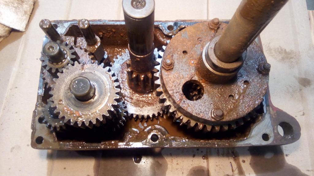

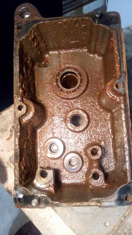

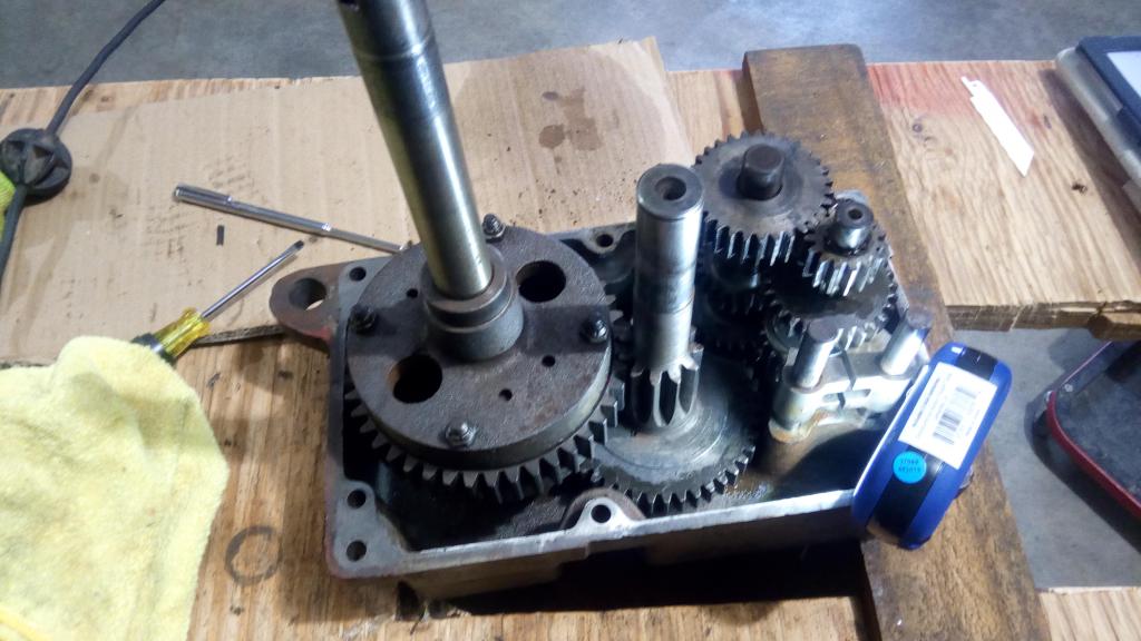

C_hasbeen 249 #32 Posted January 4, 2020 Old slow poke here finally got the hitch pin out, wound up drilling through it and finishing it off with a chisel to get the thin remains on the shaft out. Opened the case and am not to disappoint at this time with what I see. But I am on my union break so tomorrow get it cleaned up and see how good it really is. Sure is such a satisfying sound when you crack open a cast iron case! 5 Share this post Link to post Share on other sites
ebinmaine 80,137 #33 Posted January 4, 2020 Aye! She's a bit sludgy but it'll clean up fine with some K1 or diesel or whatever... Good progress! Share this post Link to post Share on other sites
C_hasbeen 249 #34 Posted January 4, 2020 13 minutes ago, Stormin said: 'Ow do from and . Those hitch pins can be stubborn. I've drilled a couple out. Beggar to do when still in situ, but can be do if your careful. Yea I wound up doing the drill and right Al the very end I broke a $20 bit also! Dang it! 2 Share this post Link to post Share on other sites
C_hasbeen 249 #35 Posted January 4, 2020 2 minutes ago, ebinmaine said: Aye! She's a bit sludgy but it'll clean up fine with some K1 or diesel or whatever... Good progress! Yea diesel to the rescue here for sure 1 Share this post Link to post Share on other sites

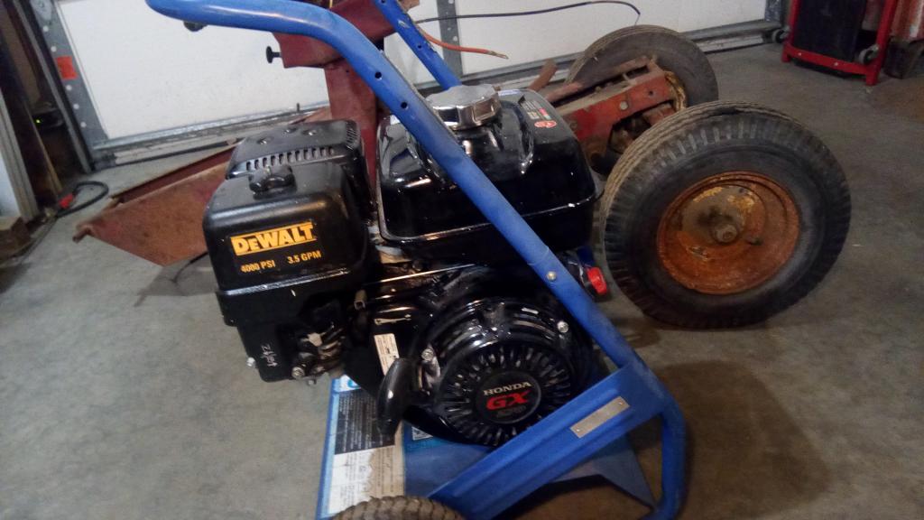

C_hasbeen 249 #37 Posted January 5, 2020 Well a Craigslist deal to good to pass up provided an almost new Honda 9 horse gx270 engine from a pressure washer that got frozen recoil start, will need to paint the tank and tin red but it will work for now! 4 hours ago, ebinmaine said: Aye! She's a bit sludgy but it'll clean up fine with some K1 or diesel or whatever... Good progress! Yea diesel to the rescue here for sure Share this post Link to post Share on other sites

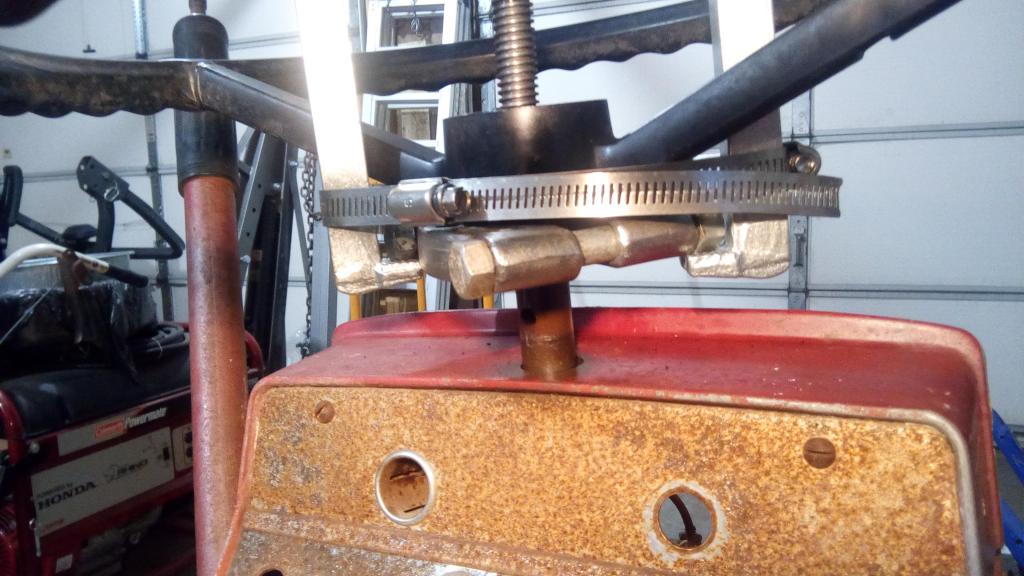

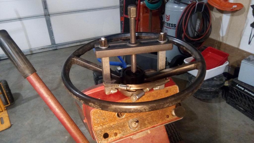

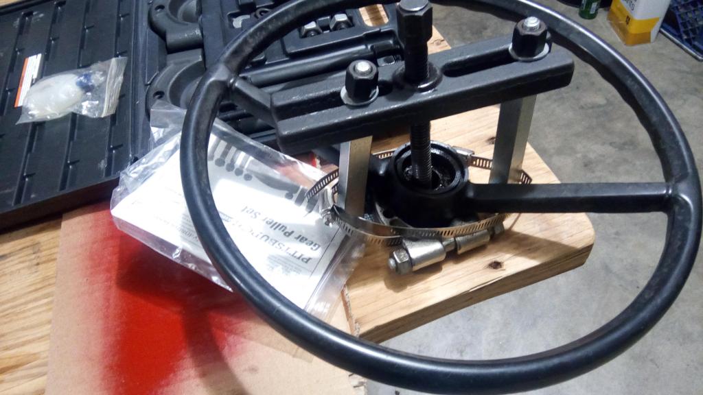

C_hasbeen 249 #38 Posted January 12, 2020 Well I thought I posted an update but aparantly I did not save it! Anyway I got my parts for the transmission all bearings, a gasket and the 2 ND 3 Rd gear, I pu it all back together, I also pulled off my steering wheel. I used a bearing splitter and a two leg gear puller and a hose clamp to hold the legs inplace on the splitter bolts. Took some doing but got it off. 3 1 Share this post Link to post Share on other sites
C_hasbeen 249 #39 Posted January 12, 2020 My bearings and the second third gear car in the mail yesterday so today I rebuilt the transmission then pulls the steering wheel so I can disassemble the rest of the tractor to clean it up and fix any other issues I find. To pull the wheel I used a small bearing splitter and a harbor freight two left puller with a hose clamp at the bottom to keep things in line till I got pressure on it. I had sprayed it with penetrator oil a couple times over the past week. Once o got pressure on it and tapped on the big bolt I finally got it to move and come off. 1. Got hubs off the axles, Check that box 2. Hitch pin removed to split transmission. Check that box. 3. Pull steering wheel. Check that box. 4 1 Share this post Link to post Share on other sites
ZXT 2,402 #40 Posted January 12, 2020 Excellent! That Honda will work well. They're good engines. Congrats on getting the wheel off in one piece! Share this post Link to post Share on other sites

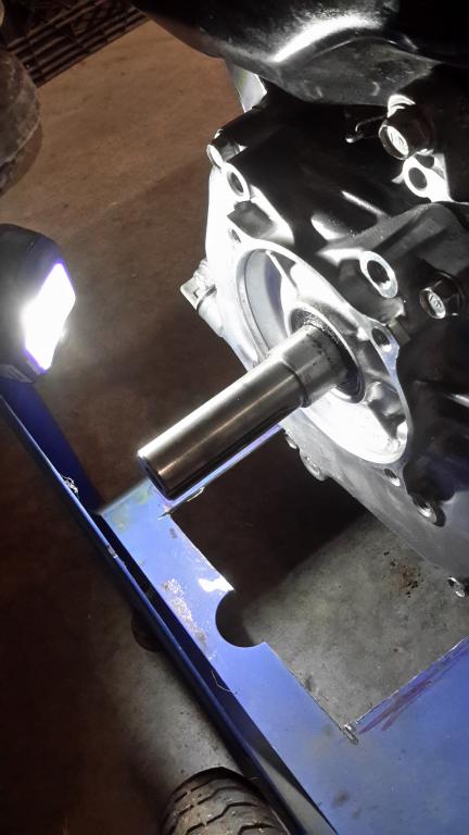

oliver2-44 11,663 #41 Posted January 12, 2020 I'' be interested to see if that Honda pressure washer engine has a straight shaft, I had a mid-90's pressure washer and when the pump died I pulled the good engine only to find it had a tapered shaft. Hope you have better luck than me! Share this post Link to post Share on other sites
ZXT 2,402 #42 Posted January 12, 2020 1 minute ago, oliver2-44 said: I'' be interested to see if that Honda pressure washer engine has a straight shaft, I had a mid-90's pressure washer and when the pump died I pulled the good engine only to find it had a tapered shaft. Hope you have better luck than me! If it is tapered, could a tapered shaft adapter be used? Share this post Link to post Share on other sites
C_hasbeen 249 #43 Posted January 12, 2020 1 hour ago, oliver2-44 said: I'' be interested to see if that Honda pressure washer engine has a straight shaft, I had a mid-90's pressure washer and when the pump died I pulled the good engine only to find it had a tapered shaft. Hope you have better luck than me! I had to go look again but it is a 1 inch shaft as far as I can tell, it does have a thicker part right next to the block. 1 Share this post Link to post Share on other sites
ZXT 2,402 #44 Posted January 12, 2020 1 minute ago, C_hasbeen said: I had to go look again but it is a 1 inch shaft as far as I can tell, it does have a thicker part right next to the block. You could check it with a set of calipers, but it certainly doesn't look tapered to me. Probably has 1 1/8" close to the block and 1" for the rest. Share this post Link to post Share on other sites
C_hasbeen 249 #45 Posted January 12, 2020 1 inch shaft and you are correct 1 1/8 on the stepped up part. I just dug out my calipers. 2 Share this post Link to post Share on other sites
oliver2-44 11,663 #46 Posted January 12, 2020 That looks like a good straight shaft. Your knowledge and luck is better than mine. 1 Share this post Link to post Share on other sites
