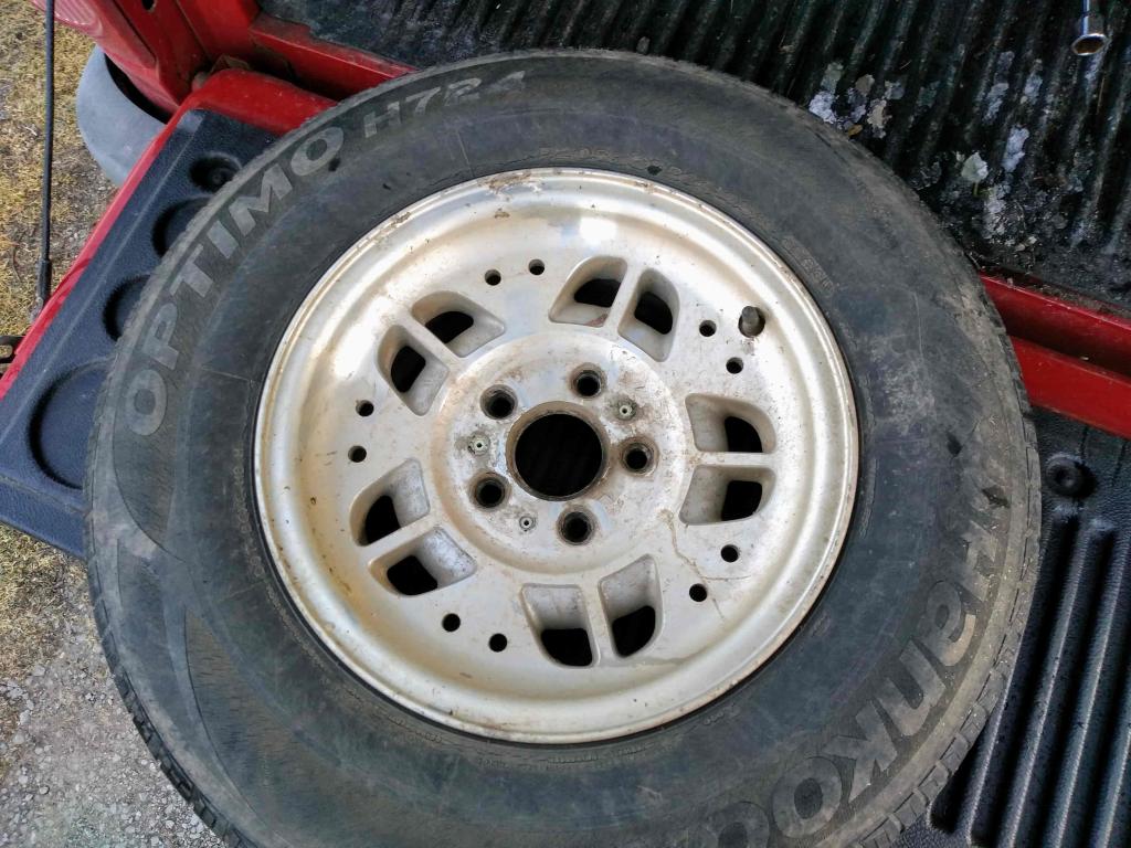

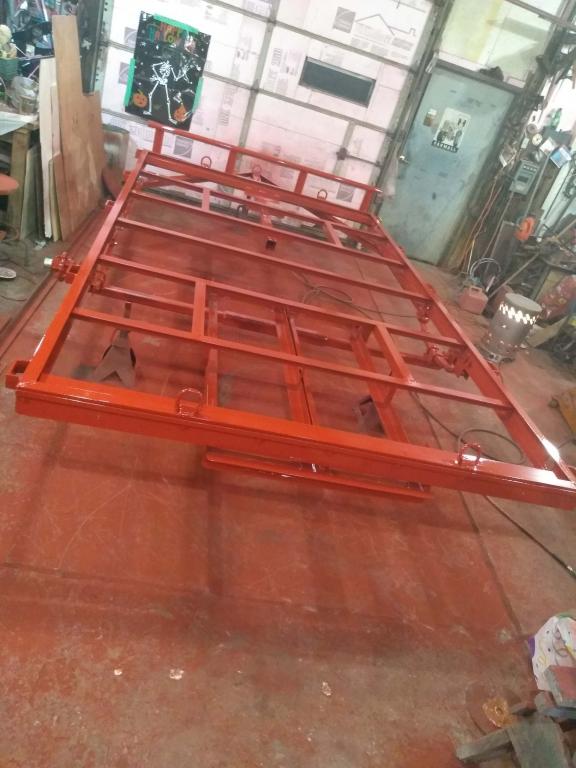

Achto 32,864 #64 Posted January 11, 2020 (edited) Today I managed to put a fresh coat of red paint on the garage floor and accidentally got some on my trailer frame. I picked up a set of rims from a Ford Ranger that I'm going to use for my trailer. The factory clear coat has pealed off in quite a few spots leaving the aluminum oxidized pretty bad. I'm considering sanding them down and painting them. Unless any body knows of a good way to get them back to their original state. Edited January 11, 2020 by Achto 4 2 1 Share this post Link to post Share on other sites
MikMacMike 494 #65 Posted January 11, 2020 22 minutes ago, Achto said: Today I managed to put a fresh coat of red paint on the garage floor and accidentally got some on my trailer frame. I picked up a set of rims from a Ford Ranger that I'm going to use for my trailer. The factory clear coat has pealed off in quite a few spots leaving the aluminum oxidized pretty bad. I'm considering sanding them down and painting them. Unless any body knows of a good way to get them back to their original state. Hmmmmmmm now that is top sheilf brodeir......heheheheh and red tooo, I havnt been around much to see progress but I can surly tell no grass growes under your feet. 1 Share this post Link to post Share on other sites
ebinmaine 81,003 #66 Posted January 11, 2020 @Achto That clear may be on bad shape but it can be tough to remove. They rreeaallyy should be blasted with beads or nut shells. Once that's done use a small buffing wheel or VERY carefully touch the outside surface with a soft wire brush like I do on carbs. Then clear coat. That trailer frame looks absolutely stellar!!! 1 Share this post Link to post Share on other sites

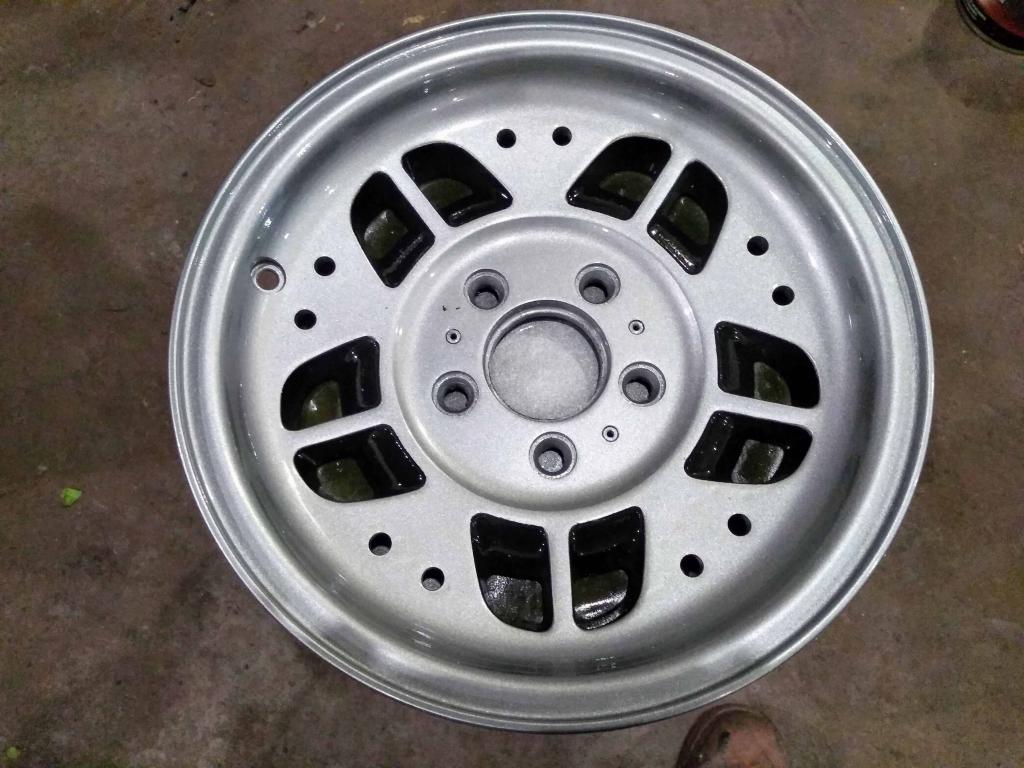

Achto 32,864 #67 Posted January 12, 2020 I made an attempt to try and polish the rims today. The results that I was getting for the time that I had invested were less than satisfactory. So.. on to plan B. 80 grit sand paper and a DA sander made short work of the clear coat that was on the rims. Then a couple of coats of self etching prime, some black paint to high light the "deer track" looking recesses, Silver base coat followed by 4 coats of clear. Not the bling that polished aluminum would bring but I'm happy with the out come. The plan for tomorrow is to throw the old wheels on and move it out side and then get the fenders and ramps adorned with some red paint. Then unfortunately it's back to the salt mines on Monday so there will be no progress until next weekend. I will how ever, get the new tires mounted on the rims some time during the week. 6 3 Share this post Link to post Share on other sites
19richie66 17,937 #68 Posted January 12, 2020 Looking great Dan. 1 Share this post Link to post Share on other sites
rjg854 13,406 #69 Posted January 12, 2020 Ever since I had my 94 Ranger, I've liked that style of rim. I even transfer them over to the 08 Ranger because I liked them more. Good looking job on them. Share this post Link to post Share on other sites
Pullstart 71,466 #70 Posted January 12, 2020 Deer print... on a Horse trailer... 1 2 Share this post Link to post Share on other sites

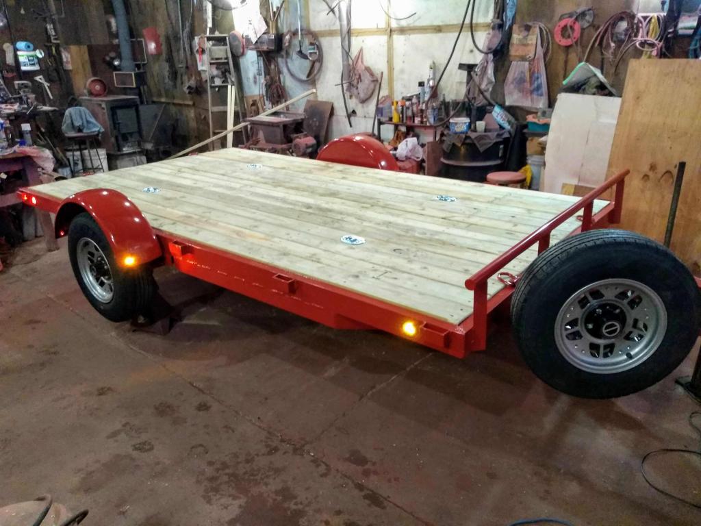

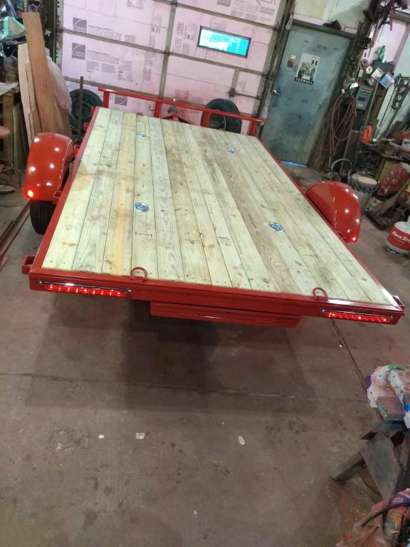

Achto 32,864 #71 Posted January 20, 2020 (edited) I was able to get the tires mounted during the week. Yesterday was spent on wiring. Because connectors and water do not get along for long, not one connector or terminal was used to wire the trailer lights. All connections are soldiered and shrink wrapped, then covered with loom. Today consisted of a little wood working, nothing fancy other than a little router work to make depressions for the recessed tie downs. One thing that had concerned me with this build was staying with in DOT laws on width. I knew that it was going to be close after I put the fenders on. Either my figures were accurate or I got lucky because I came in 1" under maximum width . With this project done now I can get back to some Horse play. Here are some pics of the final product. Nothing left to do on the trailer now except for get a few scratches in it so that I'm not afraid to use it. Edited January 20, 2020 by Achto 9 1 Share this post Link to post Share on other sites
ebinmaine 81,003 #72 Posted January 20, 2020 Beautiful !!! 1 Share this post Link to post Share on other sites
Mikey the Monkey 701 #73 Posted January 20, 2020 Rapferd's gonna love it! 1 1 Share this post Link to post Share on other sites
WHX?? 58,308 #74 Posted January 20, 2020 Wow! Looks a lot bigger than the old one but I know it ain't by much. Almost looks like it should have two axles must be the pic! Gotta love them running lights on the fenders and sure are glad you went with the stopper, looks like it belongs there! 13 hours ago, Achto said: not one connector Crap and I got a boat load of these for ya... Might as put them in the trash where they belong! 1 Share this post Link to post Share on other sites
19richie66 17,937 #75 Posted January 20, 2020 That’s the first thing I throw out from a trailerlight kit 3 Share this post Link to post Share on other sites
