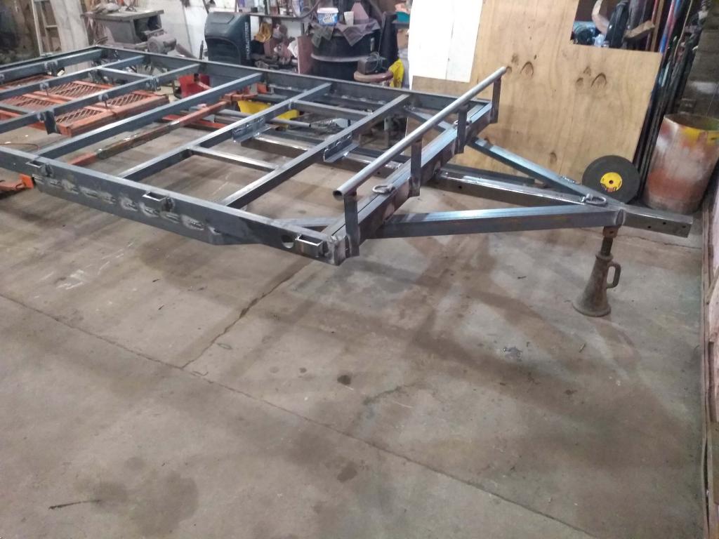

WHX?? 58,308 #29 Posted January 6, 2020 (edited) So he asked and I helped....and enjoyed it. Back in the day when I worked in shipyards welders didn't do any grinding. Not allowed by union rules so every welder had to have a sidekick who did the grinding ... guess what I was today! Had a productive day tho and got her up on axle. Looking to be a very nice horse hauler! Didn't get a pic of the "horse stopper" on the front Dan sorry. ..any body wants to get him something for his birthday, Xmas , father's day .. a welders apron would be appropriate. .. more than once a caught him to be a flaming... The orangish racks in the back are a nifty slide storage for loading ramps that was repurposed off the old trailer with a hinged door to trap then in during transit.The ramps hook in the back channel for moving wher needed. Tractors will be easily be able to be loaded. Edited January 6, 2020 by WHX24 6 Share this post Link to post Share on other sites

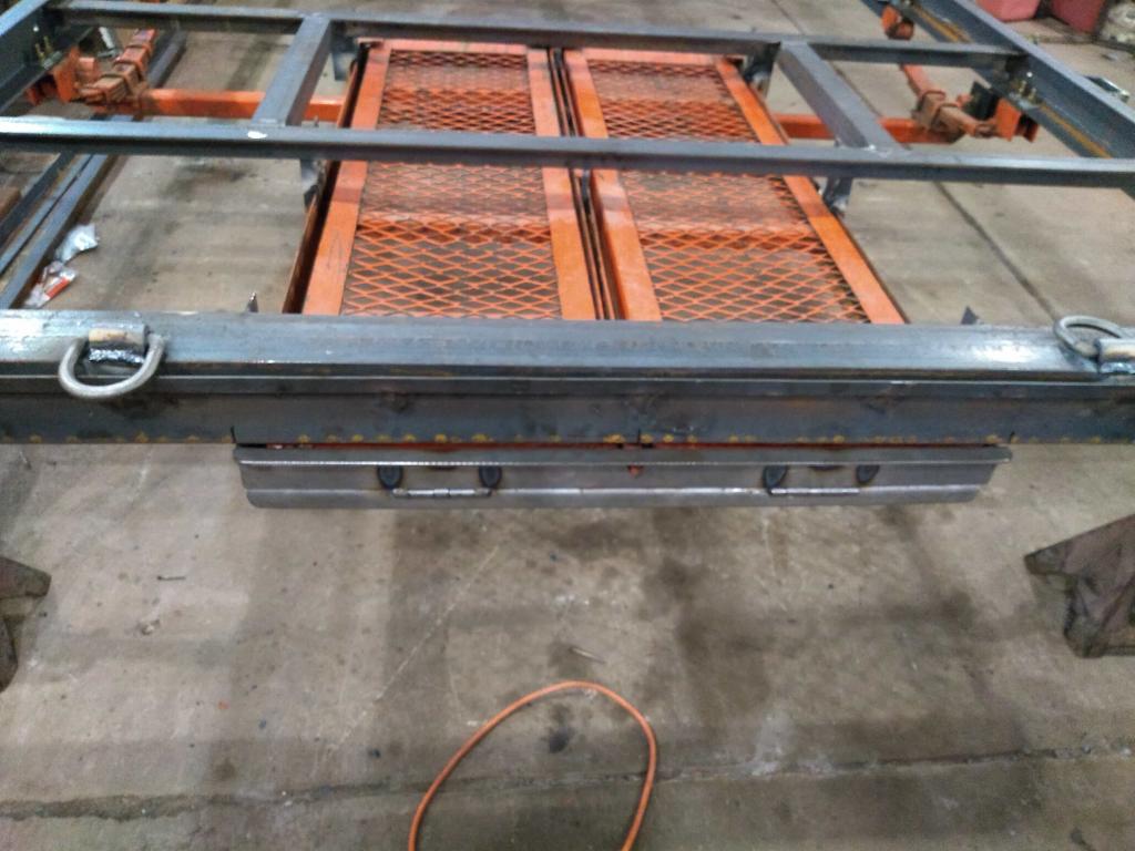

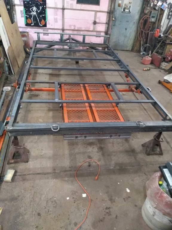

Achto 32,864 #30 Posted January 6, 2020 (edited) A little over 600lbs of steel, 15lbs of 6013 welding rod, a huge, HUGE, HUGE, THANK YOU to Jim @WHX24 for his help today and the metal work is finally done on my new trailer. Here is the best pic that I could get from the back. Jim pointed out the drawer for the ramps. I don't like ramp gates on a trailer, most feel like pulling a parachute down the road to me. So when I built the orange trailer 15yrs a go I made a drawer to hold the ramps under the trailer. I was able to salvage this drawer from the old trailer and install it on the new trailer. When I made it the last time the door was made from what ever I had laying around and it was effective but not real pretty. This time I made the door out of new metal for better ascetics. After Jim left I also added some tie downs, can't have too many of those . I discussed adding a head ache bar to the front or as Jim called it a Horse stopper. After a very short discussion we both decided it would be a good idea. So we dug around to find some pipe and then while I was burning some metal together Jim set to work prepping the parts to make it. I think it turned out great and it is a good safety feature. This pic also shows the hitch set up. Nothing left to do now but throw some paint at it, do some wiring, and put the deck on. Unfortunately I have to go back to work tomorrow so progress will come to a halt until next weekend . I will post more pics when there is some thing to show. Edited January 6, 2020 by Achto 3 7 1 Share this post Link to post Share on other sites

8ntruck 9,356 #34 Posted January 6, 2020 Nice looking work. You might want to go over the welds where you stretched the axle with a needle de-scaler. That will peen the metal, which will reduce the residual stresses caused by the welds. This reduces the chances that a fatigue crack would start at the welds in the middle of the axle. 1 1 Share this post Link to post Share on other sites

Lane Ranger 12,153 #37 Posted January 6, 2020 12 hours ago, Achto said: A little over 600lbs of steel, 15lbs of 6013 welding rod, a huge, HUGE, HUGE, THANK YOU to Jim @WHX24 for his help today and the metal work is finally done on my new trailer. Here is the best pic that I could get from the back. Jim pointed out the drawer for the ramps. I don't like ramp gates on a trailer, most feel like pulling a parachute down the road to me. So when I built the orange trailer 15yrs a go I made a drawer to hold the ramps under the trailer. I was able to salvage this drawer from the old trailer and install it on the new trailer. When I made it the last time the door was made from what ever I had laying around and it was effective but not real pretty. This time I made the door out of new metal for better ascetics. After Jim left I also added some tie downs, can't have too many of those . I discussed adding a head ache bar to the front or as Jim called it a Horse stopper. After a very short discussion we both decided it would be a good idea. So we dug around to find some pipe and then while I was burning some metal together Jim set to work prepping the parts to make it. I think it turned out great and it is a good safety feature. This pic also shows the hitch set up. Nothing left to do now but throw some paint at it, do some wiring, and put the deck on. Unfortunately I have to go back to work tomorrow so progress will come to a halt until next weekend . I will post more pics when there is some thing to show. Extra heavy duty frame ! I like all the tie down locations! 1 Share this post Link to post Share on other sites
Achto 32,864 #38 Posted January 6, 2020 32 minutes ago, Lane Ranger said: I like all the tie down locations! Thanks Lane. There will also be some pocket tie downs in the middle of the bed. The white arrows show the extra cross pieces I added so there would be something solid to bolt them to. I like to have a lot of tie down options. 3 Share this post Link to post Share on other sites
Lane Ranger 12,153 #39 Posted January 6, 2020 (edited) Dan, looks like you can at least get four good sized tractors tied down and maybe more! Save a place for a spare tire hanger setup too. I have an aluminum trailer and had to get a bolt on one for a spare but taking it to Florida last year I figured I needed the insurance! Edited January 6, 2020 by Lane Ranger 1 Share this post Link to post Share on other sites
