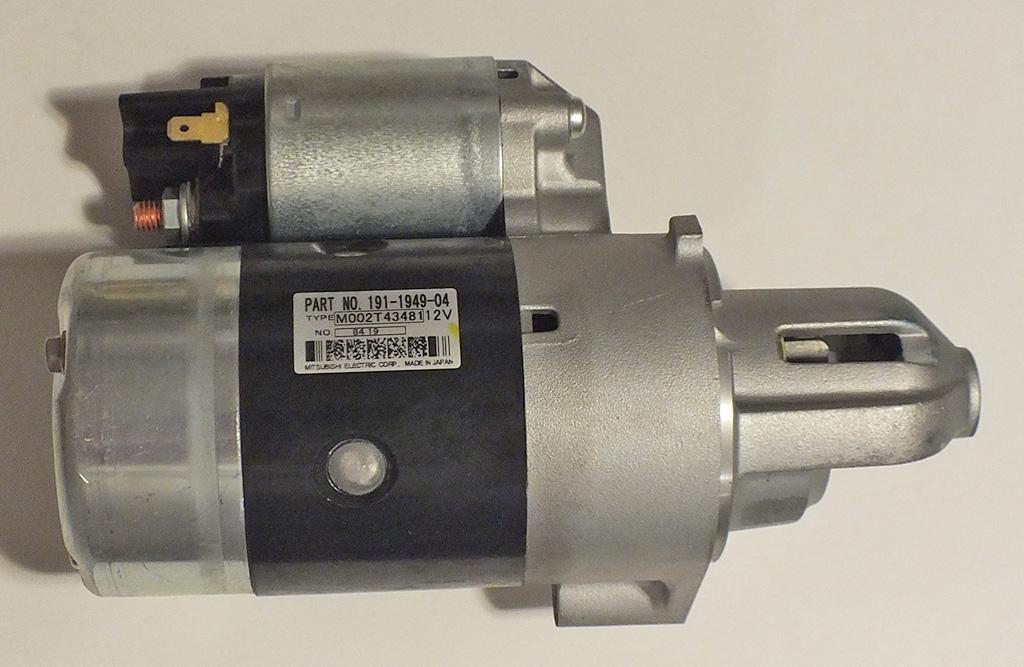

lynnmor 9,073 #1 Posted December 31, 2019 I needed to replace a starter on a P220G and didn't want to buy a Chinese one, so I ordered a Toro 112- 7023. I believe that was a mistake because it looks just like the cheap eBay junk but costs three times as much. It has a label warning against striking the starter probably because it has no screws holding the fields in place. There is no country of origin stamped on it and came in a Toro box. The original starter was made by Mitsubishi in Japan and was a quality piece. My suggestion is to buy parts to fix the original, buy a used one or just buy the cheap one online. Mine could not be rebuilt because of a severely worn commutator. Share this post Link to post Share on other sites

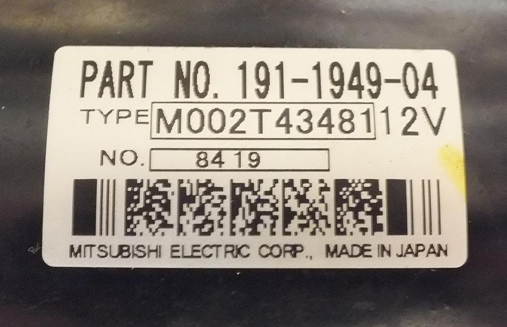

onanparts.com 185 #4 Posted January 2, 2020 On 12/31/2019 at 8:08 AM, lynnmor said: I needed to replace a starter on a P220G and didn't want to buy a Chinese one, so I ordered a Toro 112- 7023. I believe that was a mistake because it looks just like the cheap eBay junk but costs three times as much. It has a label warning against striking the starter probably because it has no screws holding the fields in place. There is no country of origin stamped on it and came in a Toro box. The original starter was made by Mitsubishi in Japan and was a quality piece. My suggestion is to buy parts to fix the original, buy a used one or just buy the cheap one online. Mine could not be rebuilt because of a severely worn commutator. Or you could replace it with a starter identical to the OEM Mitsubishi, as in an OEM Mitsibishi Made in Japan starter....Onan part # is 191-1949-04. That's all we keep on hand and they come directly to us from Cummins/Onan. Not cheap, but should last another 25-30+ years...unlike the toy starters from China..... Share this post Link to post Share on other sites
lynnmor 9,073 #5 Posted January 2, 2020 4 hours ago, onanparts.com said: Or you could replace it with a starter identical to the OEM Mitsubishi, as in an OEM Mitsibishi Made in Japan starter....Onan part # is 191-1949-04. That's all we keep on hand and they come directly to us from Cummins/Onan. Not cheap, but should last another 25-30+ years...unlike the toy starters from China..... That's what I thought I was buying since I ordered an OEM part. Apparently there is a shell game going on with Toro. It is good to know that the Mitsibishi starters are still available, I might just return the brand X since it is still in the box. Share this post Link to post Share on other sites
onanparts.com 185 #6 Posted January 2, 2020 6 hours ago, lynnmor said: That's what I thought I was buying since I ordered an OEM part. Apparently there is a shell game going on with Toro. It is good to know that the Mitsibishi starters are still available, I might just return the brand X since it is still in the box. Shell game, exactly! :( It was for a time easy to tell the difference based on the cost. Well under $100.00 = cheap Chinese import. But now as you have discovered, the junk is also being marked way up and branded OEM. And showing up everywhere. This includes many other cheap/junk aftermarket Onan replacement parts. Gaskets, seals, carbs, ignition coils etc. Mostly on epay, but showing up on many resellers shelves too. Not much of an aftermarket existed for Onan parts until just the last few years. The reality is most of it is pure junk...... Share this post Link to post Share on other sites

lynnmor 9,073 #10 Posted August 9, 2022 1 hour ago, longbikez said: I typed in 191-1949-04 on the cummins parts and got no results, has there been a supersession? That is the number on the original Mitsubishi starter. Find a used one on an auction site or get yours rebuilt, the Chinese ones are poor and possibly not even useable. The -04 at the end of the number is the position of the solenoid. Share this post Link to post Share on other sites
