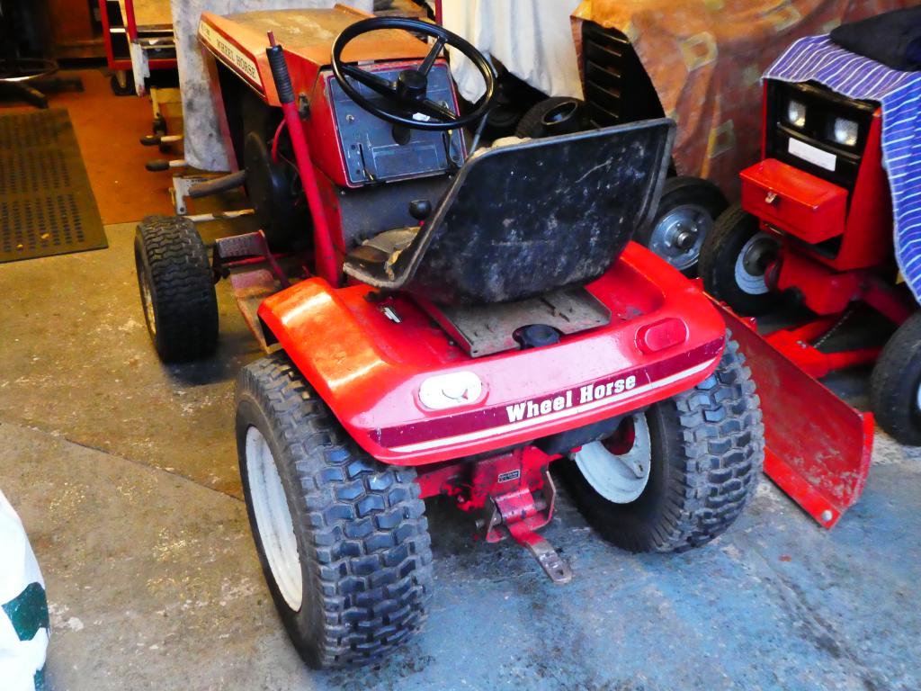

Stormin 9,988 #1 Posted December 30, 2019 A mate of mine and myself picked up this C-125 a month or so ago. Unused for around two years and stored in a shed. A none runner and in need of some TLC. It'll not be a restoration. Yesterday it arrived at my workshop to sort out. Started on it this morning and I'll up date as progress is made. Mainly a case of fixing any issues and a general tidy up. It's to be a worker on the property he and his Good Lady have acquired, over the border in Scotland. Quote Edit 3 9 1 Share this post Link to post Share on other sites
peter lena 10,103 #2 Posted December 30, 2019 stormin, agree with the view as a worker, rather typical neglect and abuse , obviously a better seat pan, metal, not plastic, and a new seat, easy swap , and while you are there , basic electric wiring check and verify operation . i isolate every step of wiring , often easily find the issue , rather than combining it , adding to the frustration . all lubrication changes and greasing , lubing choke and throttle cables for easy use. looks like rear axle oil seals , probably a shift boot,.sea-foam gas treatment , along with a tune up, you obviously , know what needs to be done. your mate is lucky to have you involved , let us know how you are doing , good luck , pete Share this post Link to post Share on other sites
Stormin 9,988 #3 Posted December 30, 2019 Oh there's a list, Pete. It now runs after a points clean up and setting. And sweetly after a warm up and carb adjustment. Carb seems to be a plastic one. Works OK though. May need a new HT lead. Doesn't look to good. Drove it in and out of the workshop ok after blowing the tyres up. Doing that let me know the rears are water ballasted. Wee'd on the floor. I also think the brake needs attention. Stops dead when you depress the clutch. You can push it about easily though. Another steering wheel is on the cards. It has a 'eck of a wobble. The steel insert in it is very loose. The shaft is fine. Engine oil will be changed and trans drained, flush and refilled. Some nice cream in there. Gear lever boot is practically none existent. Axle seals etc. etc. etc. First thing though, is to sort out the charging system. Cos it isn't. Electrics not my forte and my tame electrician is currently sunning himself in Spain. 2 2 Share this post Link to post Share on other sites
