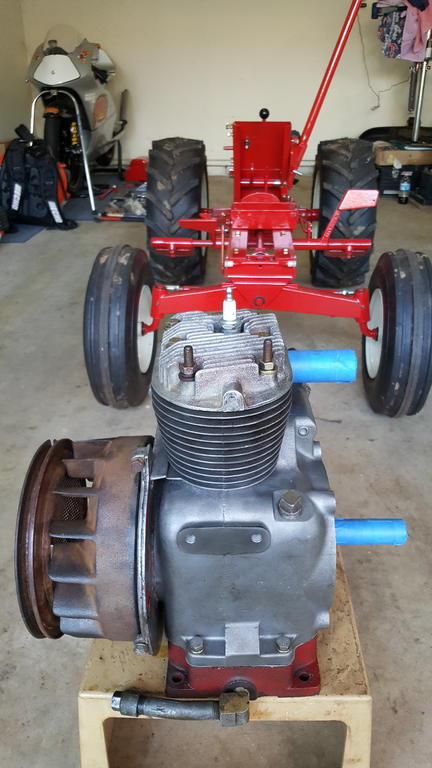

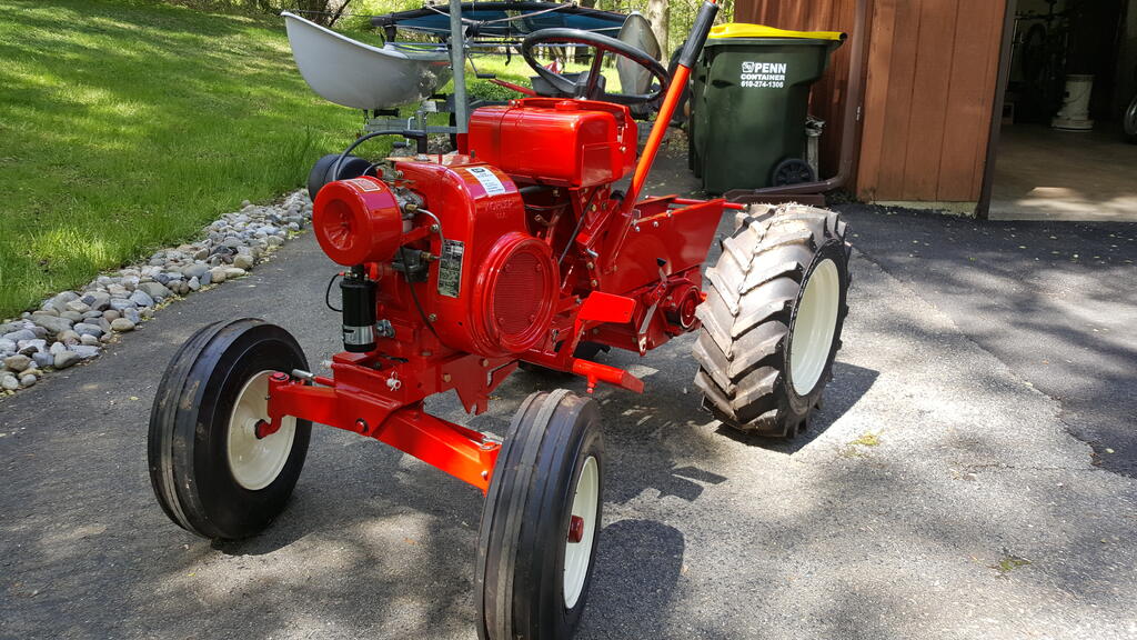

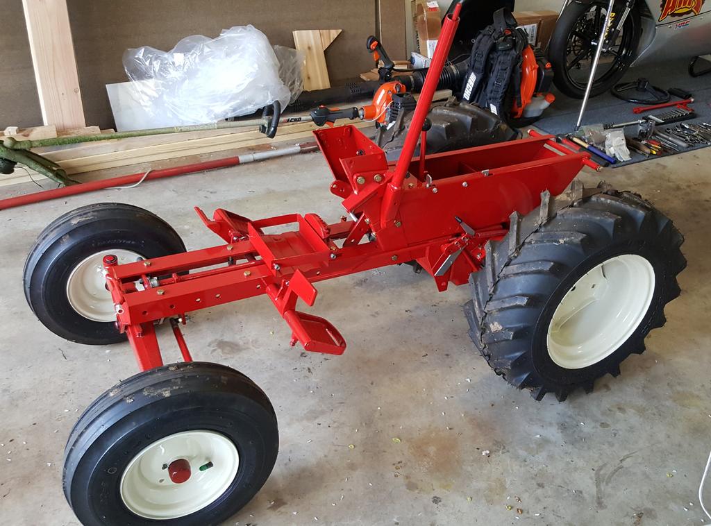

BenHolcomb 332 #79 Posted April 21, 2020 Well it's back on all four. 3 5 3 Share this post Link to post Share on other sites

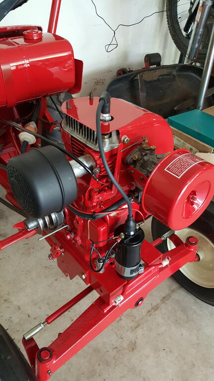

ebinmaine 81,192 #83 Posted April 21, 2020 Forgive me if you've covered this already... Painting the engine? Share this post Link to post Share on other sites

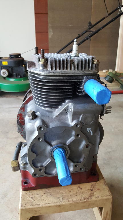

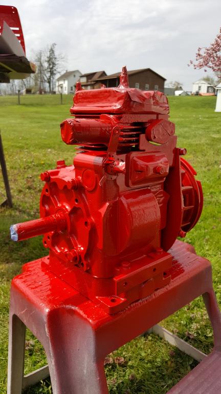

BenHolcomb 332 #85 Posted April 22, 2020 1 hour ago, ebinmaine said: Forgive me if you've covered this already... Painting the engine? Yep same paint and primer as the rest. Hopefully it takes to the heat! The whole thing needs washed and degreased so the head is lightly bolted down and will be taped up, tins and most brackets will be painted separately. Im tempted to finish assembling it and paint it all together..but the media blasting/hot tank really took it down to bare metal and I don't think paint would get everywhere I'd like it to if the tins and starter were on. 1 Share this post Link to post Share on other sites

ebinmaine 81,192 #87 Posted April 22, 2020 6 hours ago, BenHolcomb said: Yep same paint and primer as the rest. Hopefully it takes to the heat! The whole thing needs washed and degreased so the head is lightly bolted down and will be taped up, tins and most brackets will be painted separately. Im tempted to finish assembling it and paint it all together..but the media blasting/hot tank really took it down to bare metal and I don't think paint would get everywhere I'd like it to if the tins and starter were on. It'll be fine all except maybe right beside the exhaust port. Definitely best to paint as it is. Then add tin. Very nice! 2 1 Share this post Link to post Share on other sites

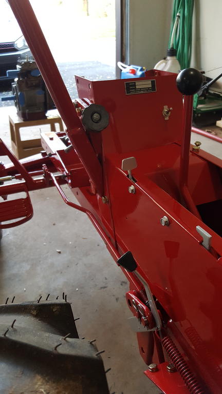

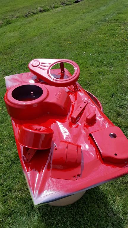

BenHolcomb 332 #90 Posted April 30, 2020 More red bits! It's been a productive day. 1 2 Share this post Link to post Share on other sites
BenHolcomb 332 #92 Posted April 30, 2020 Also sprayed the underside of the tins and most importantly the dash surround. Should have my work cut out for me this weekend. Share this post Link to post Share on other sites

RandyLittrell 3,946 #95 Posted April 30, 2020 On 4/21/2020 at 8:25 PM, BenHolcomb said: Yep same paint and primer as the rest. Hopefully it takes to the heat! The whole thing needs washed and degreased so the head is lightly bolted down and will be taped up, tins and most brackets will be painted separately. Im tempted to finish assembling it and paint it all together..but the media blasting/hot tank really took it down to bare metal and I don't think paint would get everywhere I'd like it to if the tins and starter were on. I painted my Original Cub Cadet with acrylic enamel paint close to 15 years ago and she stills look good. You paint will hold up to the heat just fine. Randy 1 Share this post Link to post Share on other sites

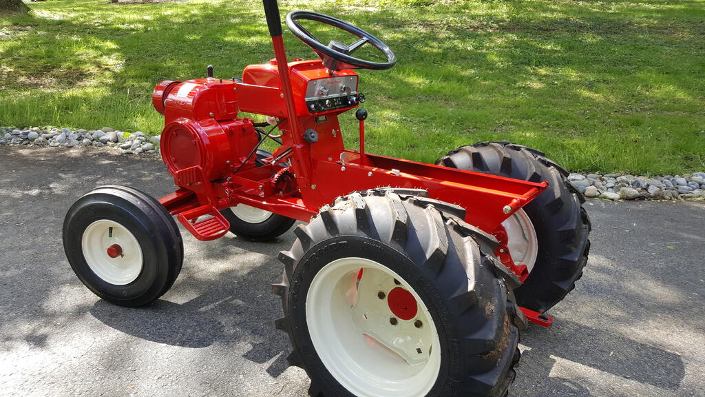

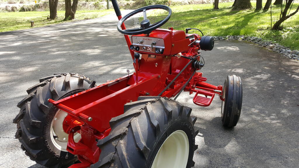

BenHolcomb 332 #96 Posted May 9, 2020 90% there.. 3 4 2 Share this post Link to post Share on other sites

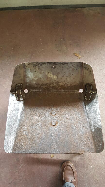

BenHolcomb 332 #98 Posted May 11, 2020 For my first time ever welding anything, I'm pleased with this repair. Both sides were split clean through, then there were cracks which had to be welded shut than ground down. It's not pretty and I'm only happy with two little welds where I got the heat and speed just right..but with the reinforcement plates it should hold just fine. 4 2 Share this post Link to post Share on other sites
Pullstart 71,527 #99 Posted May 13, 2020 Ben, this is looking great! Keep it up man, and great little project to practice the welding skills 1 Share this post Link to post Share on other sites
