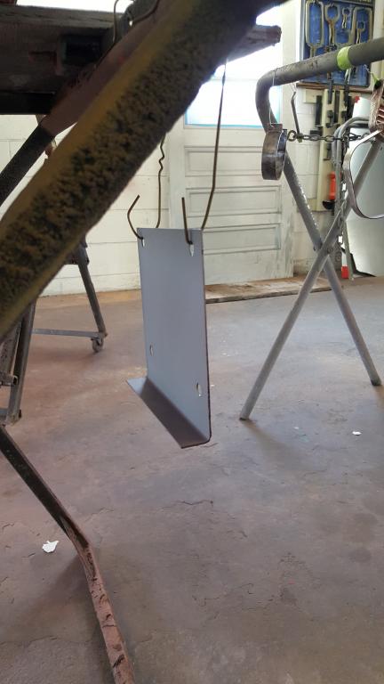

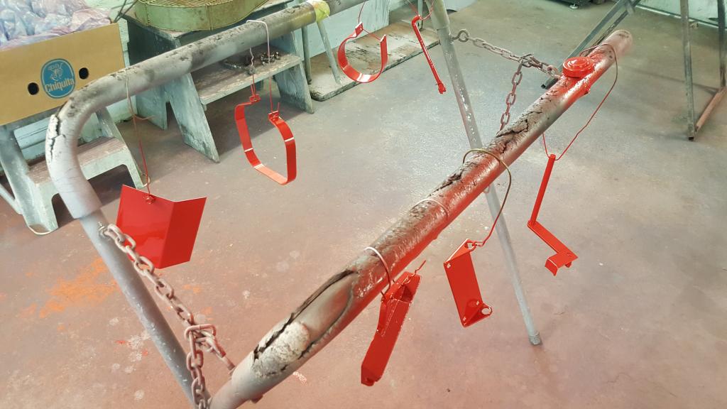

BenHolcomb 332 #51 Posted January 5, 2020 The seat pan, hood, and belt cover will be the last items to be painted as they cover the most real estate and need to really pop. Theyll all get normal high build automotive primer followed by wet sanding with 600 grit prior to paint. 3 Share this post Link to post Share on other sites

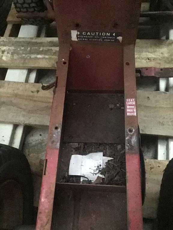

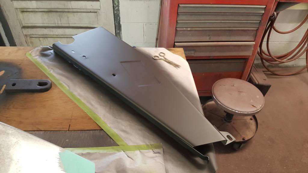

BenHolcomb 332 #60 Posted January 6, 2020 Little help needed fellas. What is the correct location and orientation for this pannel? A picture would be even better! I think it mounts at the back of the frame rails and the dash tower closing up the gap infront of the shifter lever but the mounting holes have me confused. Share this post Link to post Share on other sites
gwest_ca-(File Mod) 12,543 #61 Posted January 6, 2020 Just in case you do not have it. Click on the picture Garry 1 Share this post Link to post Share on other sites
BenHolcomb 332 #62 Posted January 6, 2020 Garry appreciate the effort, but this panel is not shown on the blown up parts schematic. Share this post Link to post Share on other sites
WHX?? 58,347 #63 Posted January 6, 2020 (edited) Sure looks like the filler panel that goes in the tunnel. It sets on the bottom with the 90 facing forward and up. Only one set of holes are used. I don't see it on the ipl either but goes right below the upper filler panel #10. The 90 is in front of the hood stand & should be holes in the frame for two 5/16 bolts. Sorry Ben don't have a pic. Edited January 6, 2020 by WHX24 1 Share this post Link to post Share on other sites
BenHolcomb 332 #64 Posted January 6, 2020 3 hours ago, WHX24 said: Sure looks like the filler panel that goes in the tunnel. It sets on the bottom with the 90 facing forward and up. Only one set of holes are used. I don't see it on the ipl either but goes right below the upper filler panel #10. The 90 is in front of the hood stand & should be holes in the frame for two 5/16 bolts. Sorry Ben don't have a pic. Thanks Jim very helpful. I should be able to figure it out from there! Share this post Link to post Share on other sites
Pullstart 71,527 #65 Posted January 6, 2020 At least he knows wha side to paint the best Jim! Share this post Link to post Share on other sites
Pullstart 71,527 #66 Posted January 9, 2020 Hey Ben, here’s that plate for reference. Two 5/16” bolts, in the front two holes. Share this post Link to post Share on other sites

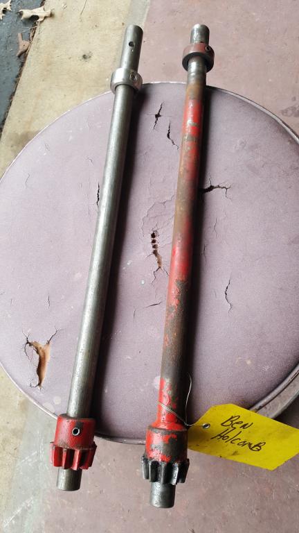

BenHolcomb 332 #69 Posted January 11, 2020 Picked up new the steering shaft, from the fabricator. Im peased with how this turned out...the damage? $42 with the collar, very fair in my opinion! I'll probably add a tack or two too the pinion for piece of mind. 3 2 Share this post Link to post Share on other sites

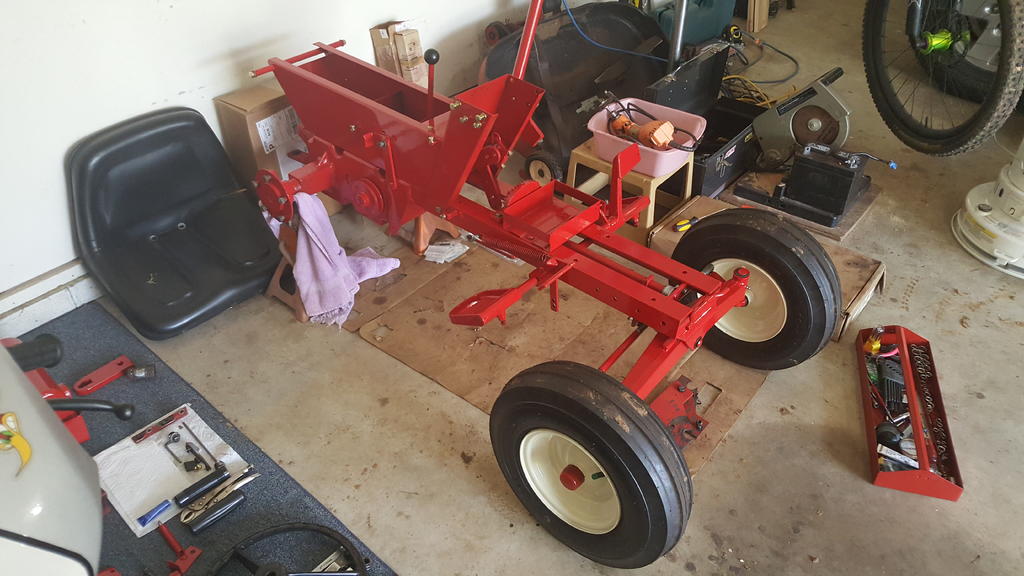

BenHolcomb 332 #70 Posted April 16, 2020 Afternoon fellas, figured I'd give a bit of an update. Progress has been slow on the 856 as I've been waiting for the last running gear and steering tower pieces to be painted it didn't make sense to assemble any further. The machine shop completed the k181 refresh boring ten over, cutting the valve seats, installing a new valve guide, and hot tanking. This was followed by media blasting in preparation for paint. A local mechanic reassembled the block to 90% I've just got to bolt the external stuff on, carb, pulse pump, tins etc. Again that doesn't really make sense to do until it's painted as they're all in the way of a thorough respray. If anyone is interested in the price for these type of services after tax. Machine shop~ $160 Engine reassembly~ $170 (2hrs labor) Other costs were NOS EBay finds or vendors here. All in it was more than I anticipated, but I know it's done right, and with all NOS parts=peace of mind 4 8 1 Share this post Link to post Share on other sites
