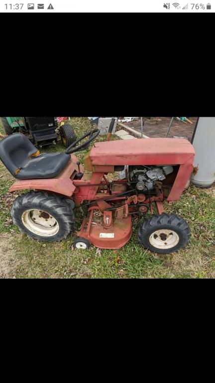

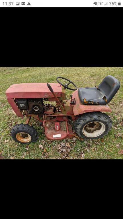

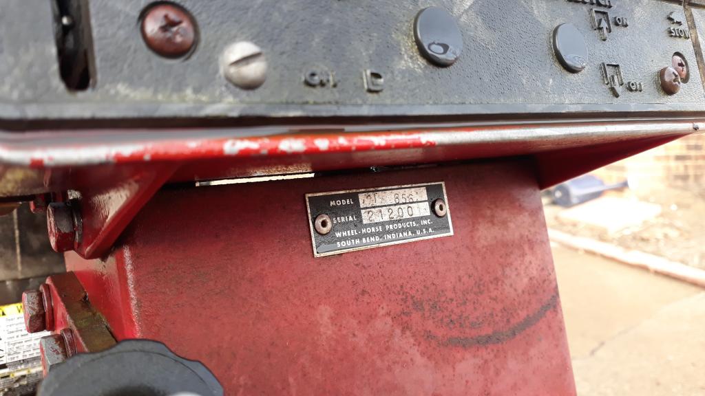

Indoorsoccerfrea 3 #1 Posted December 28, 2019 (edited) Hello all, I am just getting acquainted with the WH cult. I picked up a frankentractor off of Craigslist for $50 and a few trades. The decals on the hood indicate it is a B80, but the model and serial number tag under the steering wheel state it is a 656. Are there other markings elsewhere to indicate what it is? It has a newer 5.5 hp briggs Intec 206 on it, and the belt appears to be too long. The idler pulley is all the way up and the belt still slips. No matter what gear I am in it only can manage a crawl. I suspect swapping out the belt for a tighter one will resolve that issue. One thing I am struggling with is the brake pedal/parking brake link up. The transfer rod from the brake pedal to the brake drum is bent a bit at the threads. It also was somehow put on between the drum and the frame, so I can't get it off without disassembling something else. Any tips or tricks? I have the rear discharge deck off of it, needs a new wheel and a good cleaning but otherwise seems functional, anyone want to trade a plow blade for it? Edited December 28, 2019 by Indoorsoccerfrea Grammar 1 Share this post Link to post Share on other sites
stevasaurus 23,696 #2 Posted December 28, 2019 Welcome to Red Square. You have a 656 with a B-=80 hood...probably to get the Briggs to fit. The 656 would have a 6 hp Tecumseh for the power source. You will need to find a belt guard to cover the drive belt...or manufacture something. The belt guard is your clutch. When you step on the clutch/brake pedal, that tension pulley puts slack in the drive belt and the guard funnels the slack toward the engine drive pulley. That will let the input pulley on the transmission come to a stop so you can shift gears without grinding the transmission. The original belt guard may not fit correctly now with that Briggs in there, but you may be able to modify it enough to fit. If you did not get the belt guard in the deal, see if the seller still has it. Your other issue, that piece of linkage, is fixable also. I think we would like to see a good picture of what you have there. All in all...not bad for $50 1 Share this post Link to post Share on other sites
