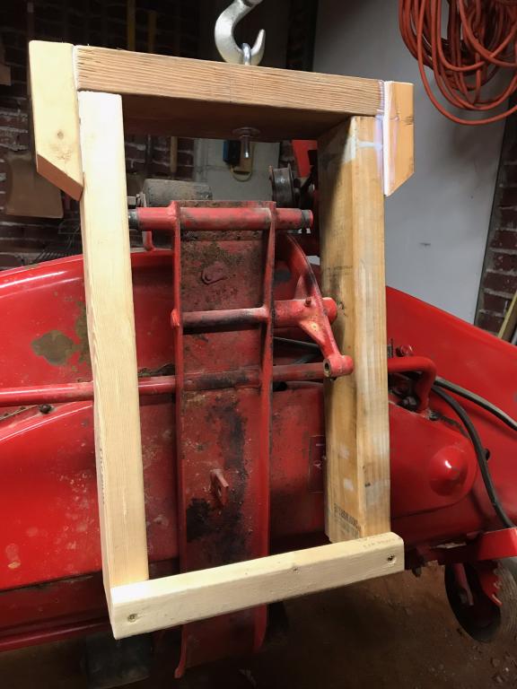

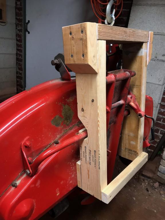

McGrew 461 #11 Posted December 29, 2019 OK guys, I could not leave well enough alone. And I got tired of tripping over the deck... So I fabbed up a hanger that allows me to hoist the deck off the floor and hang vertical. It is a simple design and is made of scraps of 2x4 and 2x6. I have only lifted it with a come-a-long, but am working on a pulley system. It’s ugly, but it works! Disregard the condition of the deck... One day I will get around to restoring it...Danny 1 1 Share this post Link to post Share on other sites
tunahead72 2,635 #12 Posted December 30, 2019 Not ugly at all, in my opinion. Looks well designed, simple and completely functional, well done! Share this post Link to post Share on other sites
