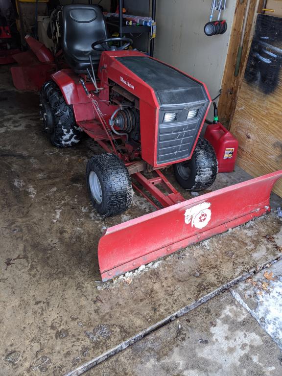

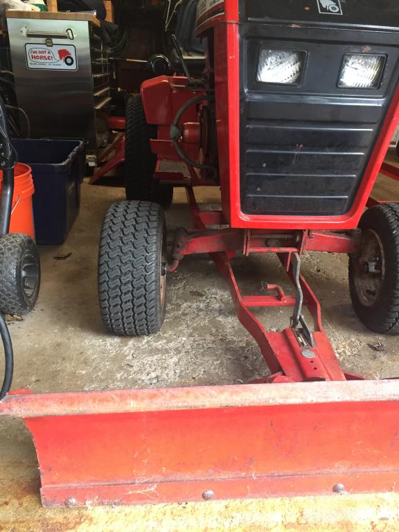

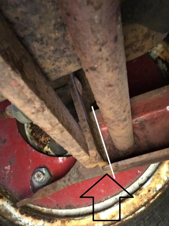

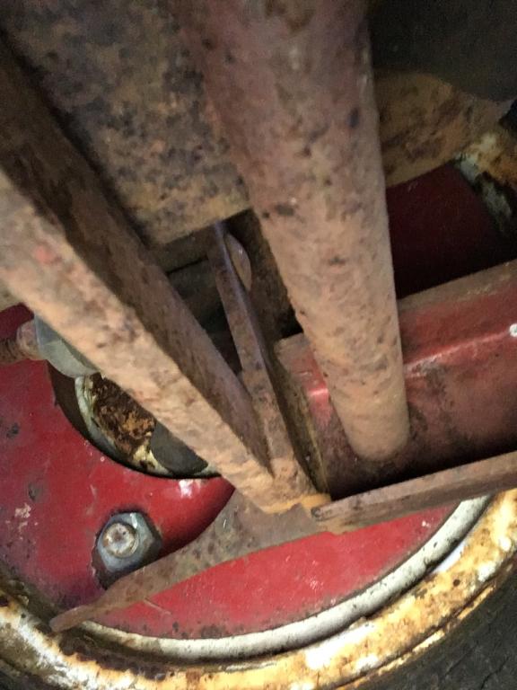

wheelwhores 107 #1 Posted December 21, 2019 I just bought a c175...has a 54" plow. I can't get the plow to hit the ground...hovers about a half in off ground. Hydro lift is all the way down with slack in the chain....seems like is hung up on something in back where it mounts to the axel. Share this post Link to post Share on other sites

pfrederi 21,225 #6 Posted December 21, 2019 Look like you are using a short frame plow on a long frame tractor. 54" plow what was it from??? C175 used 42 or 48" . 1 Share this post Link to post Share on other sites
wheelwhores 107 #7 Posted December 21, 2019 Not sure, can with the package of stuff....guy was a collector so he had a bunch of other WHs...and mod that can be done to address it? I t has enough flex I can Puch it to the ground easily... But weight of plow alone won't keep it grounded. Share this post Link to post Share on other sites

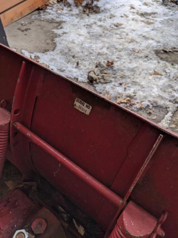

wheelwhores 107 #10 Posted December 21, 2019 Here is the plow and serial number Share this post Link to post Share on other sites

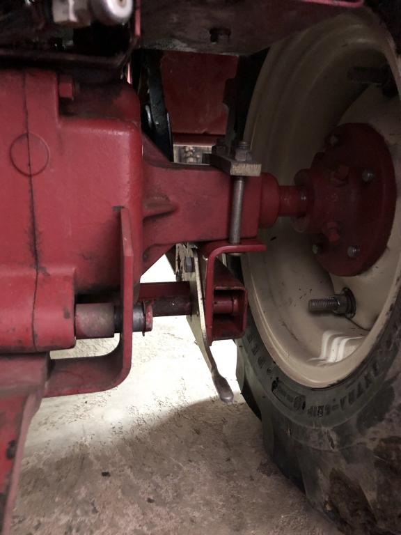

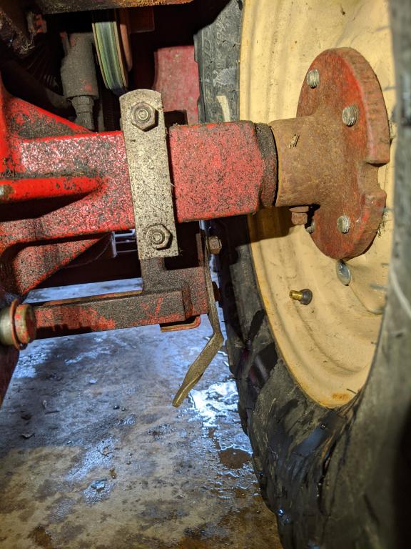

wallfish 20,680 #12 Posted December 21, 2019 That frame appears long enough. Pretty sure they made a long A frame plow frame. If it will index to both side angles without hitting the front tires it's long enough. Maybe some pics around the lift areas will help figure out why it's hanging up. Is it binding up here at the axle bracket? Share this post Link to post Share on other sites

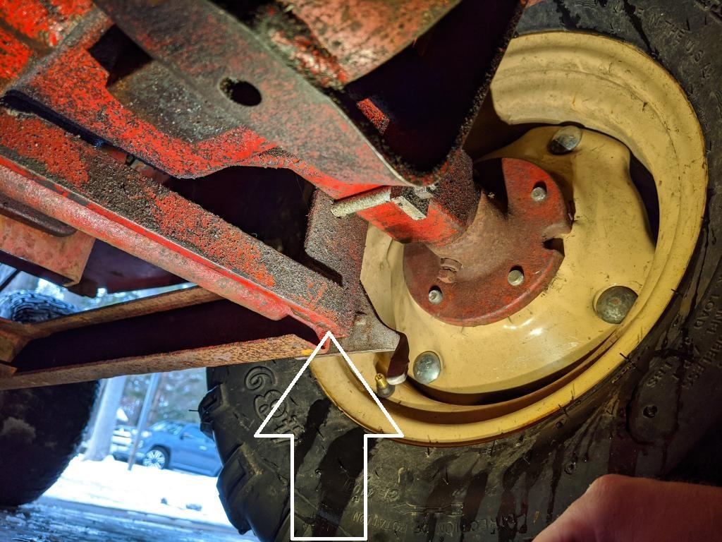

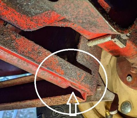

ol550 879 #13 Posted December 21, 2019 Possibly the A frame hitting the inside of the rear axle bracket where John's arrow point is? Share this post Link to post Share on other sites
gwest_ca-(File Mod) 12,511 #14 Posted December 21, 2019 The blade is a 1964 model BD-543 originally produced for the 953, 1054 and 1054A tractors. Click on the picture Garry Share this post Link to post Share on other sites

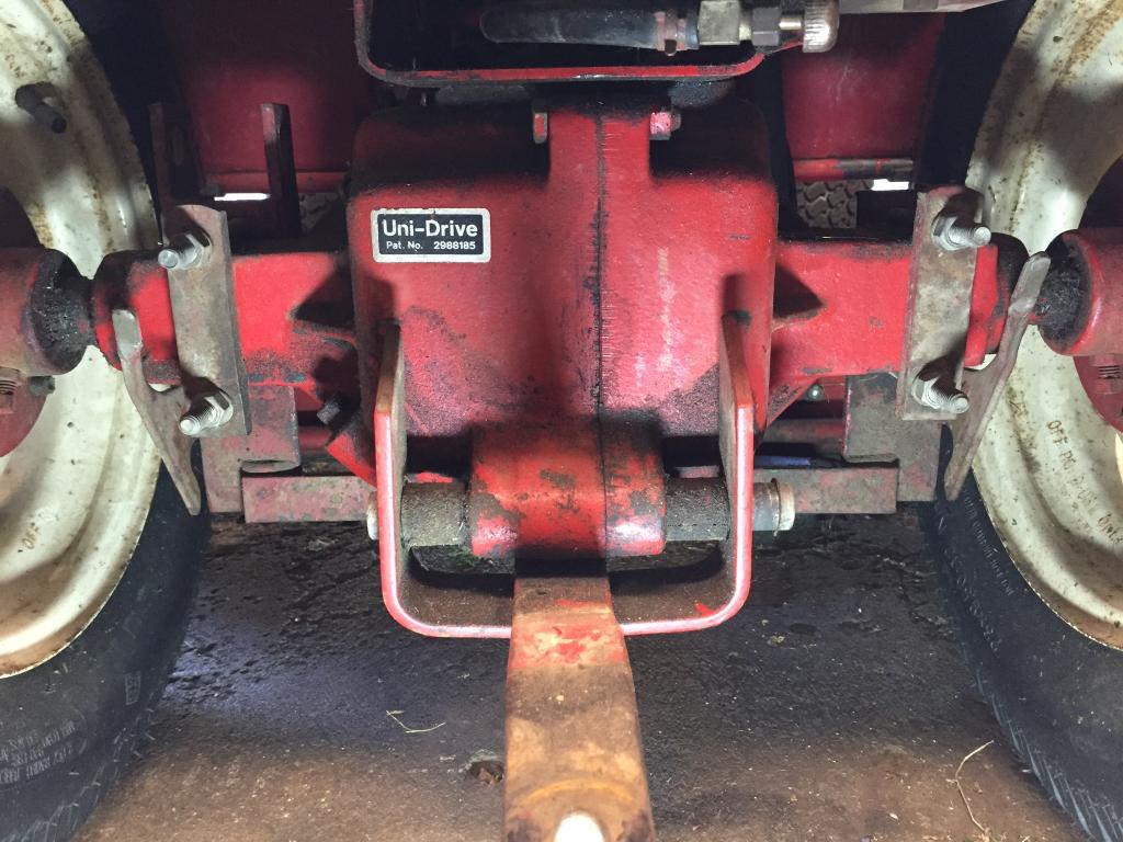

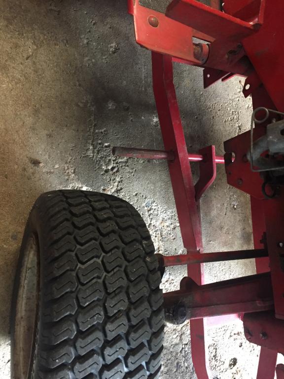

The Tuul Crib 7,354 #15 Posted December 21, 2019 Looks like the plow bracket is on wrong or Possibly backwards.Heres what it should look like. 1 Share this post Link to post Share on other sites
gwest_ca-(File Mod) 12,511 #16 Posted December 22, 2019 40 minutes ago, The Tool Crib said: Looks like the plow bracket is on wrong or Possibly backwards.Heres what it should look like. Notice how his bracket assembly is mounted on the front of the axle housing. This design has the A-frame inside the axle brackets. Your bracket assembly is mounted on the bottom of the axle housing and the A-frame is on the outside. Garry Share this post Link to post Share on other sites
wheelwhores 107 #17 Posted December 22, 2019 Garry. Are you saying that his mounting configuration is the way mine should be configured? Share this post Link to post Share on other sites
wheelwhores 107 #18 Posted December 22, 2019 4 hours ago, wallfish said: That frame appears long enough. Pretty sure they made a long A frame plow frame. If it will index to both side angles without hitting the front tires it's long enough. Maybe some pics around the lift areas will help figure out why it's hanging up. Is it binding up here at the axle bracket? Yes definitely binding at axel and not at the hydro lift area Share this post Link to post Share on other sites
wallfish 20,680 #19 Posted December 22, 2019 19 minutes ago, wheelwhores said: Yes definitely binding at axel and not at the hydro lift area I'll have to take a look at mine tomorrow. It's the same axle bracket but a short A frame plow, though it should still be the same setup. Yours does look kind of tight there and it shouldn't be tight enough to bind. Share this post Link to post Share on other sites
wheelwhores 107 #20 Posted December 22, 2019 1 hour ago, wallfish said: I'll have to take a look at mine tomorrow. It's the same axle bracket but a short A frame plow, though it should still be the same setup. Yours does look kind of tight there and it shouldn't be tight enough to bind. Thanks bud!...I have to say this is hands down the best forum/community I have been in Share this post Link to post Share on other sites
gwest_ca-(File Mod) 12,511 #21 Posted December 22, 2019 8 hours ago, wheelwhores said: Garry. Are you saying that his mounting configuration is the way mine should be configured? The axle brackets for the early dozers is what you have mounted ahead of the rear axle. The A-frame is an A-shape at the back end. When they went to a dozer that would fit both long and short frame tractors the front of the A-frame is the same but the rear is like the bottom half of an H - the sides are parallel. These require a rear hitch mounted to the bottom of the axle. The C-175 is a 1980-1984 long frame tractor. Here is a list of the blades in the order they were produced. The 1963-1965 BD-543 you have is not included in the list because at the time they had not yet produced a long frame tractor. When they did it turns out the blade you have does fit a long frame tractor due to the simplicity of the design. The 54" blades were only recommended for the 16hp and up models from 1973 on but the rest of the kit was the same. Dozer DNA of long tractor frame dozer blades 1966-1967 model BD-426 - Fits LONG frame tractors - Mounts ahead of the rear axle - replaced by 1968 model 6-1111 - Fits LONG frame tractors - Mounts ahead of the rear axle ---------------------------------------------------------------------------------------------------------------------- 1968 model 6-4111 - First to fit LONG & SHORT frame tractors and first to mount under the rear axle - replaced by 1969 model [6-4112 + 6-9621] 1970-73 model [6-4113 + 6-9622] 1973-74 model [6-4113 + 6-9623] 1974 model [6-4114 + 6-9624] 1974 model 6-2131 1975 model 6-2132 1976 model 6-2133 1976 model 66-42BC01 1977 model 76-42BC01 1978 model 86-42BC01 1979 model 96-42BC01 1980 model 06-42BC01 1981-1984 model 06-42BC02 (Up to here including this one they are 42" wide) 1984-1989 model 06-48BC01 (They are now 48" wide) - replaced by the following 1990 model 06-48BC02 (Last blade to have 3 angle positions) 1991-1993 model 06-48BC03 (First blade to have 5 angle positions) 1993-2001 model 79350 - (105-1502 kit adapts 2001 and older GT Classic-Series blades to fit 2002 and later tractors 2002 2004-2009 2012 model 79364 - (105-1501 kit adapts 79364 blade to fit 2001 and older GT Classic-Series) Share this post Link to post Share on other sites

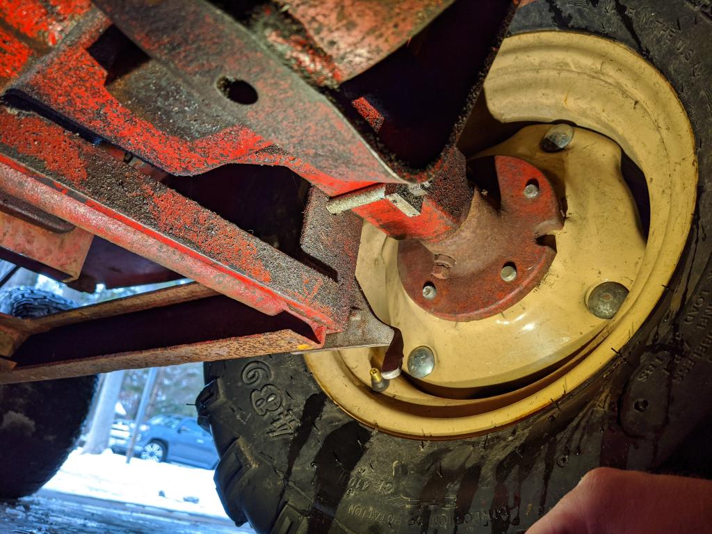

wallfish 20,680 #22 Posted December 22, 2019 Hmm, everything you have there looks right to me so not sure why it's binding but can't tell from your pic because of the angle how much space there is between the frame and the bracket. This pic is with the blade down and it will float down quite a bit farther without binding. Notice the space between the frame and bracket. 1) Disconnect the lift linkage and test up and down movement by hand lifting and lowering the blade. Just be careful not to bounce all that leveraged weight because that's a lot of stress on the cast axle tube if it is binding there. Two people is best so you can look for the places it's binding while the frame is moving. 2) Drop the frame down out of the axle bracket and inspect all of the metal edges on the back of the frame and the bracket for the places it could be binding. Post some pics 3) Grind or cut about 1/8" - 1/4" off the back of the A frame behind the round bar. It will not effect the strength of the frame Share this post Link to post Share on other sites
wallfish 20,680 #23 Posted December 22, 2019 Something looks funny with that round bar too but maybe it's just the shadow from the pic. That bar should be a continuous dimension all the way through it's entire length but this looks like it is not. Is something changed there? Share this post Link to post Share on other sites
Lee1977 7,805 #24 Posted December 22, 2019 (edited) 13 hours ago, wheelwhores said: Garry. Are you saying that his mounting configuration is the way mine should be configured? You have an older snow blade bracket it is mounted the right way. The later bracket mounted under the axle as in post # 16 by qwest. Your plow frame is hitting the space bar on the bracket. The later style plow frame also mount out side of the bracket so there isn't binding. Edited December 22, 2019 by Lee1977 Share this post Link to post Share on other sites

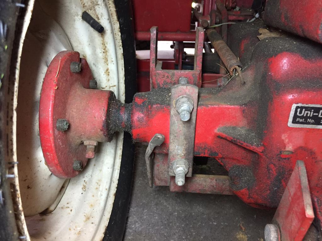

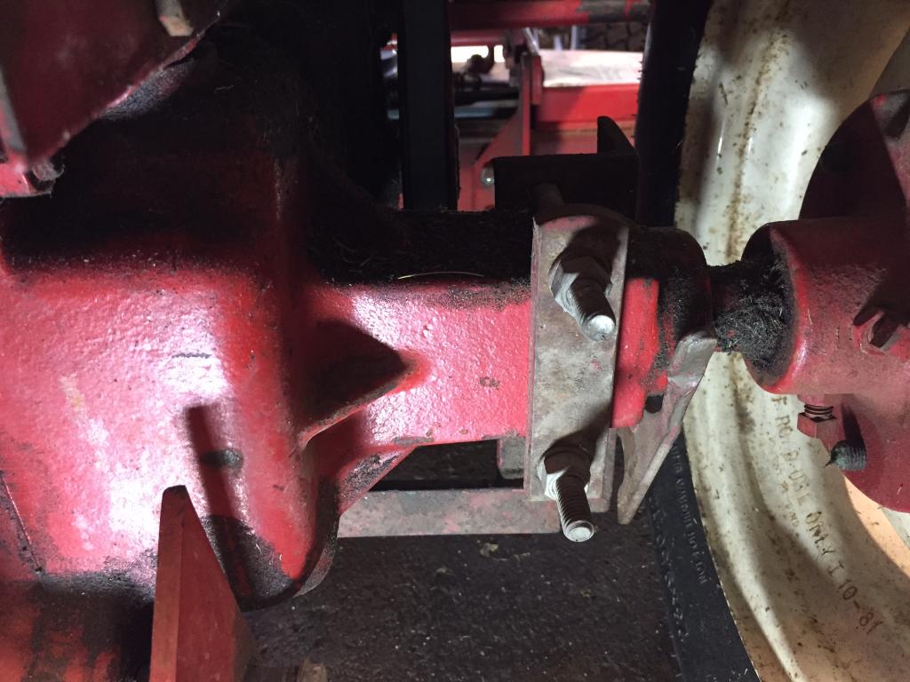

SylvanLakeWH 32,703 #25 Posted December 22, 2019 I have a similar configuration as you but mounted on a 1982 C 105-8 speed... PO rigged it and it works just fine... Here are some pics. Hope they help... Share this post Link to post Share on other sites
