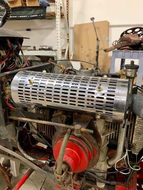

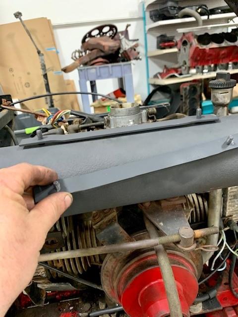

Greentored 3,221 #29 Posted January 9, 2020 (edited) More progress pics. Installed a 1/4" rod to stop the hood (thanks Lee!), whipped up some exhaust shield brackets and clamped them to the muffler since the studs were snapped off. Not sure how thick the muffler material is to attempt welding new studs on. Cant wait to put this baby to work! Edited January 9, 2020 by Greentored 4 Share this post Link to post Share on other sites
tom2p 2,396 #30 Posted January 10, 2020 2 hours ago, Greentored said: More progress pics. Installed a 1/4" rod to stop the hood (thanks Lee!), whipped up some exhaust shield brackets and clamped them to the muffler since the studs were snapped off. Not sure how thick the muffler material is to attempt welding new studs on. Cant wait to put this baby to work! hey - how did you and what did you use to clamp the brackets to the muffler ? braze or spot weld could damage or go through metal ? guess they don't have adhesives for this type of application that perform like the adhesives often used to attach doors skins and quarters ? Share this post Link to post Share on other sites
Greentored 3,221 #31 Posted January 10, 2020 Tom, Not sure how thick the material is on the muffler, did not attempt welding new studs to it. I used some 1/8" x 3/4" flat stock, drilled and tapped the holes, ran short bolts in from the back side, stepped the flat stock so it would sit flush, and used a pair of 4" stainless hose clamps to secure the flat stock to the muffler. Share this post Link to post Share on other sites
