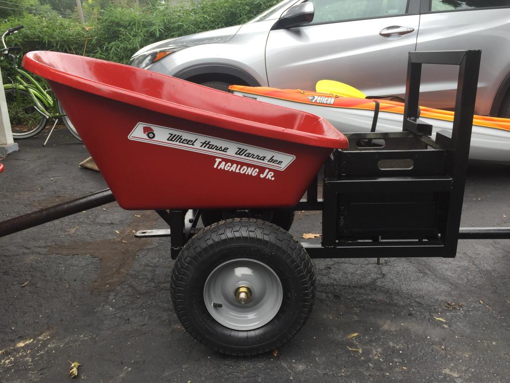

SylvanLakeWH 32,152 #4 Posted December 17, 2019 I built 2 out of old wheel barrows... 6 Share this post Link to post Share on other sites

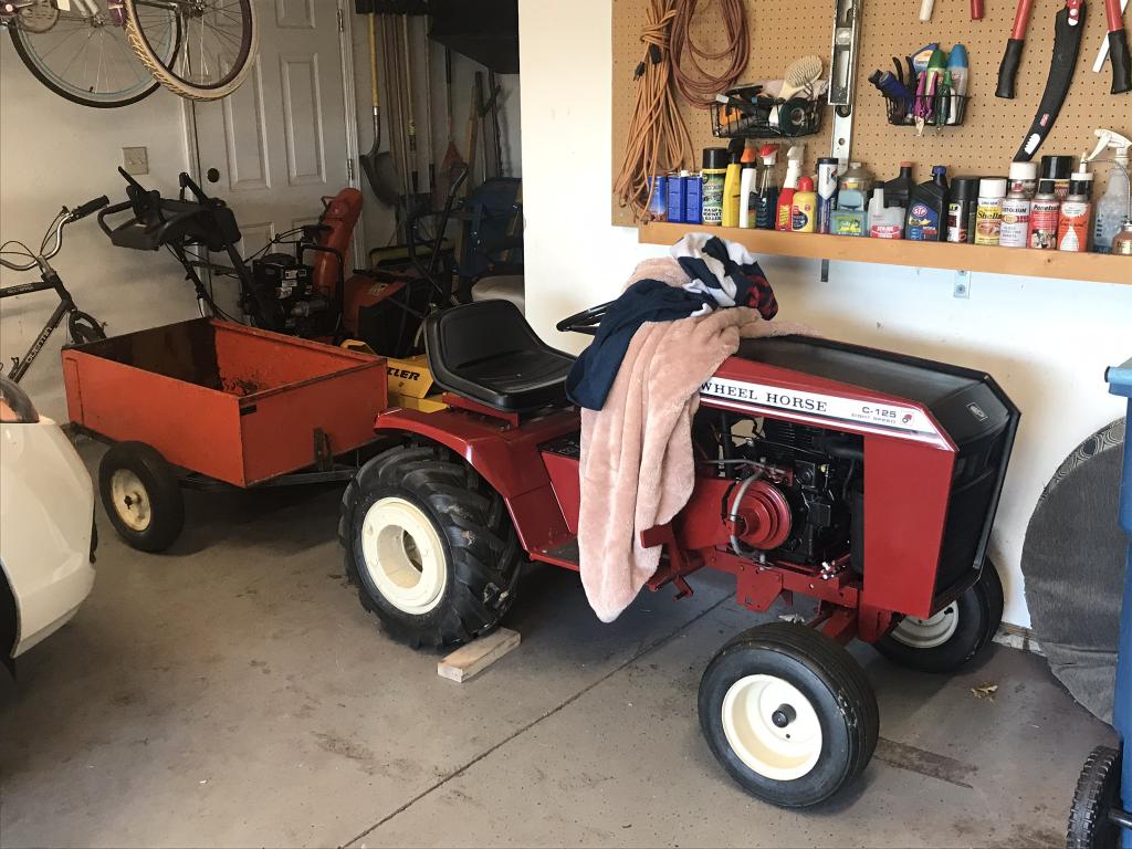

ebinmaine 80,313 #5 Posted December 17, 2019 3 hours ago, JCM said: For safety measures if you purchase a 17 ft cart and load it to Max Capacity and go downhill make sure you have a good braking system on your tractor and go SLOW Note the highlighted word above. I'd like to add to that just a little bit. The trailer that I use is the orange 10 cubic foot Agri Fab dump that I moved the axle about 14" backwards. That particular trailer is very stable uphill or downhill. Trina uses a 1976 or 77 Ohio Steel 10 cube trailer which is still in its original state with the axle centered in the box. When she goes up hill the tongue of the trailer lifts up and greatly reduces her traction. We have a 17 cubic foot trailer of unknown brand. All metal. Built rugged. At least a couple decades old. That one has the axle even a little bit to the forward side of center of the box. Use great caution going uphill or downhill. The question with these particular tractors is not normally whether you can PULL something but whether you can STOP something. 2 Share this post Link to post Share on other sites
SylvanLakeWH 32,152 #6 Posted December 17, 2019 I’m dead flat terrain so my trailers are designed to pretty much be balanced when loaded... On hills I would go with slightly more tongue weight... 1 Share this post Link to post Share on other sites
