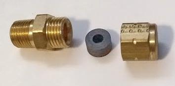

rmaynard 17,416 #12 Posted December 21, 2019 I know I'm a little late to the party here, but if your fittings are the type with the rubber ring in them, you shouldn't need any sealant on the threads since the rubber is the seal, not the threads. If they leak, replace the rubber seal. As far as Teflon tape or Teflon paste, anything other than the yellow is not safe for fuel. Petroleum will dissolve it. 1 Share this post Link to post Share on other sites
WildmanC120 613 #13 Posted December 21, 2019 1 hour ago, rmaynard said: I know I'm a little late to the party here, but if your fittings are the type with the rubber ring in them, you shouldn't need any sealant on the threads since the rubber is the seal, not the threads. If they leak, replace the rubber seal. As far as Teflon tape or Teflon paste, anything other than the yellow is not safe for fuel. Petroleum will dissolve it. Truth. Use the yellow Teflon tape made for gas and you will be fine. I use it all the time. You can even get it at Lowe's or Home Depot 1 Share this post Link to post Share on other sites
