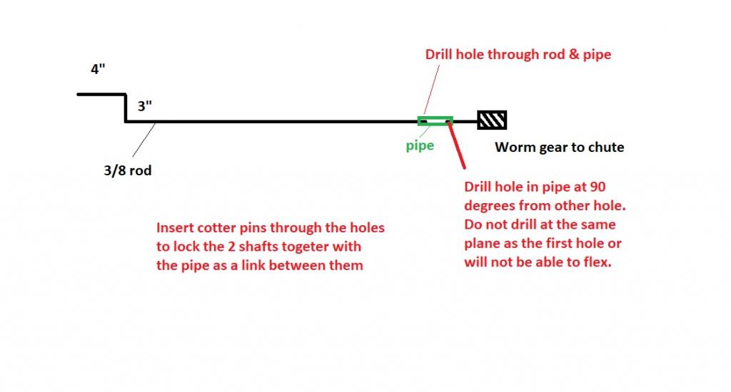

wallfish 20,510 #2 Posted December 15, 2019 You can make one out of a 4ft length x 3/8 steel rod, a small piece of pipe and 2 cotter pins 7 Share this post Link to post Share on other sites

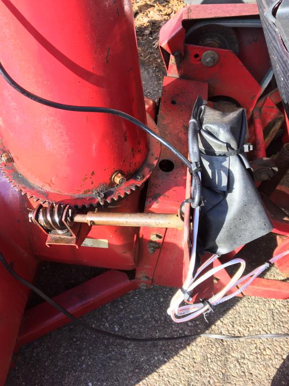

wallfish 20,510 #3 Posted December 15, 2019 Or go electric with a 12v dc motor. I used a power window motor for mine and made a bracket to mount it to. It's covered with a piece of membrane roof material just to keep ice out. That's a piece of 1/2" copper pipe to link the 2 shafts. 6 2 Share this post Link to post Share on other sites
Hughes Small Engine 4 #4 Posted December 15, 2019 5 hours ago, wallfish said: You can make one out of a 4ft length x 3/8 steel rod, a small piece of pipe and 2 cotter pins Oh awesome! I was hoping someone had made something up like that before. Does the pipe need to be just slightly larger than the rod and worm gear end to be able to flex? I wonder if I could use a u-joint instead. I have a welder so I could fab something up without the limitations of only using hardware. Share this post Link to post Share on other sites
Hughes Small Engine 4 #5 Posted December 15, 2019 5 hours ago, wallfish said: Or go electric with a 12v dc motor. I used a power window motor for mine and made a bracket to mount it to. It's covered with a piece of membrane roof material just to keep ice out. That's a piece of 1/2" copper pipe to link the 2 shafts. That's pretty cool. I did actually think if trying to rig up something like that. Is there any certain kind of window motor or other electric motor that you would recommend? Share this post Link to post Share on other sites
wallfish 20,510 #6 Posted December 16, 2019 (edited) Most window motors rotate a gear around a pin but you'll need to rotate a shaft. Can't remember exactly what mine came from but it did need some minor modifications. Here's one you can use but it might be a little fast at 100 rpm. You can search around the net to find more. Use a 2 position momentary switch. The chute is also controlled with a small actuator and a 2 position momentary switch. https://www.surpluscenter.com/Electric-Motors/DC-Gearmotors/DC-Gearmotors/100-RPM-12-Volt-DC-Gearmotor-5-1649.axd Edited December 16, 2019 by wallfish Share this post Link to post Share on other sites

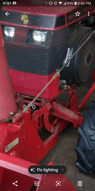

cafoose 3,817 #7 Posted December 16, 2019 Here's what I did 1 1 Share this post Link to post Share on other sites
WVHillbilly520H 10,379 #8 Posted December 16, 2019 2 hours ago, Hughes Small Engine said: Oh awesome! I was hoping someone had made something up like that before. Does the pipe need to be just slightly larger than the rod and worm gear end to be able to flex? I wonder if I could use a u-joint instead. I have a welder so I could fab something up without the limitations of only using hardware. A short section of rubber hose 3/8" or 1/2" (air compressor hose) with worm drive clamps is all you need for the "U-joint" where the 2 hairpins are closest together... https://www.partstree.com/models/79360-toro-42-snow-thrower-for-300-series-garden-tractors-sn-039000001-039999999-1993/control-chute-assembly-1/... Toro is quite proud of the chute crank rod and yes this one fits both the single tall chute and the 2stage. 1 Share this post Link to post Share on other sites
