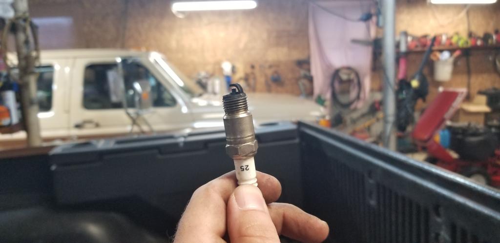

BrianX128 115 #11 Posted December 14, 2019 (edited) Just found a compression tester, front cylinder is 85 (the one that was wet) and the rear cylinder is 75. I know they aren't the same, but you would think I'd still be running on both. I swear it sounds like I am until the engine is under load. *edit* I might be an idiot. Front plug wasn't sparking, tried swapping plugs and problem follows the wet plug. I don't know if I have another plug to see if it runs normally or not but this is what was in it.. I'm hoping it died because the good plug was in the hole with lower compression and that's all that was running it so it didn't matter which plug I pulled it just coasted to a stop. Edited December 14, 2019 by BrianX128 Share this post Link to post Share on other sites
oldlineman 1,820 #12 Posted December 14, 2019 I would try some SeaFome has done wonders for me! Share this post Link to post Share on other sites
BrianX128 115 #13 Posted December 14, 2019 Yikes. Rookie mistake for sure, that spark plug is bad and that was the only issue. I've never had the "simple thing" be the cause of something like this in my last 100 tries, I guess I was due for one. I don't have whatever that "autolite 25" spark plug is, I just tossed in a random plug from the drawer of old mystery plugs and it fired off and runs normal. Is there a recommended plug for this engine? If so I should probably get two new ones before the other one dies while my wife mows next year on one cylinder. Smoking a lot, but there's a lot of unburnt fuel in that hole I guess. It's amazing how your mind can trick you into thinking you hear a noise and the engine is running normally when that's far from the truth. 1 Share this post Link to post Share on other sites
gwest_ca-(File Mod) 12,532 #14 Posted December 15, 2019 Champion plug RV15YC gapped to .025". Garry 1 Share this post Link to post Share on other sites
pfrederi 21,300 #15 Posted December 15, 2019 Autolite 25 Share this post Link to post Share on other sites
