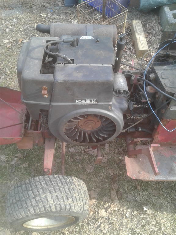

Herder 2,355 #5 Posted December 11, 2019 Hey there Bill, You know where to find a Mag 14 It's here when you need it. I've never tried to swop items between a K & Mag series so I cant really help, but to me they look very different as far as the bearing plate goes and the one thing that I see is the bearing shims that go behind the plate look different between a K and a Mag. That leads me to believe that the plates may not interchange. Granted I am no expert, just a Hillbilly. Adam. 1 Share this post Link to post Share on other sites
