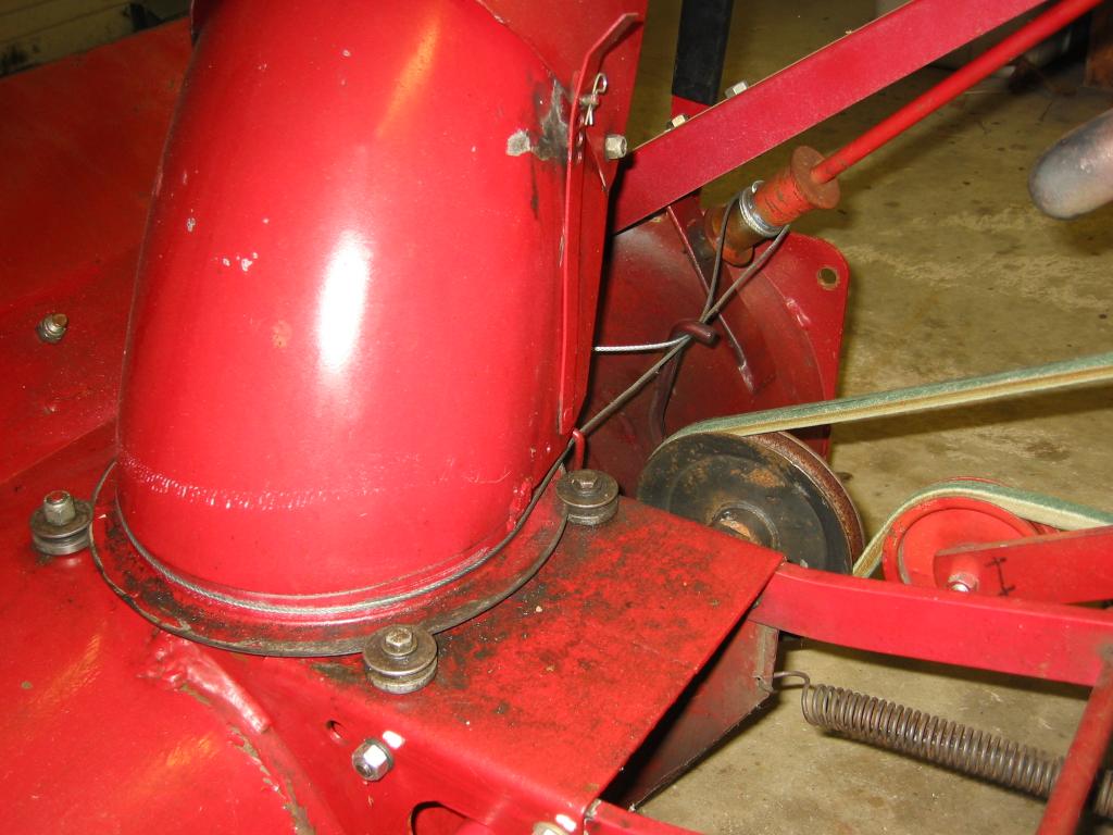

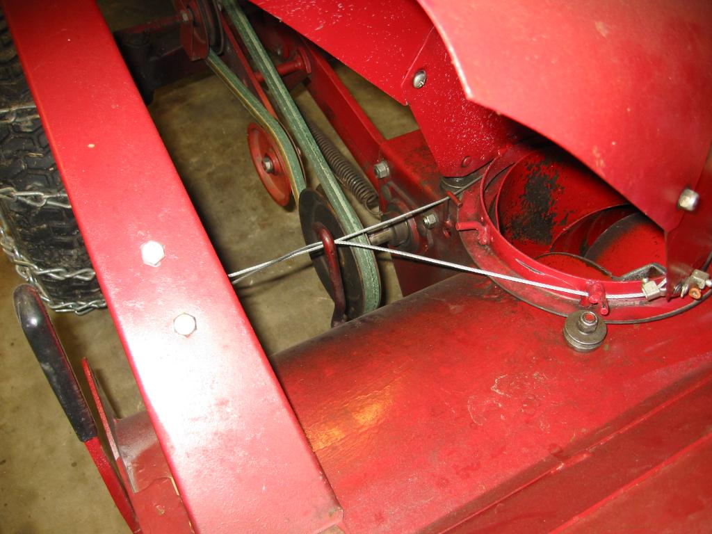

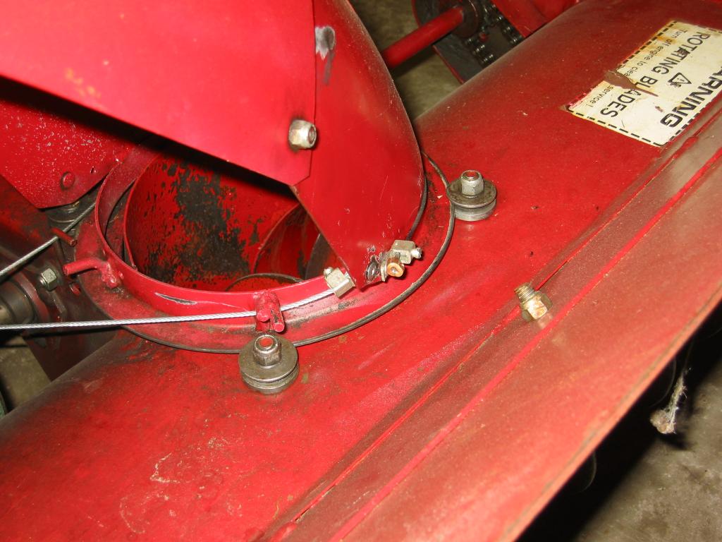

peter lena 10,016 #6 Posted December 8, 2019 REDH, found this ,that might help , lots of pictures and info, another thing that helped me out ,was that i used grass trimmer line to practice run the function and improving dragging areas. i also replaced the cable clamps on the chute , which are terrible , with electrical lugs ,https://www.mayerelectric.com/17119/Category/Mechanical-Lugs, brand is not important , but TYPE OF LUG IS , i simply drilled out the pop rivet on the chute holding the cable , and bolted on 2 new wire lugs for a solid easy mount point. lubrication is vital on all movement points of a blower , ESPECIALLY THE AUGER DRIVE CHAIN AREA, as you improve things , lubricate as you go to enhance your gain . any other questions , just ask , pete 1 Share this post Link to post Share on other sites

gwest_ca-(File Mod) 12,455 #10 Posted December 9, 2019 Left and right are always from the operator's position in the seat. The cable that goes to the right side of the chute goes around that L-shaped arm. Then the cable is lined up to wrap on the spool. The cable needs to be slightly loose so it does not pull the chute to the side. That way the side not being pulled is slightly loose when the other is tight. A bit of lubrication on the cable helps it slip on the L-bracket. Garry Share this post Link to post Share on other sites
RedH 5 #11 Posted December 30, 2019 Thanks again for everyone's help the photos were a great help. I got the snow thrower installed and I got the chute working nicely. Now I have one more question.. I see that there was a top frame extension plate that was offered for this snow thrower. Does it help and does any one know the dimensions of the plate? Share this post Link to post Share on other sites
