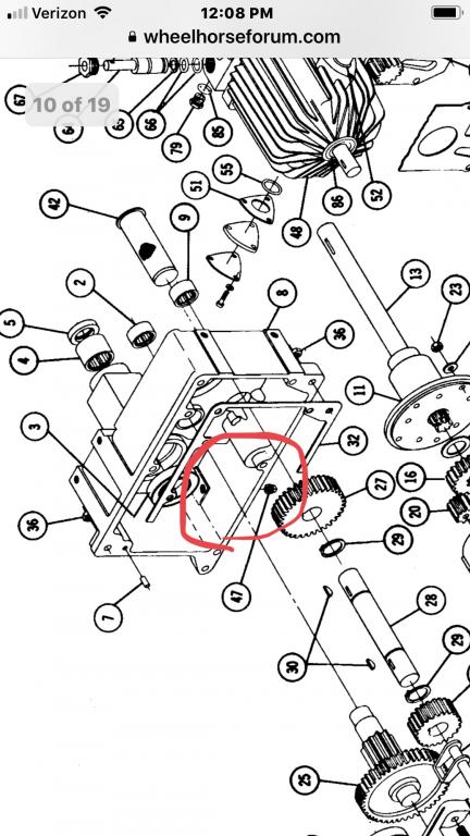

12Horse Paladin 1,038 #1 Posted December 6, 2019 (edited) Morning, everyone😊 I am going to be getting the tools needed (jack n jackstands n Valvoline 10w30 oil) today to change out the hydraulic fluid/filter on my Bronco 14, hoping to do this in the next few days b4 it turns cold.😁 Ive done searches n read my old manual n the lil bit of paper i have on it, but there isnt much of a description n no pics, on the procedure. I THINK I know which is the plug, but want to be sure. Could someone post a pic of where that drain plug is? Is there a procedure to follow, or tips or tricks? Or is it just like a car...pull the plug; the filter n drain, then replace all and that is it? Any and all pics would be very much appreciated! I'm assuming you just replace the fluid through the filler neck under the seat...i'm just praying that i pour slow enough, lol. Thanks for all your help n suggestions, everyone. Hope y'all have a good day! PS---Ithe expense wouldnt be a concern, rightnow....would it be best to change the fluid, run the tractor a bit, and change again, for any reason? I have limited space to actually move it around, but want to do this correctly/if necessary ...🤔 Edited December 6, 2019 by 12Horse Paladin 1 Share this post Link to post Share on other sites

The Tuul Crib 7,347 #6 Posted December 6, 2019 (edited) I don't have a picture but here is a breakdown of a parts list and its part number 47 it's under the hitch in the back. Edited December 6, 2019 by The Tool Crib Share this post Link to post Share on other sites
12Horse Paladin 1,038 #7 Posted December 6, 2019 12 minutes ago, The Tool Crib said: I don't have a picture but here is a breakdown of a parts list and its part number 47 it's under the hitch in the back. LOL! Sometimes i can b soooooo slow! Found it, thankyou!!!! 2 Share this post Link to post Share on other sites
