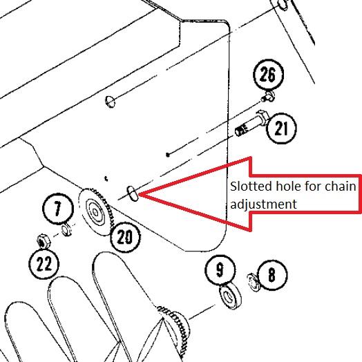

Tom kite 3 #1 Posted December 6, 2019 How to adjust chain on a old wheelhorse 32 single stage snowblower. I look all over couldn't fine anything. Share this post Link to post Share on other sites
gwest_ca-(File Mod) 12,455 #2 Posted December 6, 2019 You should have one idler sprocket inside the blower housing mounted on the left end plate. Loosen the sprocket mounting bolt. Garry 1 Share this post Link to post Share on other sites
WHX?? 57,808 #3 Posted December 6, 2019 The adjustment hole is not very slotted so if you can't adjust to the proper tension the chain is stretched and should be replaced. Share this post Link to post Share on other sites
