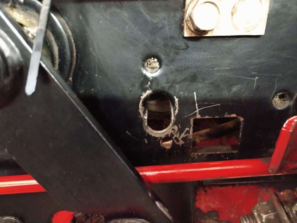

Mocrazy1 5 #1 Posted December 3, 2019 Hi Gents. I purchased a 1993 520h. Cleaning it up, and fixing various problems. Didn't move, welded both sides of frame for idler pulley, cross shaft. Got it moving and working. All good,on that front. I'm having to move the pto lever, into different positions, to get the Onan to turn over. It will start, and run well, after some manipulation of the lever. Is the safety switch normally open or closed? I cleaned a lot of the wiring, including engine ground. The main pin connector, whether it be 9 or whatever, I didn't mess with, because of it's location. Buried under and in front of the battery. Any help would be appreciated. Thanks ahead of time. I attached a pic of the left side, where the shaft had wollered out the frame. 970 hours on tractor. Share this post Link to post Share on other sites
