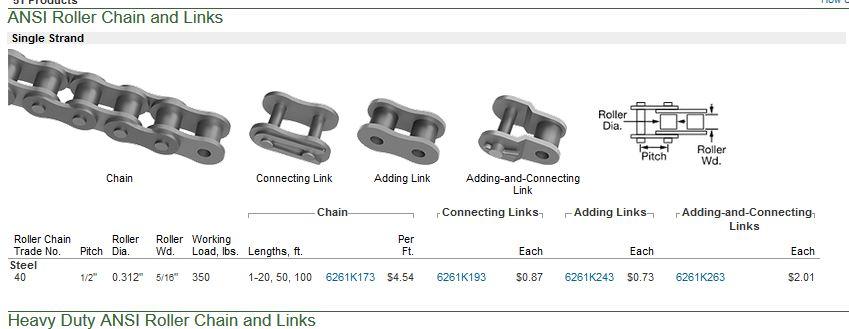

jeff lary 173 #4 Posted December 3, 2019 (edited) well this was new 2 winters ago. Also I have never seen a link like the third link or the far right link before. The adding and connecting link one. Is this the one you think I should get a couple of ? I am going to get a new master link for sure. Edited December 3, 2019 by jeff lary Share this post Link to post Share on other sites
SylvanLakeWH 32,150 #5 Posted December 3, 2019 31 minutes ago, jeff lary said: well this was new 2 winters ago. Also I have never seen a link like the third link or the far right link before. The adding and connecting link one. Is this the one you think I should get a couple of ? I am going to get a new master link for sure. I would keep a couple of each on hand - adding, connecting and master - cheap insurance... Share this post Link to post Share on other sites

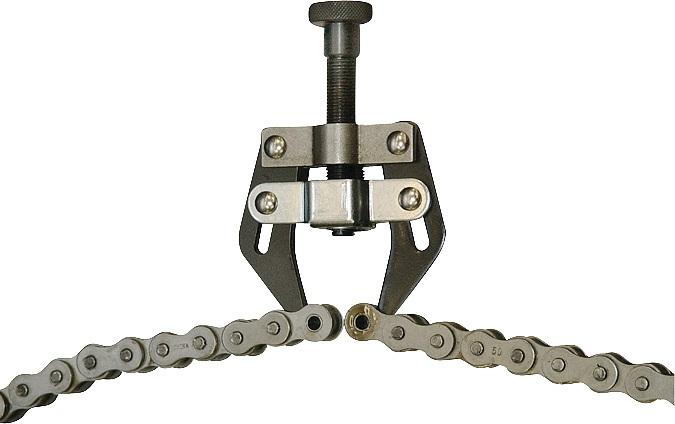

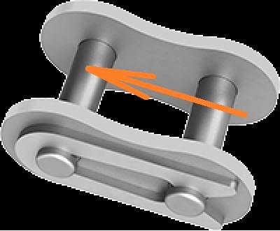

gwest_ca-(File Mod) 12,455 #9 Posted December 3, 2019 1 hour ago, jeff lary said: Without this link on the chain it measures 51 inches exact,... I wonder if that is the only thing missing? What I am wondering if a new master link is all I need? If so maybe I can find one at Tractor Supply tomorrow.,,, Blower Model 79360 Single Stage 51" should be 102 links if you measured center of the pin to center of the pin. Count them and see how much it has worn/stretched. When the 1/2" pitch increases from wear the rollers must run higher on the sprocket teeth and that is what wears out the sprockets. A new chain will put the rollers back in the bottom of the teeth where they belong for long life. You can get 10 feet of chain for a reasonable cost and get 2+ chains out of it. A roller chain tensioner is a very handy third hand for installing chain. It can also hold a length of chain installed to determine where it needs to be broken for proper length. When the U-shaped retainer is installed in the master link do so like the illustration. Arrow shows the direction of chain travel. If put in backwards a piece of ice can knock it off. Garry 3 1 Share this post Link to post Share on other sites
jeff lary 173 #10 Posted December 3, 2019 I am thinking I put the chain and sprockets on new either last Fall or the one before,... I think it was last winter. I measured from end of inner link to the other end of the other inner link. I never thought about the travel direction of the "U" clip I may have had it on facing the wrong direction maybe. The chain tensioner would be a big help but of seldom use for me anyway. I wonder where I can get one,,,, love a new tool ya know. Share this post Link to post Share on other sites
gwest_ca-(File Mod) 12,455 #11 Posted December 3, 2019 We have a supply company across Canada named Princess Auto. From what I have seen Northern Tool is similar. If they stock 10 foot lengths of chain they likely have the tensioner tool along with a tool to press the pin out when breaking a chain. Always good to have a couple of 1/2 links in case one is needed. Don't forget to back off the adjuster sprocket before selecting the chain length. Garry Share this post Link to post Share on other sites

Achto 32,347 #13 Posted December 4, 2019 3 hours ago, jeff lary said: Also I have never seen a link like the third link or the far right link before. The 3rd link is what is commonly called a half link. It is used to take up a small amount of slack when needed. A regular connector link is also required with one of these to complete the connection. Share this post Link to post Share on other sites
jeff lary 173 #14 Posted December 4, 2019 yea I like the 1/2 link idea. Share this post Link to post Share on other sites
