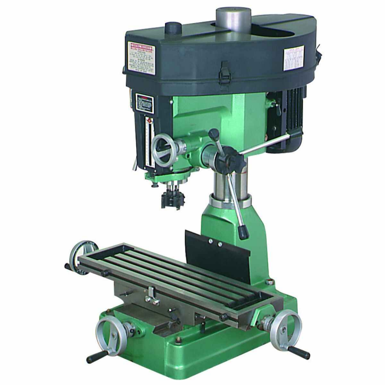

pacer 3,180 #2 Posted December 1, 2019 Myself and 3 of my 'wannabe' machinist buddies (one of whom has one) all agree that the 3in1's are --- well, not so good. The mill on the 3in1 machines that I have been around is a poor excuse to get milling done. The lathe is somewhat better but still not up to what a dedicated lathe is. Obviously the Bridgeport type mills are the first choice but can be pricey. For just general home shop milling this type mill drill below is a pretty decent option, I started out with this type and did a lot of work on it. Its draw back is that you lose your set-up when raising/lowering the column, but as you get used to it there are a lot of work arounds. This one here is from HF and is shown for $1199 (would definitely want to see if a 20% could be used!) But several other sources have similar at similar $ -- or more! 3 1 Share this post Link to post Share on other sites

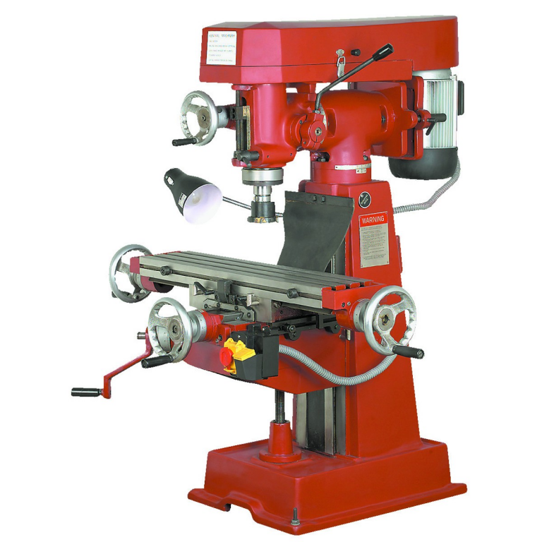

pacer 3,180 #3 Posted December 2, 2019 I remembered another mill that HF has that is pretty nice for a home shop, more pricey at $1899. A few more features similar to the Bridgeport mills - its draw back is somewhat limited room under the spindle. I also owned this mill after the mill/drill type and learned just how much a fella can do with a mill, so much so that I ended up with a Bridgeport clone --- now thats a MILL!! 1 Share this post Link to post Share on other sites

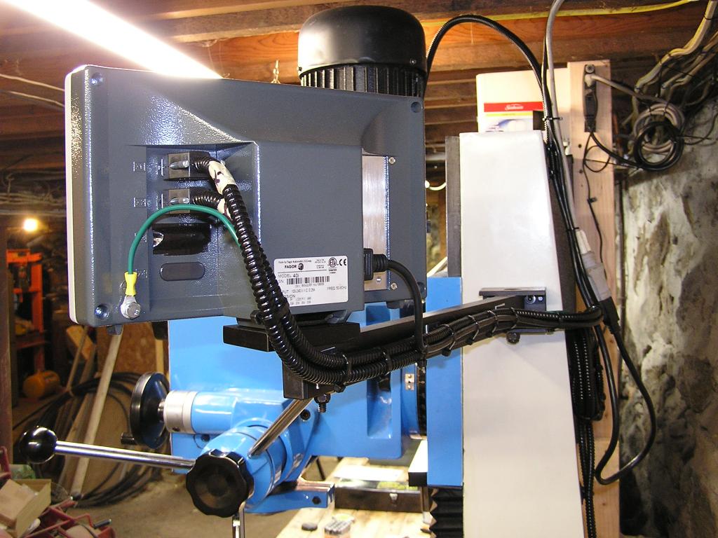

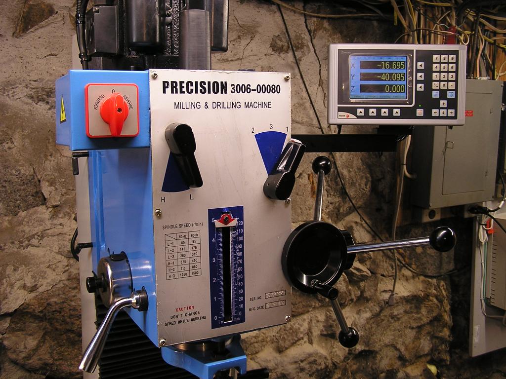

ri702bill 12,836 #6 Posted December 6, 2019 Shynon: A lot depends on how much vertical room you have and the access opening size to get it there. I wanted a traditional Bridgeport style knee machine, but bought a large benchtop machine instead. I have exactly 7 feet from basement floor to the floor above - between the floor joists. Only one model of Bridgeport is under 7 feet tall - the old style Model M - it is a 5/6 scaled down version of the J head. These have not been made for about 50 years - I was looking for a used one that was not all used up. I scored on a good deal for a new, still in the crate import 110 volt benchtop mill/drill, with the metal base and a 3 axis digital readout. It fits with the motor between the joists just fine. This has the rectangular dovetail column for the head - do NOT waste your money on a round column machine if you plan on milling with it. When you raise the head, it is free to rotate - those do not track true vertically. Check out the comments on the Littlemachineshop.com website - they have a guide to pick the correct style for the application. Also - if you add a DRO, power it thru a good surge suppressor as they are extremely sensitive to voltage surges or spikes. Bill 1 1 Share this post Link to post Share on other sites

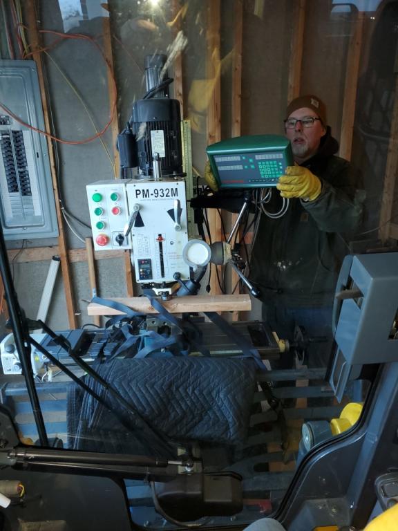

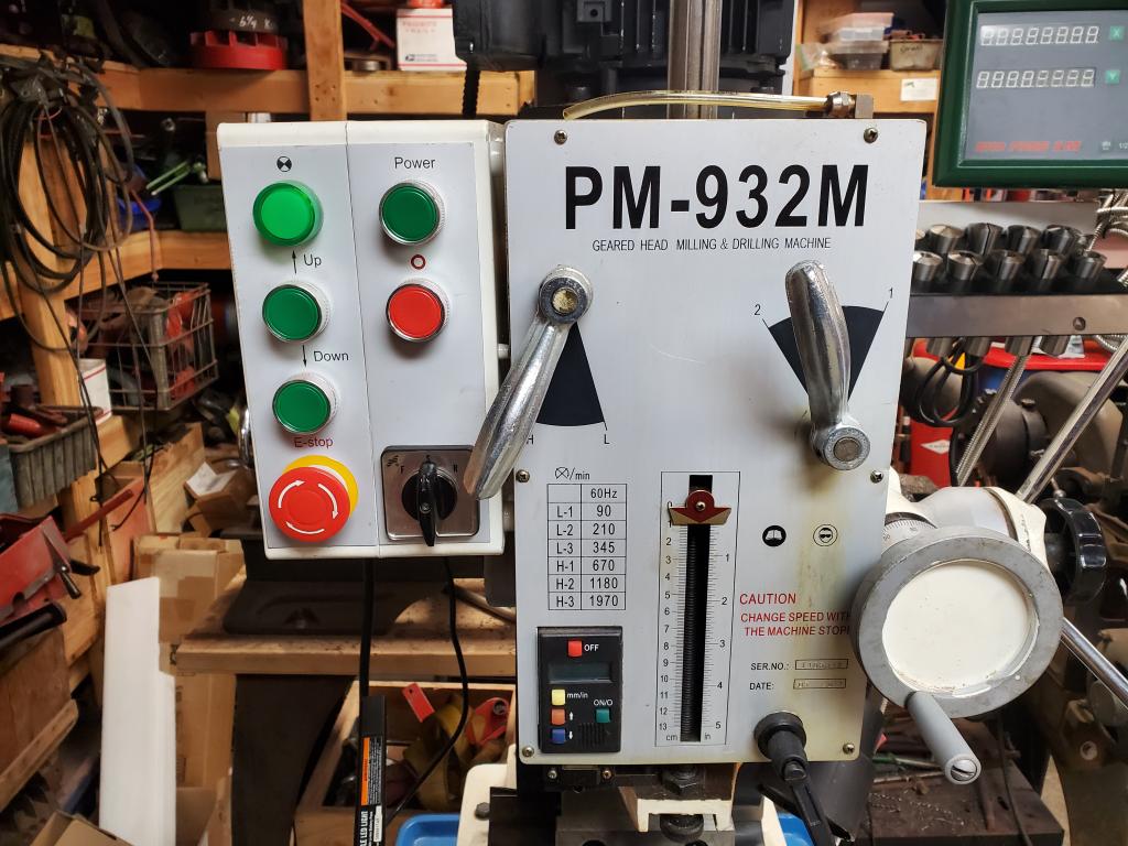

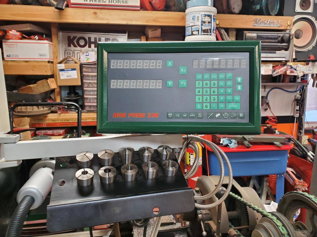

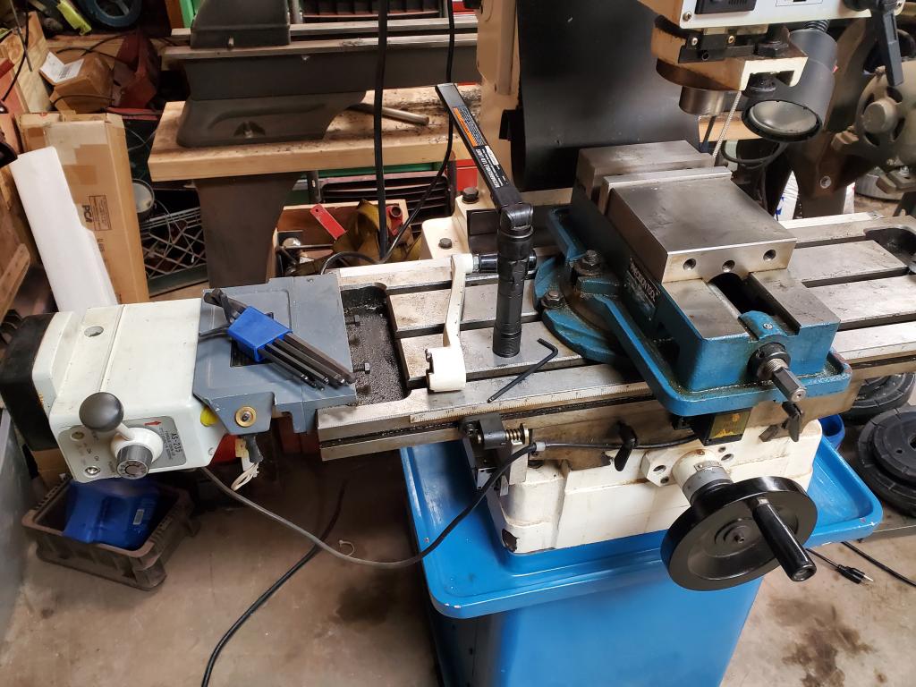

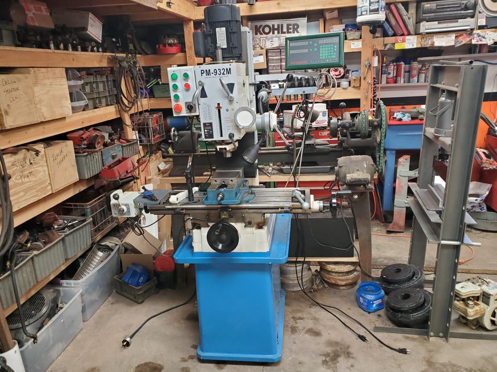

Shynon 7,646 #7 Posted January 11, 2020 So after some looking around I found this one. It's a Precision Mathews PM 932 milling machine. Had a vice,collets, DRO, power feed. Nice to have a son with a great boss that let us usd his new skid steer to move it. Now it's home in it's resting place. Pretty excited to see what I can do with it. 3 6 Share this post Link to post Share on other sites

pacer 3,180 #9 Posted January 12, 2020 Excellent!!! I have a buddy that has had that machine for some 2-3 yrs. Had a couple glitches at first but PM covered them quickly and hes loved it since. Really good machine for the home shopper without the big money for the Bridgeport, etc machines. 1 Share this post Link to post Share on other sites
bc.gold 3,406 #10 Posted January 12, 2020 (edited) The problem with Chinese equipment manufactured for the domestic market is that the patterns used for the castings to many shops have them and some take pride in their product while others cut corners. Recycled metal is often part of the furnace melt, metallurgy is no small deal, to make sure your investment is not made from scrap stove or sewer cast look for a manufacture that has an ISO certification the reference the ISO number to see if its for record keeping or quality control. The Taiwanese are well known for quality and have been producing equipment long before mainland China decided to get into the game. Edited January 12, 2020 by bcgold 1 Share this post Link to post Share on other sites
bc.gold 3,406 #11 Posted January 12, 2020 4 hours ago, Shynon said: So after some looking around I found this one. It's a Precision Mathews PM 932 milling machine. Had a vice,collets, DRO, power feed. Nice to have a son with a great boss that let us usd his new skid steer to move it. Now it's home in it's resting place. Pretty excited to see what I can do with it. Your mill is a Taiwan made machine and the castings are a step above the Chinese machines, no painted over body filler hiding a poor casting. 1 Share this post Link to post Share on other sites

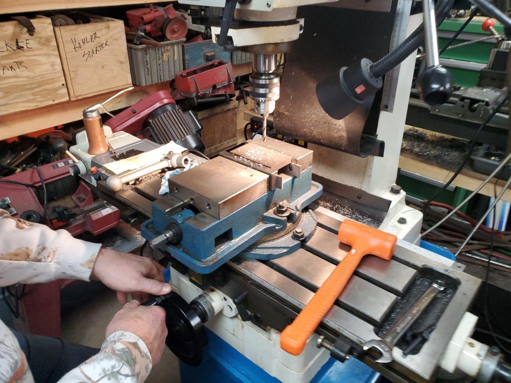

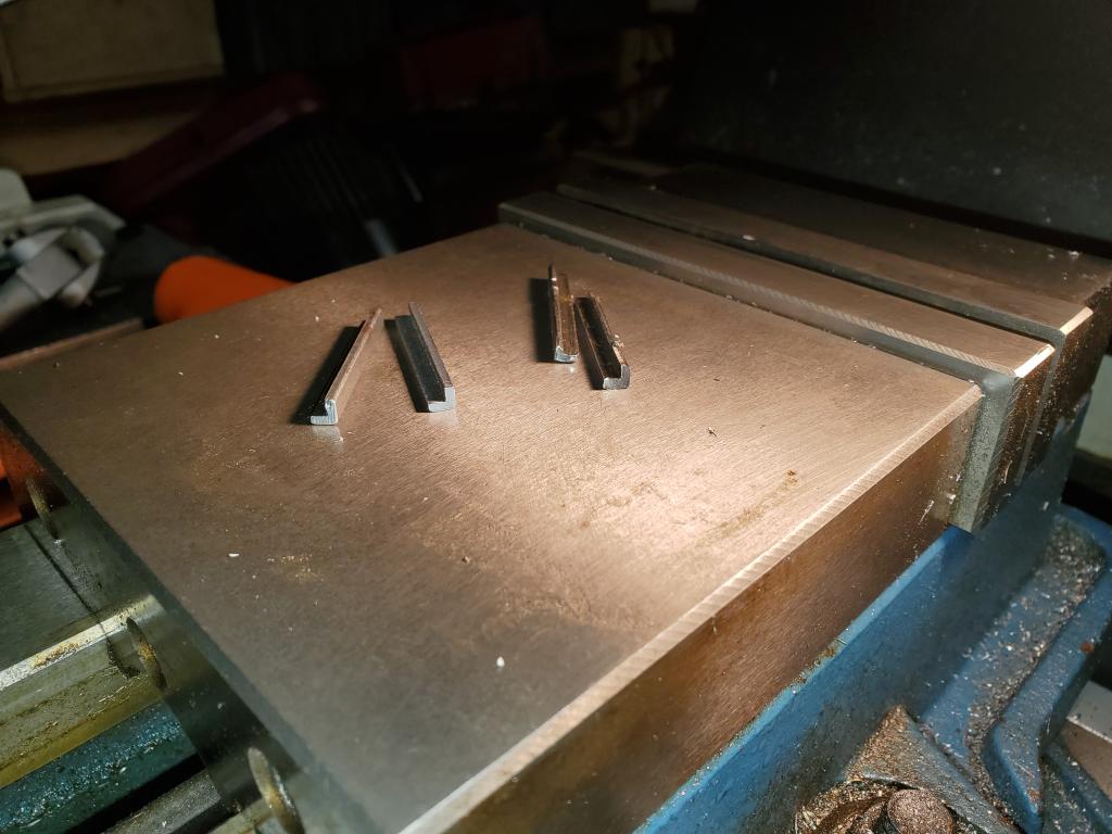

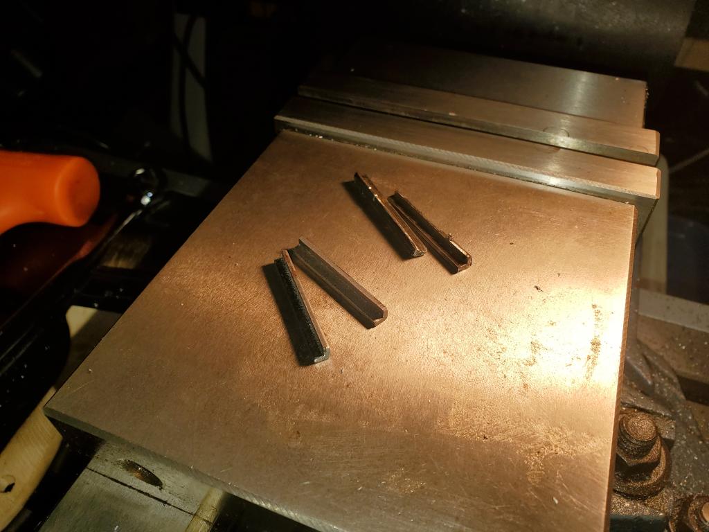

Shynon 7,646 #12 Posted January 26, 2020 (edited) 1st project on the mill, a couple L shaped keys. Edited January 26, 2020 by Shynon 1 Share this post Link to post Share on other sites

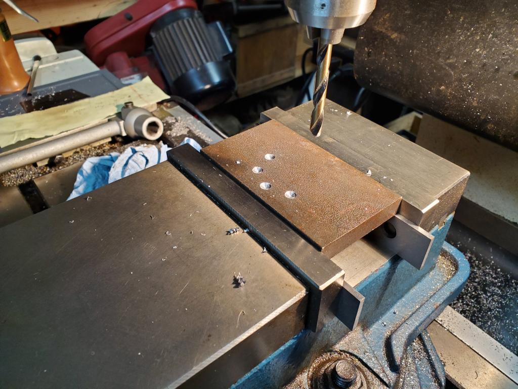

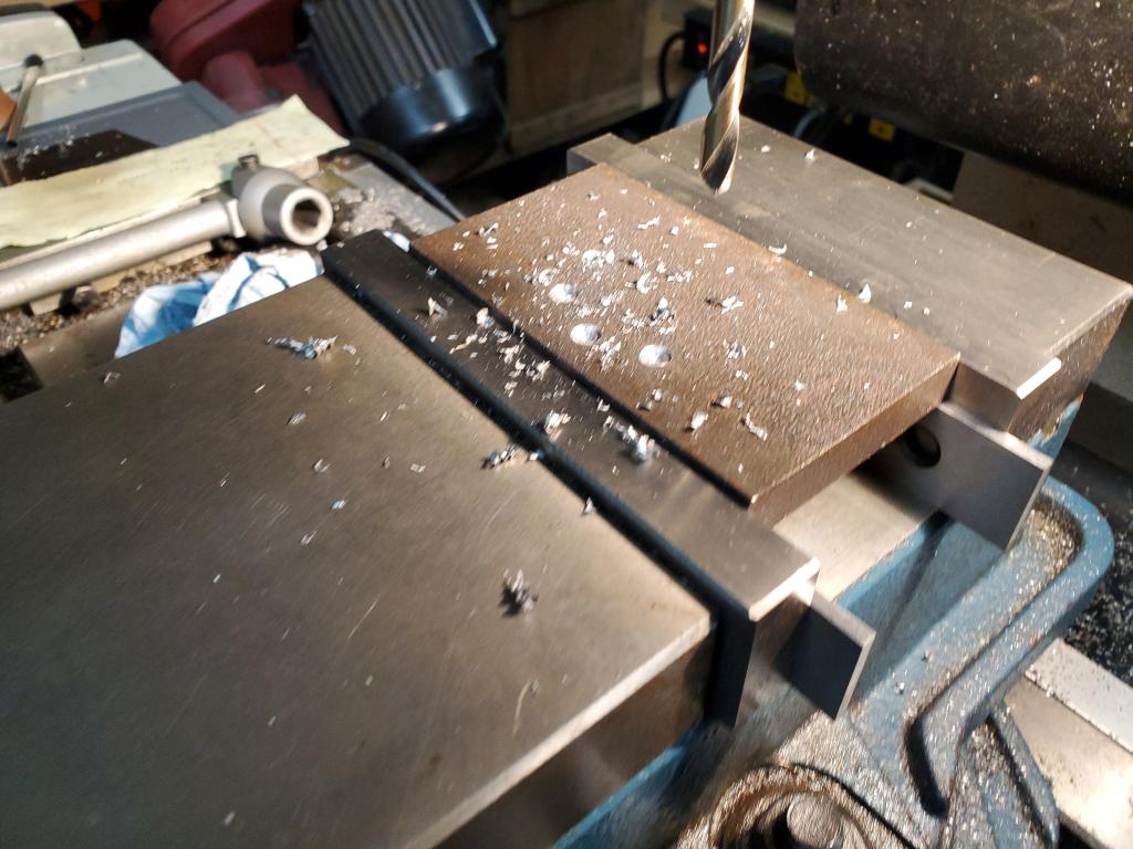

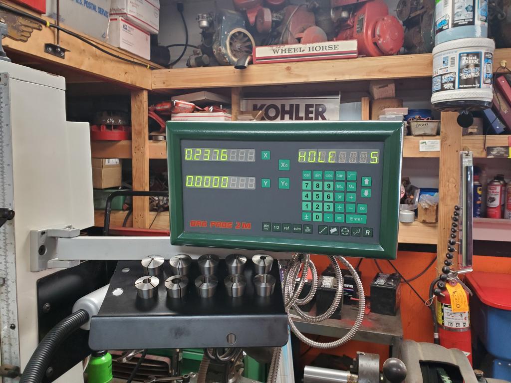

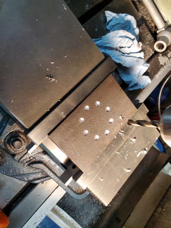

Shynon 7,646 #13 Posted January 26, 2020 Did some hole locations on the mill with use of the DRO program for holes 4 3 Share this post Link to post Share on other sites

ri702bill 12,836 #15 Posted March 15, 2020 (edited) Eric: I was looking for a good used machine when mine (pictured above) , still new in the crate became available. The key is to find one that is used, not used up. When I buy a used tool, I want to plug it in and use it on the sellers premises before I buy it. A used lathe for instance, I would show up with a piece of metal stock, cutting tool and a caliper. Take a cut and measure it in several places to see if it cuts true or tapered, then decide. Years ago back in the 1970's, I met a guy that had several rental properties and he was always in the market for a decent used electric stove to have on hand if one needed to be replaced. He would show up to the seller's house demanding to see the stove plugged in - he would bring everything needed, except the water, to bake either cookies or brownies on the spot. If everything went well, he'd buy the stove and split the baked item with the seller - if it did not go well, he would kindly back out of the sale and told the owner that they could keep the stove and the cookies! Point being - you don't buy a used car without trying it out with a trip around the block - a good used power tool should be the same. Bill Edited March 15, 2020 by ri702bill 1 Share this post Link to post Share on other sites

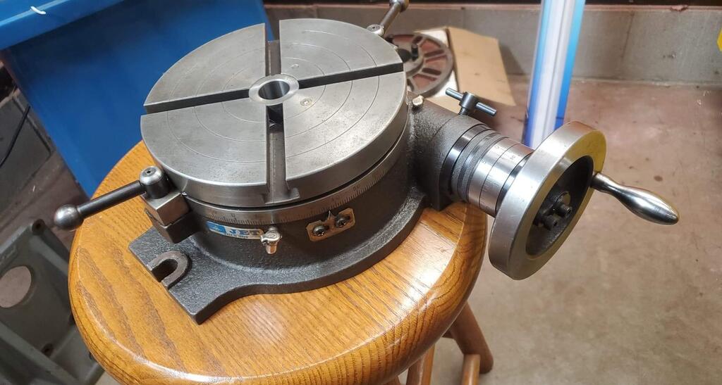

Shynon 7,646 #18 Posted October 4, 2020 Picked up a mint condition rotary table for the milling machine 2 2 Share this post Link to post Share on other sites

ri702bill 12,836 #20 Posted October 5, 2020 Good score on the Rotary Table - it certainly looks to be in great condition. MANY of the "old school" machining accessories are being sold dirt cheap as they have been replaced with modern 3 (or 4) axis computer controlled millers. I score a great condition Bridgeport Boring Head, in the case with cutters for free - the foreman in the shop was going to throw it out, no longer needed it with the CNC machines. They can take the designer's Solid Model and import it and now make parts with complex cuts in one or two setups. I see Horizontal Milling machines being sold locally for next to nothing, sometimes free if you move them yourself. Times have changed with the newer technology ...... Bill Share this post Link to post Share on other sites
