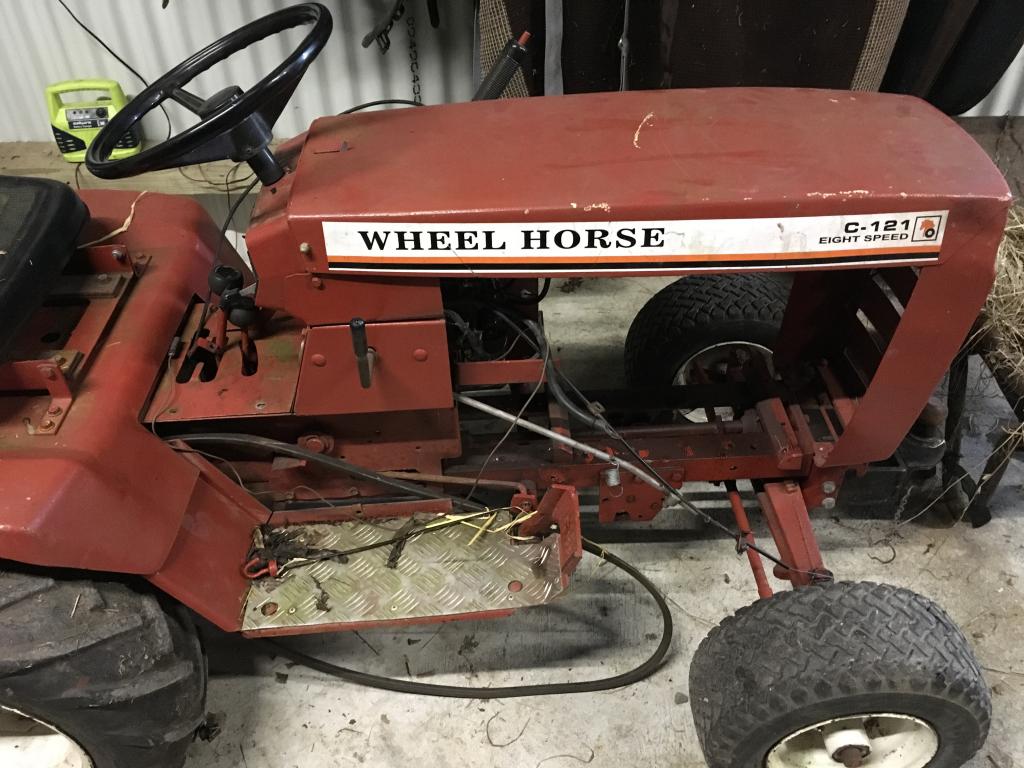

Jim1 8 #1 Posted December 1, 2019 Hi from Roscommon ,.Ireland my grandson has a c-121 ,which was running perfect ,until it stopped,we pulled the engine out today and the conrod was snapped in. About five bits,,no damage to the piston or the bore ,but I think the crankshaft will either have to be reground or replaced he’s sick over it ,it’s a great little machine with a tipping trailer and makes cleaning out his pony a lot easier for him, does anyone know a stockist/supplier this side of the pond ,? Thanks . 5 Share this post Link to post Share on other sites
Ed Kennell 43,770 #2 Posted December 1, 2019 to the Jim. I can't help with a supplier, but members from your side of the pond should be along soon with help. That is a great looking C-121 and hopefully a new .020" under rod and a crank regrind will put it back to work. Always best to give the new part to the machinist for measuring and machine other parts to match. 1 1 Share this post Link to post Share on other sites
