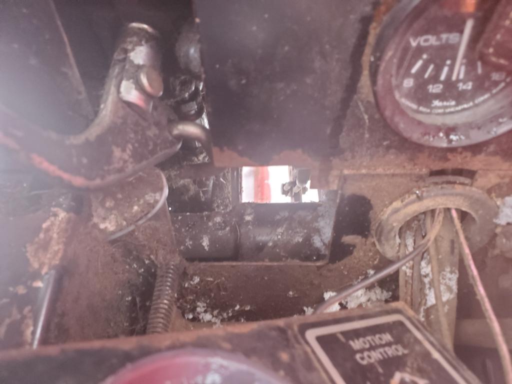

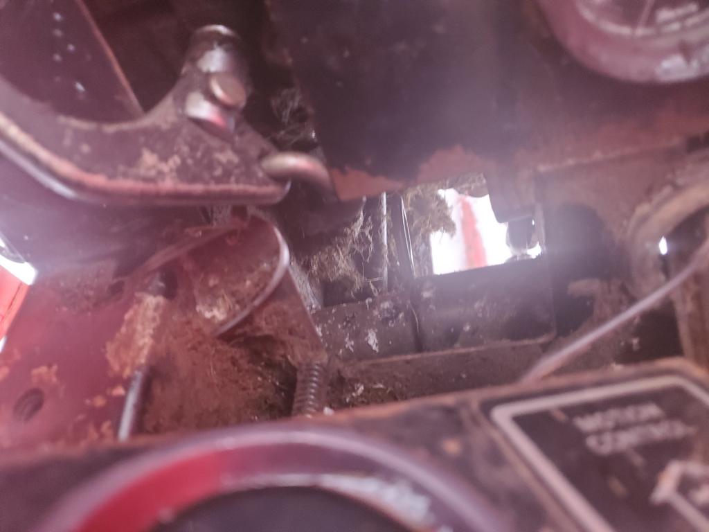

Jenna 6 #1 Posted November 30, 2019 Just finished snow blowing and was getting off my 417-A My leg hit the hydraulic lever and knocked it to the left and it some how disconnected below we're in a blizzard and I need it!! 1 Share this post Link to post Share on other sites

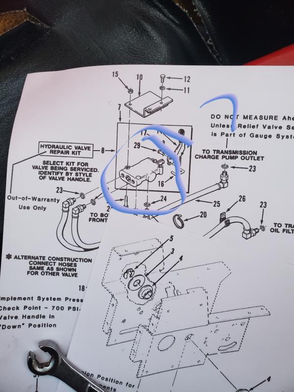

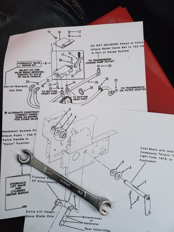

pfrederi 21,308 #2 Posted December 1, 2019 May have lost a cotter pin #17 or the clevis pin 29 1 1 Share this post Link to post Share on other sites
Jenna 6 #3 Posted December 1, 2019 So the pin 29 is sti attached and 16 into 14 is still there it's the other end that popped out it looks like I just need to slide it back in some how 2 Share this post Link to post Share on other sites
ZXT 2,402 #4 Posted December 1, 2019 (edited) 45 minutes ago, Jenna said: So the pin 29 is sti attached and 16 into 14 is still there it's the other end that popped out it looks like I just need to slide it back in some how What other end are you referring to? The piece that #29 is pinning the handle to? Pictures would definitely help! Edited December 1, 2019 by ZXT Share this post Link to post Share on other sites
gwest_ca-(File Mod) 12,535 #5 Posted December 1, 2019 It is likely the other end of #16 that came out. If you can get #17 cotter pin out then is should go back together. Push #16 to the right as far as it will go and add flat washers or shim washers to remove any slack before reinstalling #17 cotter pin. Bet that is easier said than done. Garry Share this post Link to post Share on other sites
Jenna 6 #6 Posted December 1, 2019 Where does it attach too? You're right whith what happened Share this post Link to post Share on other sites
c-series don 12,656 #9 Posted December 1, 2019 There’s a hole in the valve body casting that part 16 goes into. This has happened to me before. For now I would just put it back in and be careful not to knock it out. When the storm is over take part 16 out and drill a hole in it for a cotter pin where it goes into the valve body hole. Share this post Link to post Share on other sites
