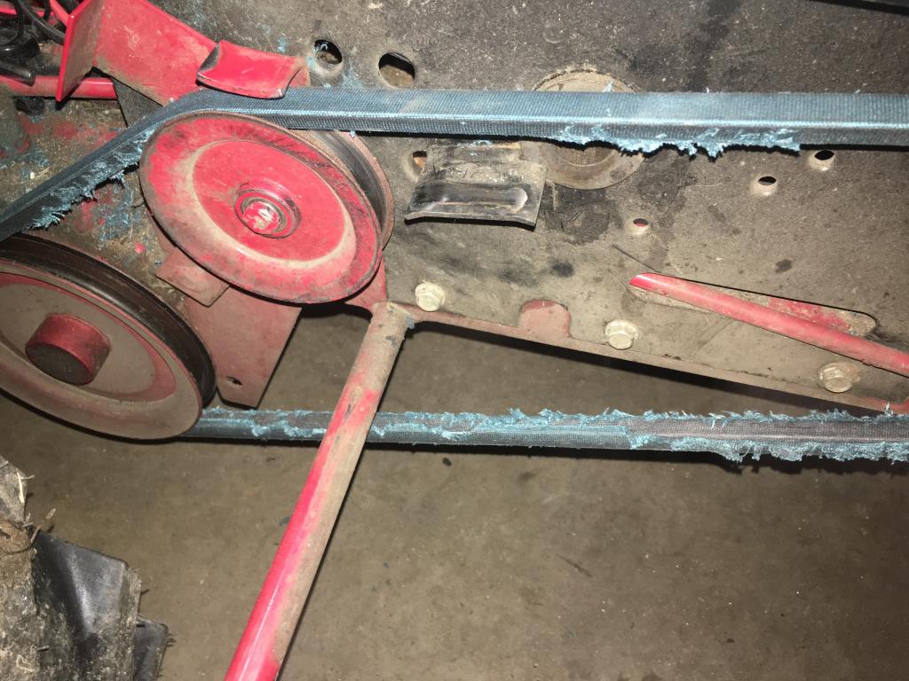

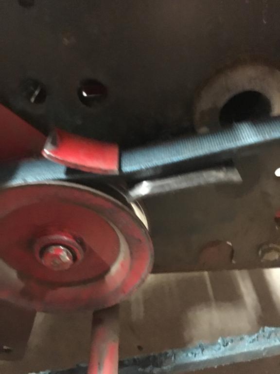

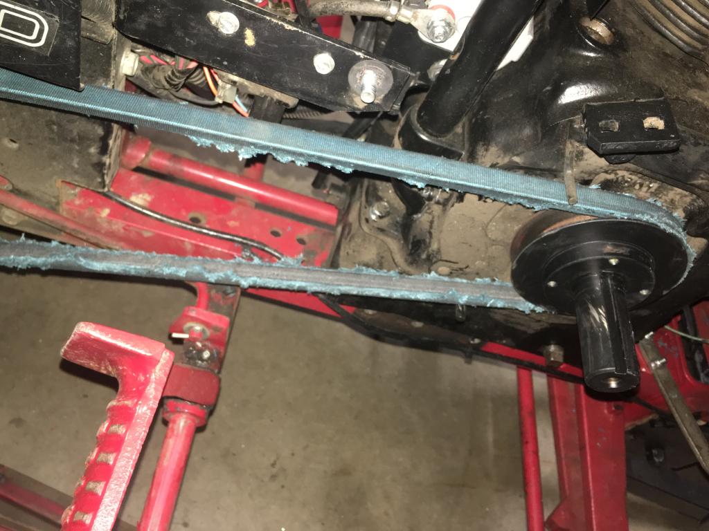

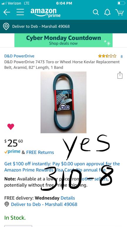

KrazeyOlDave 860 #1 Posted November 30, 2019 (edited) I just compared it to the belt I took off, it’s much shorter. Which now makes me realize that I had very little clutch movement. I also did not confirm the belt number on the package when I got it, I just assumed. Fellas, I’m pretty sure it’s just a oopsy on the belt size. —————————————————- I was toying around the yard and after about 10 minutes, my clutch stopped working. I’ve went over the install a few times and before I took off the covers, I looked too see if anything was hitting but nothing. Has anyone ever had this issue? I’m starting to think I got the wrong belt. I really don’t like how the idler pulley belt stay gets so close to that other piece you see in the pic. Edited December 1, 2019 by KrazeyOlDave Share this post Link to post Share on other sites

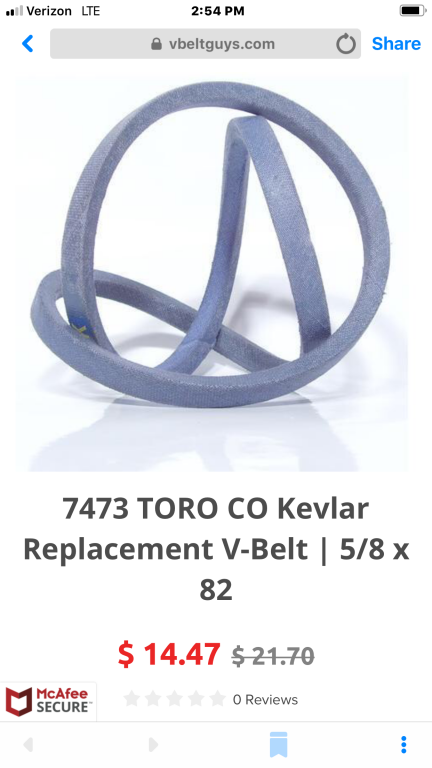

daveoman1966 3,884 #2 Posted November 30, 2019 OEM belt is 7473, Get it here for about $25. It is 82" x 5/8" https://www.psep1.biz/arinet.asp?aribrand=TO#/s/TO//7473/1/ 1 1 Share this post Link to post Share on other sites
KrazeyOlDave 860 #3 Posted November 30, 2019 So the seller has it listed wrong? Share this post Link to post Share on other sites

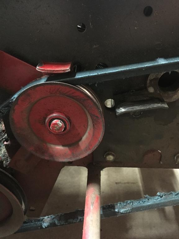

wallfish 20,549 #8 Posted December 1, 2019 (edited) Something is shredding the belt on the inside. It's definitely not that belt stop on the idler pulley but check that metal piece it pinches to for any burrs or anomalies. If the belt guard has tabs and a channel for the belt to ride in, look for the shiny spots which would indicate the belt is rubbing there. OEM or after market belt, if it's rubbing on something sharp, it will shred. How long has this belt been on? Edited December 1, 2019 by wallfish Share this post Link to post Share on other sites
tom2p 2,396 #9 Posted December 1, 2019 (edited) 20 minutes ago, KrazeyOlDave said: Yes sir, all are in excellent condition. I actually just got done going over all 3, no burrs, nothing. just wanted to make sure want to make sure it was not a bad pulley ... or whatever ... shredding the belt would not want to see the next belt destroyed (and especially an OEM belt) Edited December 1, 2019 by tom2p Share this post Link to post Share on other sites
daveoman1966 3,884 #10 Posted December 1, 2019 GUESSING HERE... Could the material fraying be caused by the engine pulley dragging slightly on the belt when in NEUTRAL (or between gears). If the belt guard isn't on correctly, the belt will not completely release from the engine pulley...causing it to drag. On the backside of the belt guard is a guide that 'catches' the belt to stop if from sagging too much so that it is held COMPLETELY out of the Engine 'V' pulley when in neutral. The back side of the belt should be above this guide. Share this post Link to post Share on other sites
KrazeyOlDave 860 #11 Posted December 1, 2019 3 minutes ago, daveoman1966 said: GUESSING HERE... Could the material fraying be caused by the engine pulley dragging slightly on the belt when in NEUTRAL (or between gears). If the belt guard isn't on correctly, the belt will not completely release from the engine pulley...causing it to drag. On the backside of the belt guard is a guide that 'catches' the belt to stop if from sagging too much so that it is held COMPLETELY out of the Engine 'V' pulley when in neutral. The back side of the belt should be above this guide. Correct, I’m good there. Share this post Link to post Share on other sites
KrazeyOlDave 860 #12 Posted December 1, 2019 26 minutes ago, wallfish said: Something is shredding the belt on the inside. It's definitely not that belt stop on the idler pulley but check that metal piece it pinches to for any burrs or anomalies. If the belt guard has tabs and a channel for the belt to ride in, look for the shiny spots which would indicate the belt is rubbing there. OEM or after market belt, if it's rubbing on something sharp, it will shred. How long has this belt been on? It’s been on for about 10 minutes. I think I found the problem tho...it’s substantially shorter than the one I took off. I don’t think it’s 82”. Share this post Link to post Share on other sites

gwest_ca-(File Mod) 12,478 #14 Posted December 1, 2019 Both of the D&D screen shots above should be the same 7473 belt but one is $5 less. The original Toro parts lists may be shared with the hydro transmission model which uses a 108501 belt - 5/8" x 81.5" That may be where the mistake is but hard to believe that little difference would cause the problem. Aftermarket belts only come in even inch sizes so many of us should have problems with belt lengths and don't. If you go to Gates they replace both the 7473 and 108501 with their 6982 - 5/8" x 82" If the clutch pedal was held down when the belt guard was put back on the belt likely ended up outside the guard. It has to be inside the guard. Garry 1 Share this post Link to post Share on other sites
Sparky-(Admin) 26,262 #15 Posted December 1, 2019 13 minutes ago, gwest_ca said: If the clutch pedal was held down when the belt guard was put back on the belt likely ended up outside the guard. It has to be inside the guard. I agree. I brought home a tractor once where the belt was on the outside of the lower part of the belt guard. I’ve also seen where the lower part of the belt guard is bent “up”, possibly from running over something, and was rubbing on the belt. Share this post Link to post Share on other sites
peter lena 10,030 #16 Posted December 1, 2019 i agree with , too small a belt , the lower belt drive fraying , varifys that . i have bought belts from , d/d matching the size numbers for an exact fit. that belt has to have a lesser tension drive point , that is maintained with the rear pulley tension spring. that allows the belt to " float " when not engaged . that 82x 5/8 " is correct for that drive, pete Share this post Link to post Share on other sites

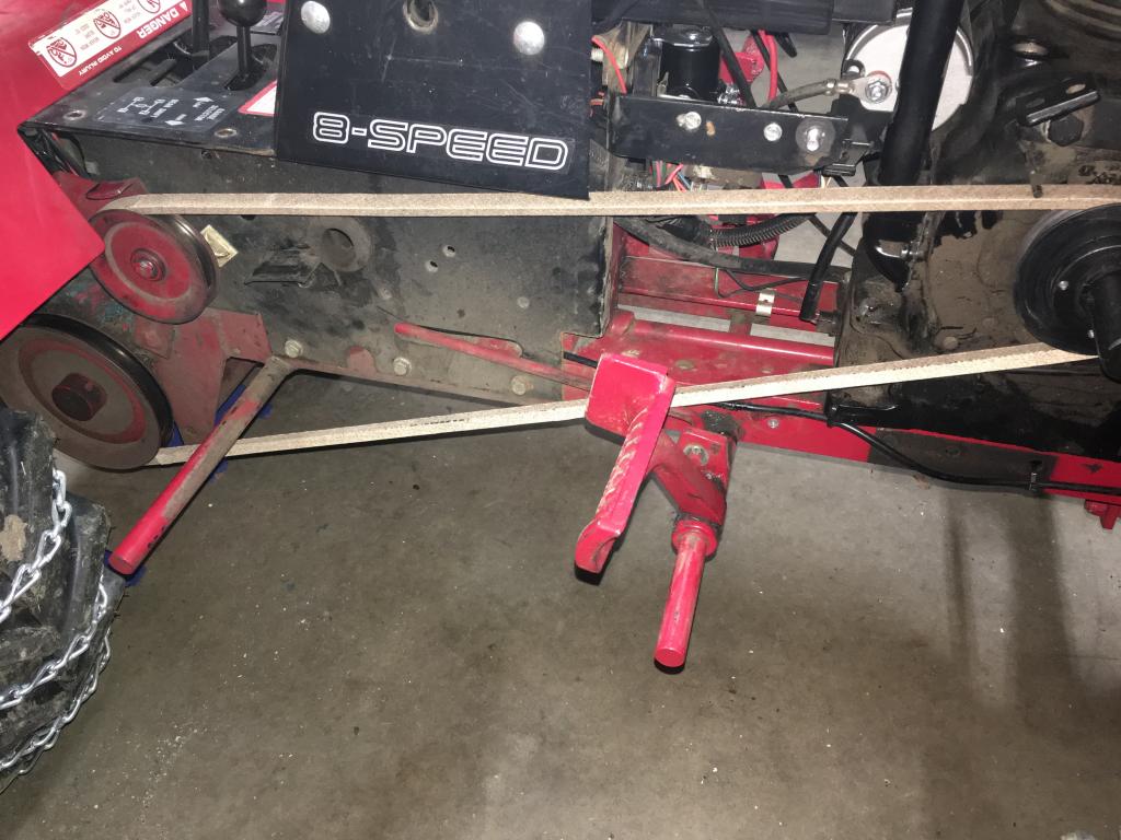

KrazeyOlDave 860 #19 Posted December 6, 2019 Got the new belt today, what a difference! My new belt Share this post Link to post Share on other sites
Burnerman 759 #20 Posted December 7, 2019 I was just thinking about my drive belt when I was plowing the other day. I’ve beat the snot out of my 78 c101 plowing and mowed a lot in the 15+ yrs of owning it and have had zero belt issues with genuine Wheelhorse branded belts. I put a new one on 10 yrs ago just because I figured it was due. I kept the old belt as a spare as it is in great condition. I’ve used a couple of D&D belts and I’m not impressed. I used one for my mower deck and got blue dust all over. The belts are “dry” it seems. The one we used on my sons B85 did the same as yours. There’s no rubbery give in the outer coating of the blue belts I think as compared to the Wheelhorse belts. The clutch pinch stop tears it up. 1 Share this post Link to post Share on other sites
