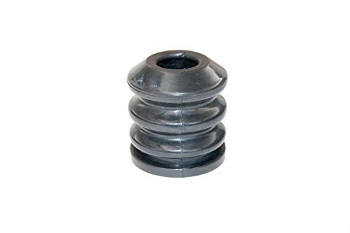

balconio 606 #3 Posted December 2, 2019 On 11/29/2019 at 10:18 PM, tom2p said: nice find ! btw - ensure rans dipstick is oriented correctly and the one seat support spring does not contact the top of the dipstick thx man- i have a solution to replace those seat springs which involves cutting down some rubber seat "springs" from a Deere tractor. also a cheep amazon score: https://www.amazon.com/gp/product/B07HCTCNM9 1 Share this post Link to post Share on other sites

balconio 606 #5 Posted August 29, 2021 Yeah, the rubber deals were way too stiff so I kept the coil springs. I tried drilling holes to see if Swiss cheesing them would soften things up but not even a bit. Oh well. The seat struts are still working great though! 1 Share this post Link to post Share on other sites
