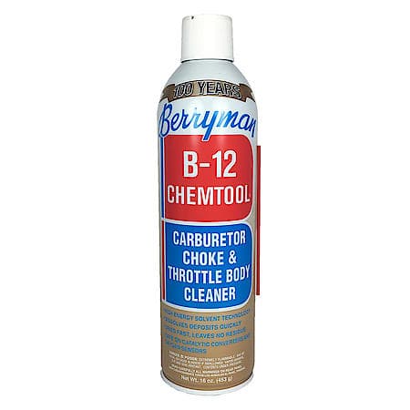

balconio 606 #5 Posted December 2, 2019 what do you guys like for carb cleaner? i've used a bunch of different brands but i think Berryman's B-12 chemtool works the best and it's what i've stuck with for years. my honda GX motors seem to have very finicky carbs- and usually a shot of this stuff will clear out what ails them... https://shop.advanceautoparts.com/p/berryman-b-12-chemtool-carburetor-choke-and-throttle-body-cleaner-16-fl.-oz.-not-voc-compliant-in-some-states-0117/11289459-p Share this post Link to post Share on other sites
