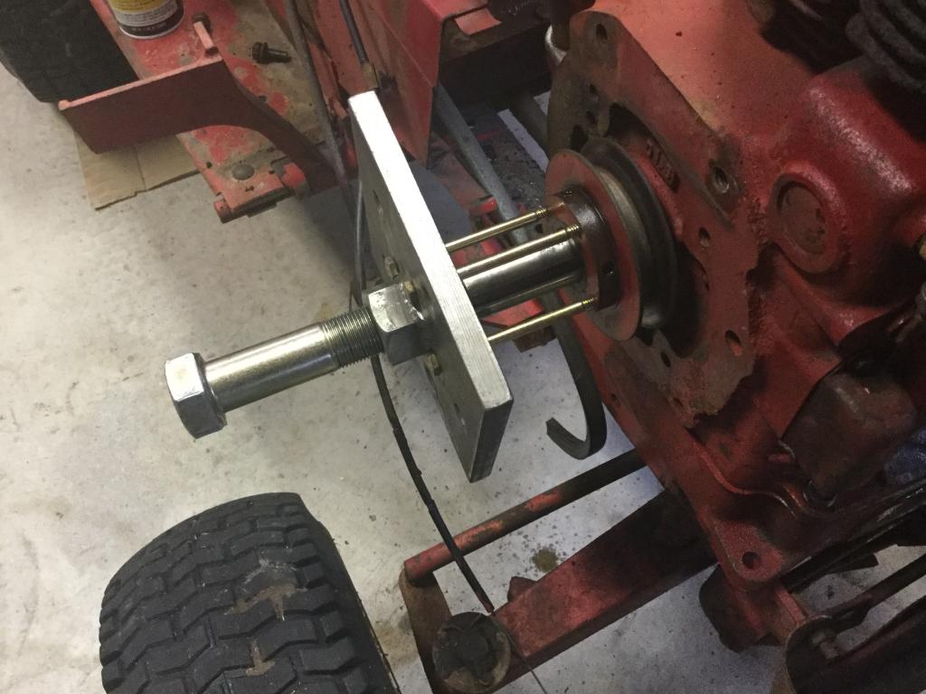

richmondred01 2,393 #1 Posted November 28, 2019 This makes life much easier. No concerns about breaking the cast iron. 4 8 Share this post Link to post Share on other sites
troutbum70 858 #2 Posted November 28, 2019 Can you use the same puller on the hubs? Share this post Link to post Share on other sites
richmondred01 2,393 #3 Posted November 28, 2019 (edited) Yep. outer holes for the hubs. Works like a dream. Edited November 28, 2019 by richmondred01 Share this post Link to post Share on other sites
troutbum70 858 #4 Posted November 28, 2019 I have one similar for the hubs. Share this post Link to post Share on other sites
ebinmaine 81,035 #5 Posted November 28, 2019 I use an old hub and bolts to pull hubs. The above puller is a lovely idea. Thanks for posting. Share this post Link to post Share on other sites
SylvanLakeWH 32,759 #6 Posted November 28, 2019 Very cool design! Share this post Link to post Share on other sites
richmondred01 2,393 #7 Posted November 28, 2019 I get no credit for the design. I bought it from a forum member. I've used it several times but always forgot to take a picture. 2 Share this post Link to post Share on other sites
squonk 48,278 #8 Posted November 28, 2019 For those who want to build their own. Notice the fine thread bolt. Increases the pulling power. Also makes it easier to turn the bolt. 2 1 Share this post Link to post Share on other sites
peter lena 10,101 #9 Posted November 28, 2019 thats the same solid pulling idea that i just replied to on the steering wheel removal. those cast pulleys are strong but fragile , when you use the correct tool , it moves easily , pete 1 Share this post Link to post Share on other sites
tom2p 2,396 #10 Posted November 28, 2019 I have vintage proto pullers they work well - but can also destroy pulley Share this post Link to post Share on other sites
