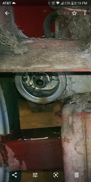

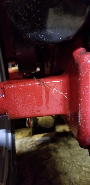

BrianX128 115 #1 Posted November 27, 2019 Ever since I bought my 417A I thought my rear axle looked wet, but when I tried to add a little fluid to have it be right at full I spilled some and that's always fun to get cleaned off so I just figured it was from that. Turns out it isn't and it's leaking from the filter mating surface. I'm guessing it's just a bad filter / gasket, and at this point want to just get a new one and put new fluid in it to be safe. I've been doing some reading online, and I know it's just 10w30 motor oil, but I've seen differing reviews of whether to use synthetic or not, and what filters to actually get to put on there. This filter looks rather old. I'm going to wait to spin it off and do this until I get new parts, but it's for sure from the mating surface between filter and base so at least that's better than a line leaking. Every time I wiped it off it would start dripping directly from the bottom of the filter. Share this post Link to post Share on other sites

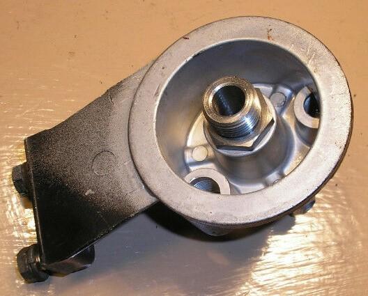

peter lena 10,103 #2 Posted November 27, 2019 all it is , is a machined seal surface and a flat o ring , should be easy , glad you stayed after it , pete Share this post Link to post Share on other sites

lynnmor 9,064 #4 Posted November 28, 2019 1 hour ago, peter lena said: all it is , is a machined seal surface and a flat o ring , should be easy , glad you stayed after it , pete I think you will find that the surface is not machined and is just the die cast surface. Share this post Link to post Share on other sites

ZXT 2,402 #7 Posted November 28, 2019 45 minutes ago, lynnmor said: I think you will find that the surface is not machined and is just the die cast surface. I've never seen a oil filter sealing surface that wasn't a machined surface. It would leak like crazy if it was die-cast. Inspect the surface when you get the filter off. It's apparent that someone chiseled the filter off of my GT-14 when they couldn't get it off with a filter wrench and they boogered up part of the sealing surface. Luckily they didn't go all the way across the surface. Hopefully someone didn't do the same on yours. 1 Share this post Link to post Share on other sites

WVHillbilly520H 10,379 #9 Posted November 28, 2019 15 minutes ago, ZXT said: I've never seen a oil filter sealing surface that wasn't a machined surface. It would leak like crazy if it was die-cast. I'm sure it is die cast and that it may be machined but I can't remember off hand... Here's a pic of one of my 520s that I saved 3 years ago... Share this post Link to post Share on other sites
ZXT 2,402 #10 Posted November 28, 2019 1 minute ago, WVHillbilly520H said: I'm sure it is die cast and that it may be machined but I can't remember off hand... Here's a pic of one of my 520s that I saved 3 years ago... It's been machined. You can feel the difference between the sealing surface and the rest of the case. It's not near as rough. 16 minutes ago, JCM said: I am also a Castrol fan and the only reason I chose the Valvoline is because it is the only oil i have used in the 86 chevy K-20 since new and now with 104000 miles the engine runs the same now as it did the day I drove it home from the dealership and that engine still runs flawlessly and has never been apart. I also only run either Castrol or Valvoline. I generally choose whichever is cheapest at the time. Great results out of both. I won't run anything else.. especially Pennzoil! 1 Share this post Link to post Share on other sites

lynnmor 9,064 #13 Posted November 28, 2019 They are not machined. 1 Share this post Link to post Share on other sites
BrianX128 115 #14 Posted November 28, 2019 Well it turns out it was actually leaking from the connection for the top hose going into it. I got an 11/16 wrench on the nut and was able to turn it 3/4 of a turn and the leak appears to have stopped. I'm still going to put a new filter on and change the oil. 1 Share this post Link to post Share on other sites
