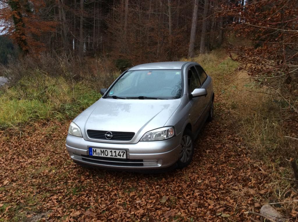

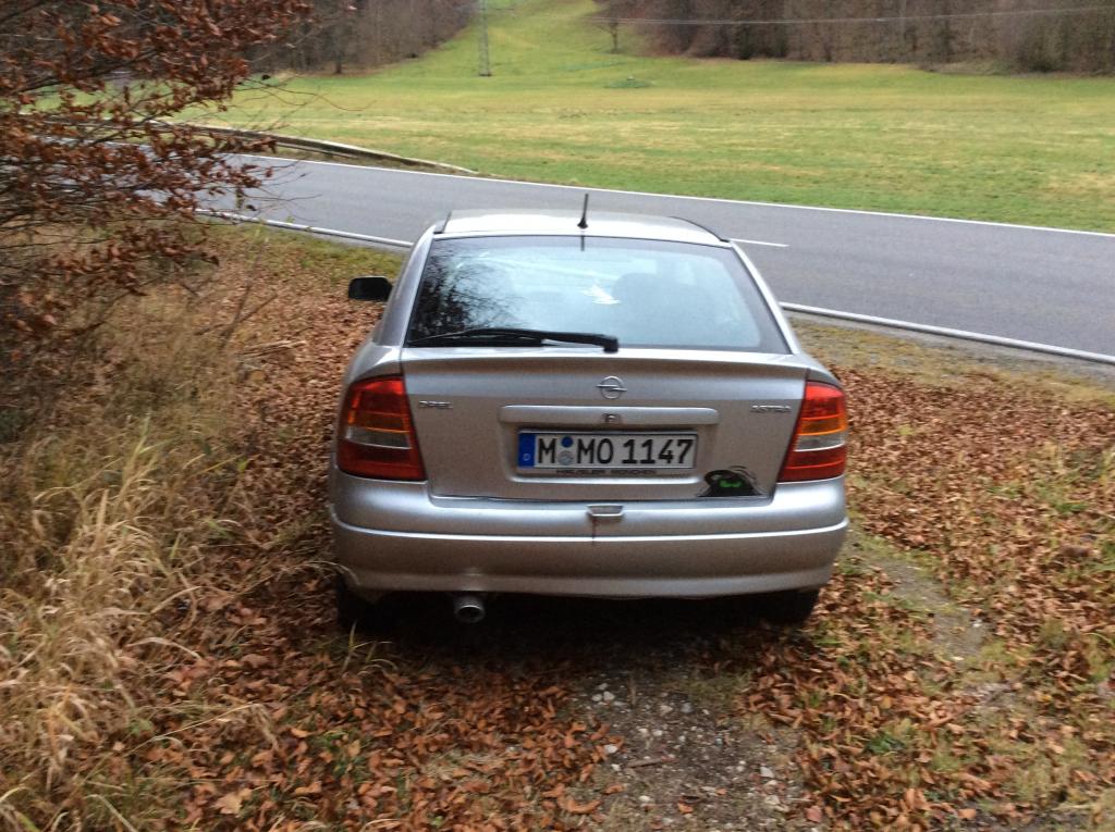

Tractorhead 9,214 #12 Posted November 29, 2019 Ok, it is the same as „The White“, just in Silver and a bit better in shape at the body than the previous as far as i can see for now. 😎 After pickup today, i did firstly clamp laptop onto and checked curious what‘s state it has. Engine control module - no errors Airbag control modules - no errors Body control module - 2 errors Readout errorcodes - just 2 1. central lock system - second key not Programmed 2. central lock system - primary Key unreadable code. change of the battery in the first key transponder and reprogramming of the second key solved that for now. - no more errors switch to live diagnosis and did a testdrive. found another 4 issues, Servo pump squeezes a bit - ok, maybe check oil level, if it has a problem with the pump, i had one in spare so that can be solved. light knock whilst playing on the steering wheel - maybe trackrods or tie rod ends, also here unused new parts in spare. brakes work but light wobble on the pedal - known issue on that car at older brakediscs, they will be changed next time, together with the bricks. A undefined „whistle“ at full throttle - horrible sound, but just if i hit pedal to the metal... 😱 hoped no troubles with Engine, haaaaahaha, PO installed an fake turbo pipe in the exhaust. Removed that thing - issue solved.🤪 all in all not bad for such a cheap thing. i know, there must be something be done at such cheap car to it, but it looks better in shape as i thought. After removing the fake turbo, the engine run‘s smooth and similar to mine, but with bit less punch. may i have to check and „ upgrade“ the injection map to my personal setup. I‘ll think this can be a begin for a longer friendship. 1 1 1 Share this post Link to post Share on other sites
