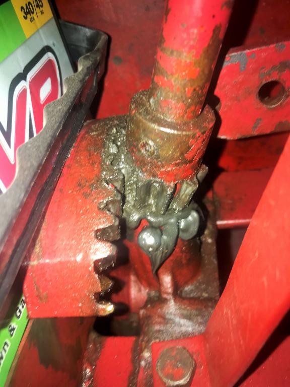

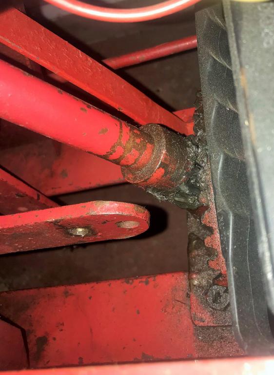

XLT 13 #1 Posted November 26, 2019 Think that's what it's called anyway... cracked at both mounting points. PO tried to weld one side... I rewelded botth sides, but they both cracked pretty quickly. Is this piece cast iron or something? Anyway, what years would fit this, if there are any others? Looks like I need to find one,. Share this post Link to post Share on other sites

prondzy 3,891 #3 Posted November 26, 2019 If you have a true 701 and the correct steering block/fan gear, it is i one year only, one model only steering block/gear, hard to find. That being said you could install a 702 block and gear and it would work 2 Share this post Link to post Share on other sites
Pullstart 71,520 #4 Posted November 26, 2019 29 minutes ago, prondzy said: If you have a true 701 and the correct steering block/fan gear, it is i one year only, one model only steering block/gear, hard to find. That being said you could install a 702 block and gear and it would work I’ve heard it’s different. Have you any photographs to show the difference? Share this post Link to post Share on other sites

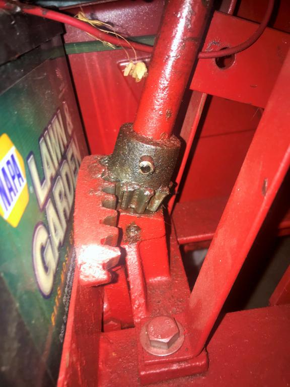

Lane Ranger 12,161 #5 Posted November 26, 2019 Here are some pics of my 701 and a 702 Steering Block and Fan Gear . They are different and the 701 is unique to the 1961 701 tractor. First two pics of 701 Third pic of the 702 3 Share this post Link to post Share on other sites
XLT 13 #6 Posted November 27, 2019 Yeah, 702 looks a little beefier in the key area. Is it steel? Or is it cast iron? Share this post Link to post Share on other sites
