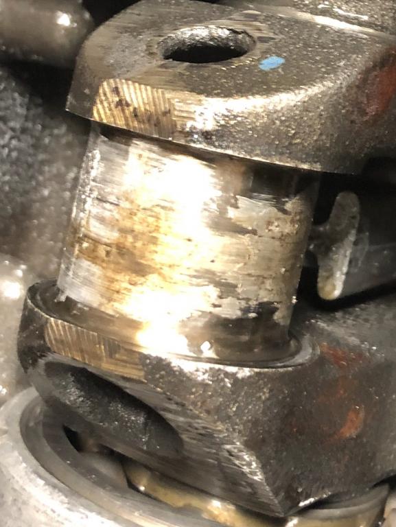

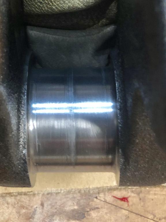

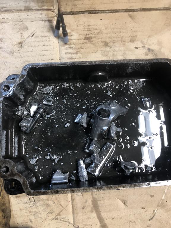

The Tuul Crib 7,354 #18 Posted November 28, 2019 (edited) Well I thought about starting a new thread for this one but I figured the heading was fine because now it's the end exclamation! Well at least for now. I had a catastrophic event yesterday with the motor running. Sounded good for the longest time then all of a sudden I heard a big clunk followed by slow slow turning of the fly wheel. I knew right away what had happened! But lo and behold I do believe the block is OK Pictures are worth 1000 words ! Or should I say 1000 pieces ! Edited November 28, 2019 by The Tool Crib 1 4 Share this post Link to post Share on other sites

The Tuul Crib 7,354 #22 Posted November 28, 2019 Not really sure I was told maybe the rod Was on backwards or in proper torque on the rod cap. Oil starvation. I did put the crank on the lathe and cleaned it up . Probably have to put a mic on it to see If it is still within spec. 2 Share this post Link to post Share on other sites
richmondred01 2,372 #23 Posted November 28, 2019 (edited) At minimum that will need to be polished. Most likely turned. hole in rod cap faces the cam. How does the cylinder apron look. Many times when the rod breaks like that it cracks or chips the apron. Edited November 28, 2019 by richmondred01 2 1 Share this post Link to post Share on other sites
The Tuul Crib 7,354 #24 Posted November 28, 2019 At a glance l havent found any damage. I might have gotten lucky on this one . I think the ghost of lRV is with me for sure! 1 Share this post Link to post Share on other sites
