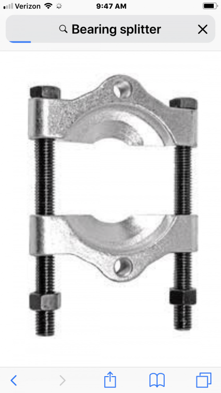

gwest_ca-(File Mod) 12,535 #5 Posted November 25, 2019 See if you can slip a bearing splitter around the wheel below the hub. Then use a puller to pull the bearing splitter. Garry 1 Share this post Link to post Share on other sites
oliver2-44 11,820 #6 Posted November 25, 2019 6 minutes ago, gwest_ca said: See if you can slip a bearing splitter around the wheel below the hub. Then use a puller to pull the bearing splitter. Garry As stated above and you may have to find some washers to split to put under the hub so they contact the metal part of the hub. You don’t want your bearing splitter pulling on the bottom plastic ring of the steering wheel Share this post Link to post Share on other sites
The Tuul Crib 7,354 #7 Posted November 25, 2019 One like this I believe is what you're talking about 1 Share this post Link to post Share on other sites

pacer 3,181 #10 Posted November 25, 2019 That puller tool crib shows is by far THE best one to pull a splined or keyed wheel (generally called a 'clam shell' puller) Put the flat side under the wheel and if possible use an impact wrench. If not popped loose after a good bit of force take the trusty ole hammer and whack the end of the puller, this will usually do it. Good ole HF has that puller in a set - iots the one I've got and I've used the honk out of it, good tool to have around the shop for other things also........ Share this post Link to post Share on other sites

WHNJ701 4,173 #13 Posted November 25, 2019 2 hours ago, The Tool Crib said: One like this I believe is what you're talking about this works great, it's a must have. sometimes they won't come off, some I already cut with the dremel if I wasn't saving the wheel Share this post Link to post Share on other sites

squonk 48,337 #18 Posted November 26, 2019 17 hours ago, The Tool Crib said: One like this I believe is what you're talking about A small bearing splitter backed up by a big bearing splitter. A big honkin gear puller on the big splitter and a 24" crescent wrench turning the puller screw. Share this post Link to post Share on other sites
