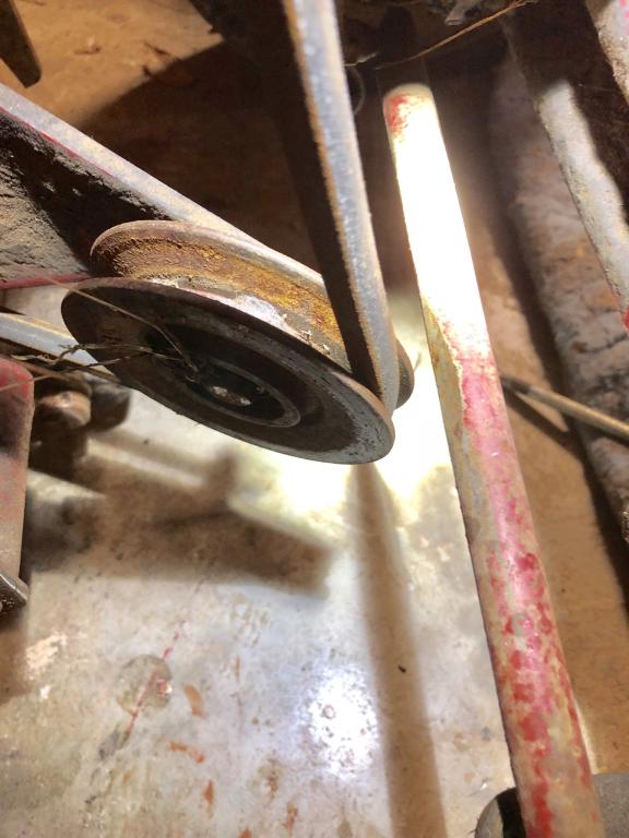

The Tuul Crib 7,354 #1 Posted November 24, 2019 On this charger 10 that I just got I'm sitting here looking at the tire rod and noticed there was a bit of rubbing going on. Is there any adjustment to fix this ? Share this post Link to post Share on other sites
peter lena 10,091 #2 Posted November 24, 2019 not sure what you have there but i would guess the belt is too long, someone with a charger will be along to correctly answer your question, pete Share this post Link to post Share on other sites
Ed Kennell 47,612 #3 Posted November 24, 2019 That is the fixed idler pulley. A shorter belt would not change its location Pete. The pulley bracket may have been moved forward by the PO for some reason. Possibly to gain tension to use an incorrect too long belt. Look for additional holes in the frame or pulley bracket to determine if it was moved . 4 Share this post Link to post Share on other sites
Ed Kennell 47,612 #4 Posted November 24, 2019 I looked at your pic again and the pully may have been replaced with a too large dia. pulley. 1 Share this post Link to post Share on other sites
troutbum70 858 #5 Posted November 25, 2019 My thought also pulley has been replaced with a larger pulley. Share this post Link to post Share on other sites
The Tuul Crib 7,354 #6 Posted November 25, 2019 Thanx ! Im going to check the part number and see if its the correct one Dont know much about this tractor as it was from an estate sale five min away. Share this post Link to post Share on other sites
gwest_ca-(File Mod) 12,511 #7 Posted November 25, 2019 All I have on the 4974 pulley is that it replaced 4458. Garry 1 Share this post Link to post Share on other sites
