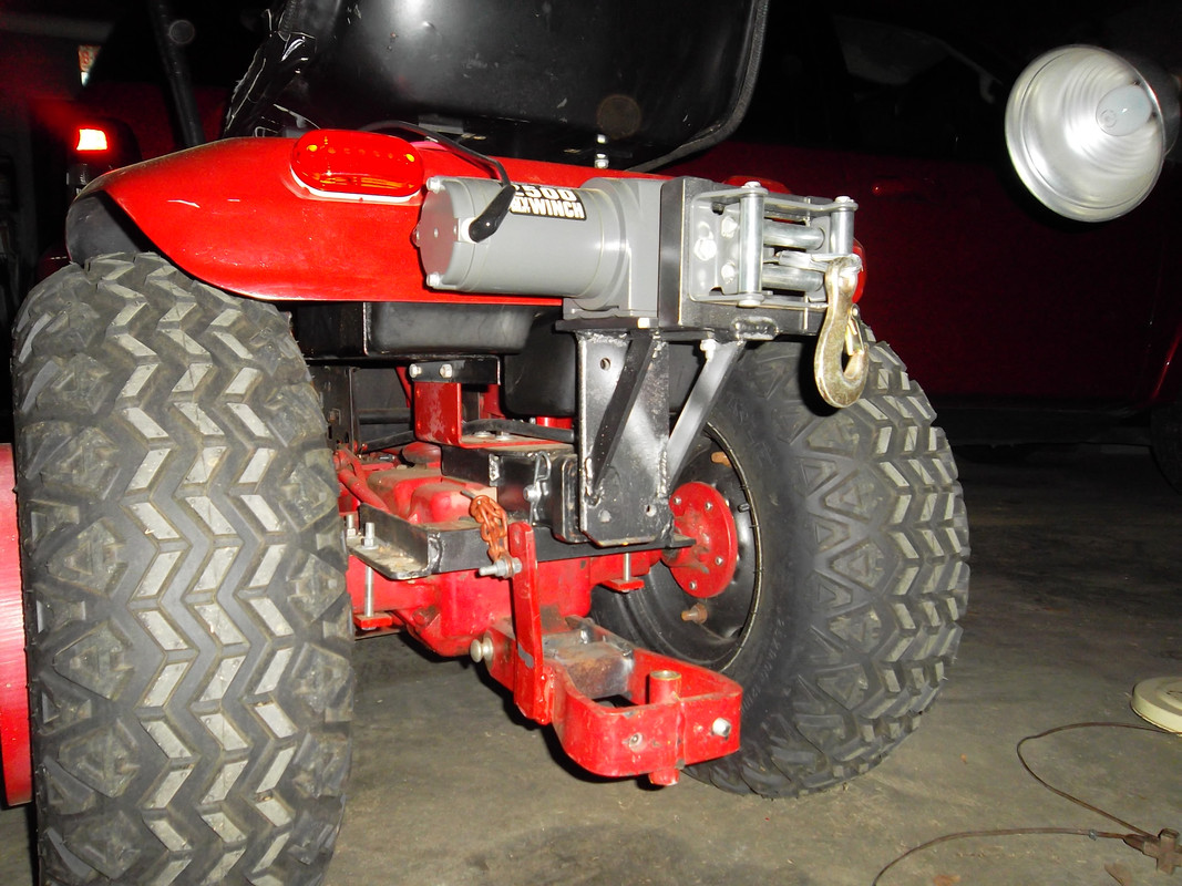

Lee1977 7,805 #3 Posted November 25, 2019 My rear wench is mounted in a receiver hitch. The Tractor is also modified with 25" rear tires and raised fender pan. 2 Share this post Link to post Share on other sites
