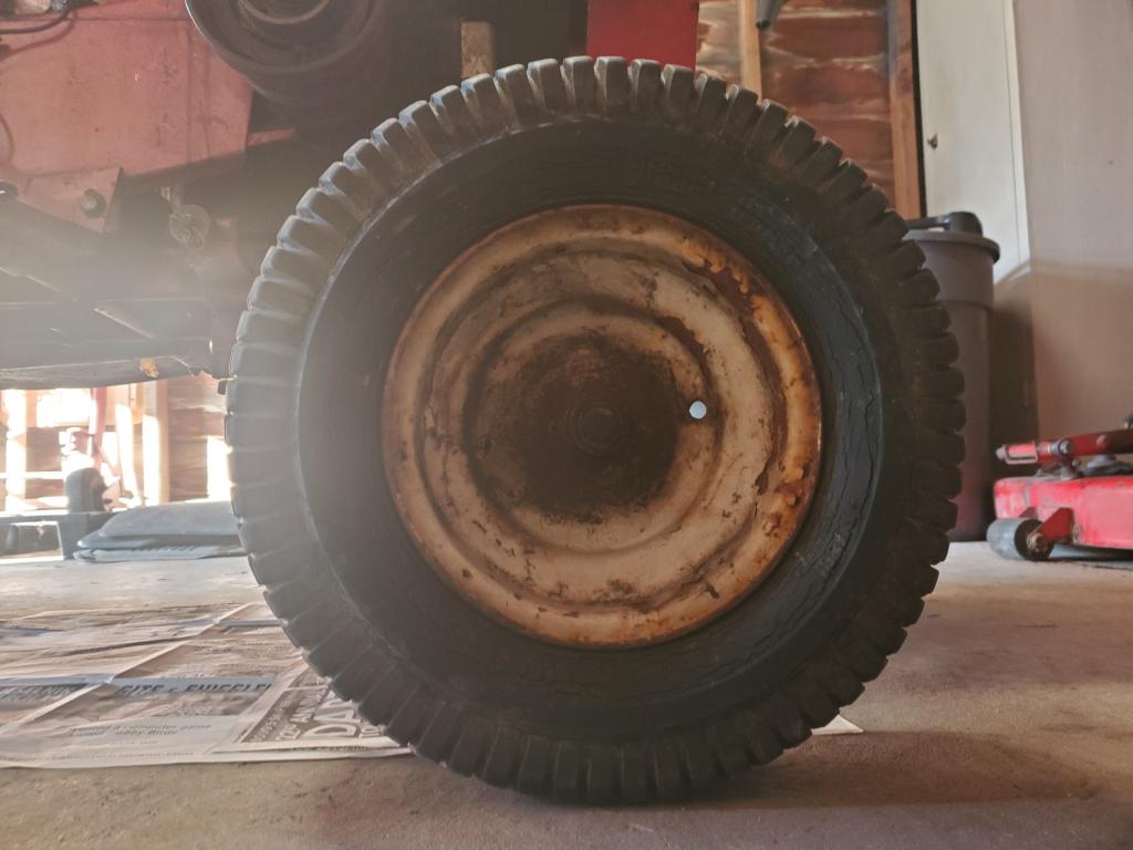

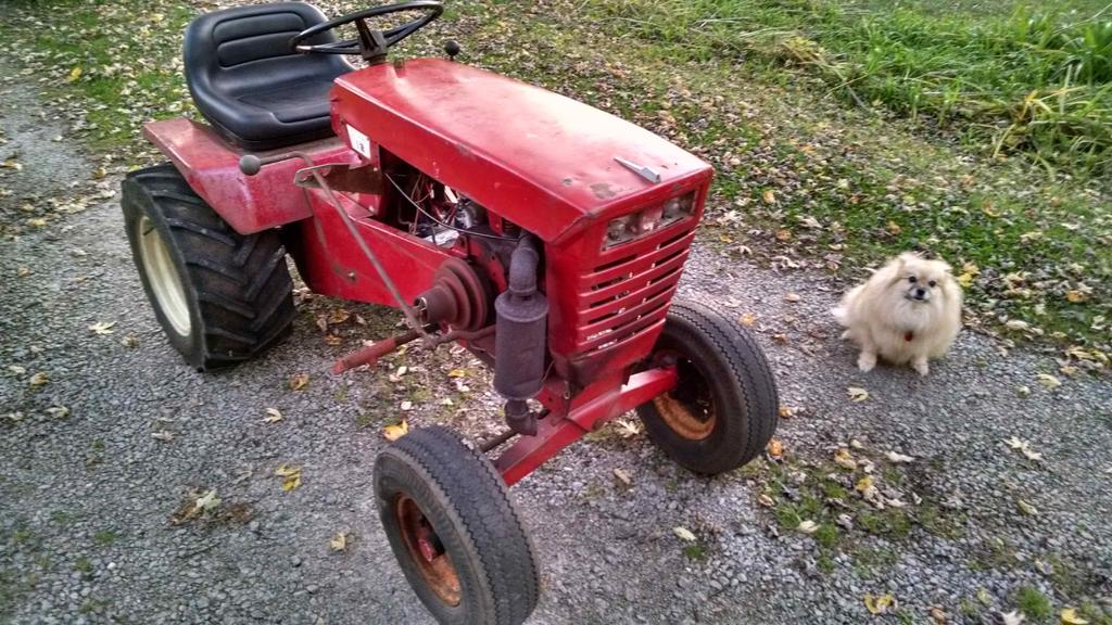

12Horse Paladin 1,038 #1 Posted November 24, 2019 (edited) Really...when is toomuch, when trying to save a Horse? I know it varies for everyone...and skill and $$$ are deciding factors...both of these which i have little to spare, at this point. But i figured, doing a little at a time...i could tackle this; learn a new skillset in the process. Now...i dunno if i bit off more than i can chew. See, i keep running into bigger n bigger issues that do/may need addressing on this horse. Now, my Dad...could handle most, maybe all, of this, pretty easy. Im not there, yet. I also dunno howmuch cash is ccx a good idea to throw at this, just to bring it back to center. Plan was, i have a few impilents i am not going to use i was hoping to sell, or trade, to the next WH guy to offset my costs. Somewhat. Not trying to make money. But because shipping these large items is(i know) a pain...here i set with a handful of things doing me nogood/taking up space. And now i have a snowblower thst needs a new home, too ...between just hydraulic hoses, and wanting to just replace my non working electric clutch (did check to see if it worked; believe it is cashed out), instead of going to a manual right now...these things add up, to a guy like me. Heck, even the tires...once i saw they were original WH branded ones...well, now i wanna tube those, too, lol. And i kno that, for sure, is something i have to pay someone else to do, at this point. (See pics, just cuz i like sharing these things) I guess in just trying to figure the best way to look...and go about...things, from here. And hoping i dont find more, larger, issues, as/if, i do, lol. Thanks for listenin' y'all. I'm not throwing in the towel, yet. But im hoping those of you more in the know; n yes; more capable (which truthfully is prettymuch all of you here, at this point) , might have some insigh or ideas or advice how to address some of these things.🤔 Yeah...maybe even a little encouragement, too.😉 Hope everyone has a great day. PS: just wanted to add, i use my equipment...other than hoping to do a rattle can repaint and adding some decals at some point...i never expected, or do expect, this to be a show machine. Just an honest worker. Still, i like things close to original, and all buggered up... Edited November 24, 2019 by 12Horse Paladin 1 Share this post Link to post Share on other sites

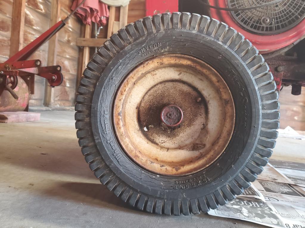

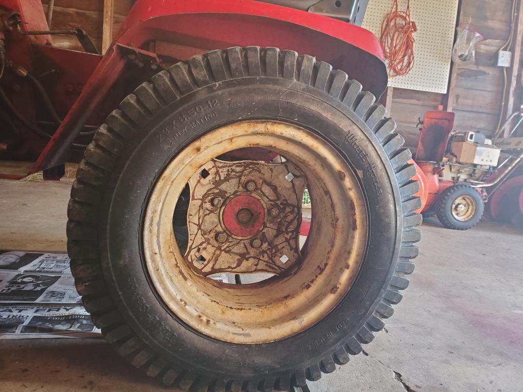

Retired Wrencher 7,037 #5 Posted November 24, 2019 Paladin Those tiers are good as long they hold air. when they go bad put tubes in them. Just take your time and find your way that is how most people do it. 2 Share this post Link to post Share on other sites
rjg854 13,422 #6 Posted November 24, 2019 I've got tires on some of my tractors with cracking similar to that without tubes in them. I've been running them yet, and until they have to be replaced, I'll keep running them. The old rule if it ain't broke don't fix it. I even managed to clean up the rims and repaint them without removing the tires. 2 Share this post Link to post Share on other sites
12Horse Paladin 1,038 #7 Posted November 24, 2019 5 minutes ago, 953 nut said: Your dad wasn't born knowing everything, bet he learned it by doing things and asking questions. Take on one project at a time and feel free to ask specific questions on here and we can provide some guidance. Good group of helpful members here. You are 100% right about that; all of it! Thankyou! 1 Share this post Link to post Share on other sites
12Horse Paladin 1,038 #8 Posted November 24, 2019 4 minutes ago, rjg854 said: I've got tires on some of my tractors with cracking similar to that without tubes in them. I've been running them yet, and until they have to be replaced, I'll keep running them. The old rule if it ain't broke don't fix it. I even managed to clean up the rims and repaint them without removing the tires. I have done the repaint bit, yes, without removing the tires, too😊 Share this post Link to post Share on other sites

rjg854 13,422 #10 Posted November 24, 2019 I more or less just got finished battling a rear wheel with a slow leak around the rim. I don't know how many times I removed the tire and broke it down in order to fix that slow leak. The last time seems to have worked. Tires aren't cheap, and I like the idea that the originals are still holding up. 52 years later 2 Share this post Link to post Share on other sites

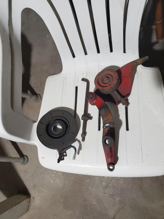

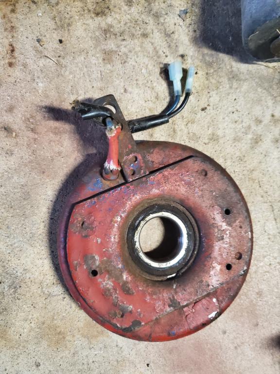

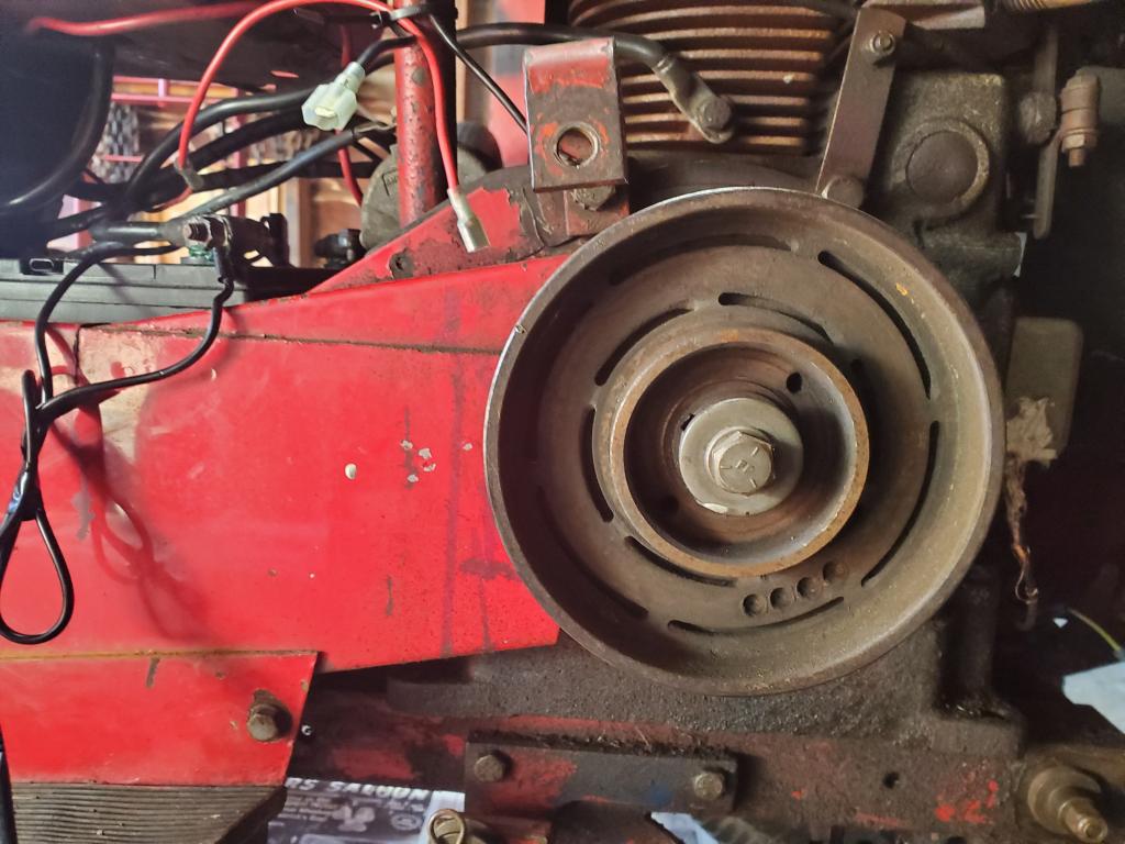

oliver2-44 11,820 #15 Posted November 24, 2019 (edited) If the engine runs good and the transmission seems solid, the rest can be done over time. Post a picture of your clutch and someone on here can advise you of the best way to test it and any possible repair options. @12Horse PaladinI have 2 electric clutches that I got with a pile of items. They are stored at the farm/barn 2 hours away. The next time I am down there I will pull them out and compare to what you post a picture of. I don't know much about these clutches either. But we'll both get some advise/lessons from others. If yours is toast, and one of mine is the right one for you, its yours for the cost of shipping. One of the wonderful things I've learned is we have the greatest members on Redsquare. Others on here have helped me out with parts, so now maybe I can pay it back. Edited November 24, 2019 by oliver2-44 2 1 2 Share this post Link to post Share on other sites
pfrederi 21,308 #16 Posted November 24, 2019 25 minutes ago, oliver2-44 said: If the engine runs good and the transmission seems solid, the rest can be done over time. Post a picture of your clutch and someone on here can advise you of the best way to test it and any possible repair options. @12Horse PaladinI have 2 electric clutches that I got with a pile of items. They are stored at the farm/barn 2 hours away. The next time I am down there I will pull them out and compare to what you post a picture of. I don't know much about these clutches either. But we'll both get some advise/lessons from others. If yours is toast, and one of mine is the right one for you, its yours for the cost of shipping. One of the wonderful things I've learned is we have the greatest members on Redsquare. Others on here have helped me out with parts, so now maybe I can pay it back. Wheel horse Electric PTO are pretty much all the same . They may require different push off bolts. They came in 1" an 1-1/8" even that is not a big deal as you can swap out the hub part (as it rarely fails) 1 Share this post Link to post Share on other sites

wallfish 20,733 #18 Posted November 24, 2019 You might be better off buying a mini tire changer machine instead of paying someone else to tube those tires. Ask your father if he will split the cost and also use a 20% off coupon to go even less expensive. Then you will be able to do your own plus charge your father to do his and make the money back. Now you'll have the ability to do more in the future and it cost you zero over time. https://www.harborfreight.com/mini-tire-changer-61179.html?_br_psugg_q=tire+changer Advertise your unwanted attachments on local craigslist. It's free and most likely to attract local buyers so there's no shipping hassles. What are you asking for the attachments? If your price is too high no matter what you think they should be, they won't sell if other options for less expensive items are out there. Take the time and search craigslist for those exact parts or attachments. If others are for sale then that will give you a better idea of what they are selling for. Just because they are listed at a price, doesn't mean they are selling at that price so look at how long they have been advertised 1 hour ago, oliver2-44 said: If yours is toast, and one of mine is the right one for you, its yours for the cost of shipping. One of the wonderful things I've learned is we have the greatest members on Redsquare. Others on here have helped me out with parts, so now maybe I can pay it back. Even though this has absolutely nothing to do with me, thank you for being part of what makes this forum what it is! 2 1 2 Share this post Link to post Share on other sites
12Horse Paladin 1,038 #19 Posted November 24, 2019 1 hour ago, oliver2-44 said: If the engine runs good and the transmission seems solid, the rest can be done over time. Post a picture of your clutch and someone on here can advise you of the best way to test it and any possible repair options. @12Horse PaladinI have 2 electric clutches that I got with a pile of items. They are stored at the farm/barn 2 hours away. The next time I am down there I will pull them out and compare to what you post a picture of. I don't know much about these clutches either. But we'll both get some advise/lessons from others. If yours is toast, and one of mine is the right one for you, its yours for the cost of shipping. One of the wonderful things I've learned is we have the greatest members on Redsquare. Others on here have helped me out with parts, so now maybe I can pay it back. Here are the pics i have; maybe this'll clear thst up...and thank you for your kind offer! If that ended up happening, i'd be most grateful; would gladly pay something though... As to testing that, clutch, my Dad was able to; no click. So unless i should try something else, i dunno. Share this post Link to post Share on other sites

pfrederi 21,308 #22 Posted November 24, 2019 14 minutes ago, 12Horse Paladin said: Here are the pics i have; maybe this'll clear thst up...and thank you for your kind offer! If that ended up happening, i'd be most grateful; would gladly pay something though... As to testing that, clutch, my Dad was able to; no click. So unless i should try something else, i dunno. Sorry when I told how to test and hear a click I didn't realize your PTO had been taken apart. The part in the last picture and on the chair is the field coil. Use you multimeter to check for continuity between the two leads. You should show 3-4 ohms. 4 Share this post Link to post Share on other sites
Achto 32,927 #23 Posted November 24, 2019 @12Horse Paladin It is easy to get discouraged when you buy some thing and feel that you can't use it right away. I usually pick up tractors for under $200, this way I expect them to be a POS. There are a few ways to go about getting your tractor ready, I'll share 2 different ways that I've used. First my C145 - I bought this tractor drove it around a while kicked a few "shoe man" (cobbler) repairs out of it and now I'm using it as a snow plow tractor. The hubs are tight on the axle so I have not looked at them any further. One "shoe man" repair that still remains is the alligator clip that connects the spark plug wire to the spark plug, doesn't seem to effect the performance so I'm not too worried about it. It ain't purty but it seems to be holding together. Then there is my Raider 12. I bought this tractor & left it sit for a bit before doing any thing with it. Then I decided it would be a good tractor for mold board plowing. @WHX24 was having a plow day at his house and of course I waited till the last minute to throw a few Band Aids over some issue that it had and drug it over for a plow day. The results were not exactly satisfactory. Most of my Band Aids held but I shook out a whole bunch of other issues and before the end of the day it died do to a charging issue. There was only one way to tackle this tractor. Turn it into a pile of parts & start over, Here is the end result. Now I know you're thinking "That's great but I'm not looking for a show tractor" Well I'm not one bit afraid to work this 'ole girl like a rented mule. It has spent most of its new born life dragging a Brinly plow through the dirt. Don't get discouraged & if you find some thing completely out of your realm that I might be able help you out with, I'd be happy to. Heck we don't live that far apart. 3 7 1 1 Share this post Link to post Share on other sites
953 nut 70,347 #24 Posted November 24, 2019 5 hours ago, pfrederi said: Use you multimeter to check for continuity between the two leads. You should show 3-4 ohms. If you don't have a meter you can connect one wire on the clutch part to the "-" of a 12 volt battery and the other wire the "+" and see if it will become magnetized. If the coil inside is good it will spark a little when you connect the second wire. 2 Share this post Link to post Share on other sites
Pullstart 71,520 #25 Posted November 25, 2019 I’m not sure if it was posted what you gave for your Charger, but I call it far from a lost cause! Unless you need this thing yesterday, be patient on the bits and pieces you want to upgrade. As far as the tires, a tube job is fairly easy. You only need to break one bead. Do you have any big c-clamps? You can clamp a piece of 2x4 on each side of the beads and one will pop. Spoon the tire off that Sid e of the wheel, or just shoehorn the tube between the wheel and tire then re-assemble and inflate. I don’t have anything with the electric clutch, but does anyone know if one from say a vertical shaft lawn mower might work? Maybe one of those could be easy to obtain? 3 1 Share this post Link to post Share on other sites
