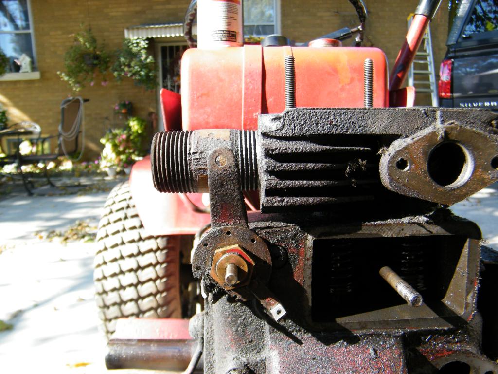

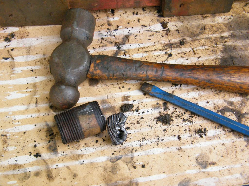

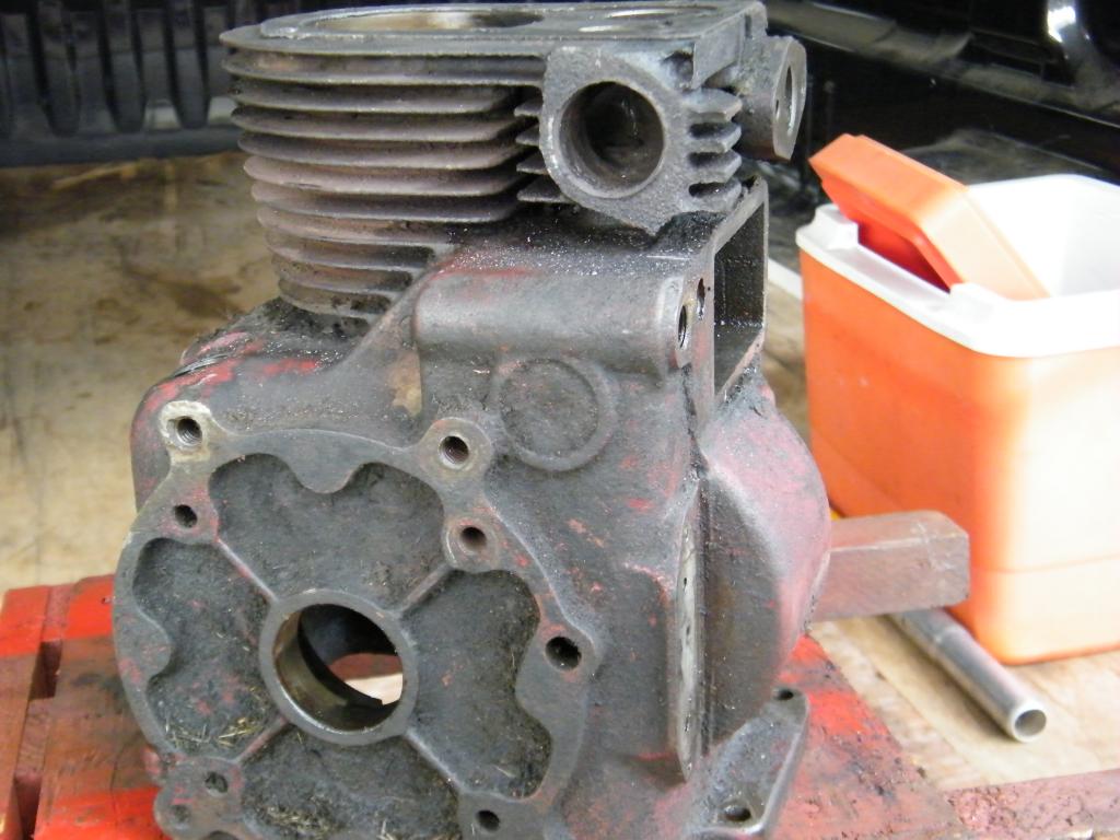

JoeM 10,155 #1 Posted November 24, 2019 I was working on an old Kohler and the PO installed a pipe nipple and sprinkler head muffler. Wanting to change the configuration, I set out to remove the old nipple and found mother natures Loctite, (rust), was used. I have had these in the past and most come out with a big pipe wrench, but this one was not go. It was so tight the nipple was distorted. I removed the last one like this by cutting the nipple off within a 1/4" of the block and used a loose hacksaw blade to cut through the side wall of the nipple, in two places, until I nicked the threads. If you have a good blade, it cuts fairly easy. Then bump in the piece and removed the nipple, Tapped the thread and it worked out okay. I figure there are others that had this issue and I am sure there are other ways, possibly easer. It is just simply amazing how that rust can hold on and make metal stick. I included a few pics. 7 2 Share this post Link to post Share on other sites

stevasaurus 23,802 #15 Posted November 24, 2019 I just cut the nipple so about 1/4" was sticking out, then, with a cold chisel collapsed what was left of the nipple in the block. It collapsed easily and then pulled out. Re-tapped the threads with a sacrificial nipple. I'm frugal. 3 1 Share this post Link to post Share on other sites

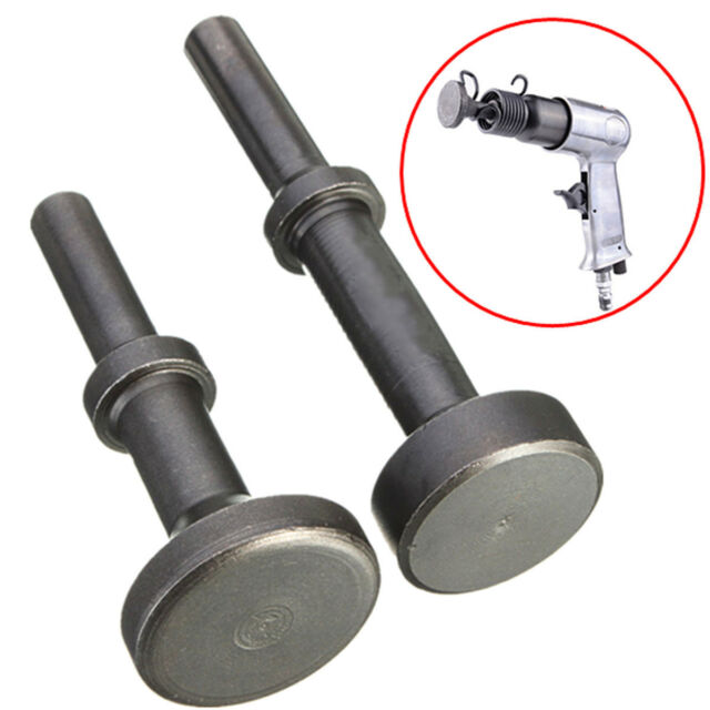

cafoose 3,814 #18 Posted November 24, 2019 42 minutes ago, Achto said: Another trick that has worked well for me. Before you try to loosen the pipe smack it a few good times with a hammer. Not so hard as to crack the engine casting but some good whacks. This jars the rust & will help the threads break loose from years of brown weld. I learned this trick from a pipe fitter & it has worked every time for me. Maybe use something like this on an air hammer? 2 Share this post Link to post Share on other sites
Achto 32,347 #19 Posted November 24, 2019 9 minutes ago, cafoose said: Maybe use something like this on an air hammer? This does work most excellently and I do use it. But not all have the luxury of air tools. Figured every one would have a hammer though. 1 Share this post Link to post Share on other sites
