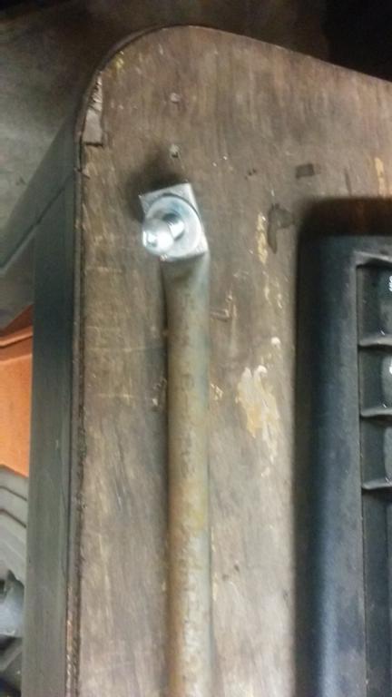

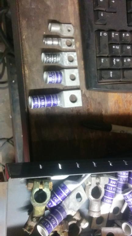

MikMacMike 494 #13 Posted December 11, 2019 On 12/1/2019 at 8:42 PM, ebinmaine said: Garry I'd be very very interested to see a few pictures of that if you would be so kind. Maybe next time you make up a couple.... That's absolutely something we would do here. Yupper The best way is to make your own.....I get these from working in the generating plants and the nuclear plants from some of the guys in the electrical trades they work excellent.....and like ebinmaine sais always solder them and wash em good afterwards with backing soda n water...then adding heat shrink. as i install I slap the die electric grease to protect it all too. If you dont have access to these electrical wholesale might sell or if they wont sell to public again just ask a local electrician. But in the end the cheapest way is also like what ebinmaine said, soft copper or even hard copper. with hard copper tube make sure its type k or L its heavier then M which is whats used on residential water lines in your home....when I make struts for light weight purposes I do exactly the same with steel tubing of almost any size like the second pic. 2 Share this post Link to post Share on other sites

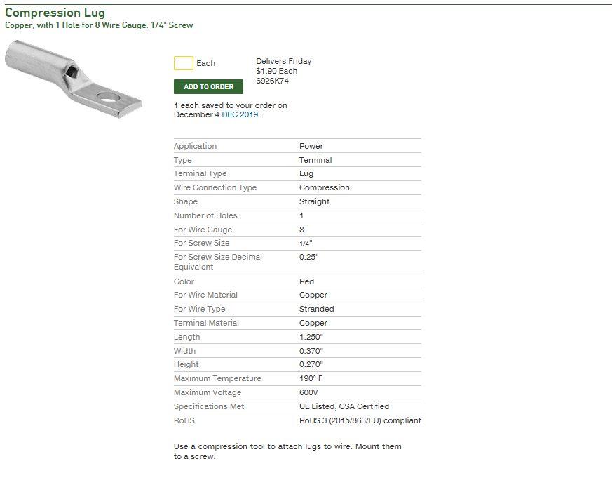

pfrederi 21,183 #16 Posted December 12, 2019 McMaster 2 Share this post Link to post Share on other sites
MikMacMike 494 #17 Posted December 12, 2019 21 minutes ago, ebinmaine said: Or a bird's nest. I do love a good bird's nest. Wait'll I get into the Ferguson.... There's about a dozen wires hanging out of the back of the dash that go NOwhere... hahahaha too funny.....i bet he comes back sayin...hey thats for future aditions hehehehe 1 Share this post Link to post Share on other sites
MikMacMike 494 #18 Posted December 12, 2019 19 minutes ago, pfrederi said: McMaster There it is....those make such neat work and they always last far longer then the crimped cables at CrappyTire stores Share this post Link to post Share on other sites
