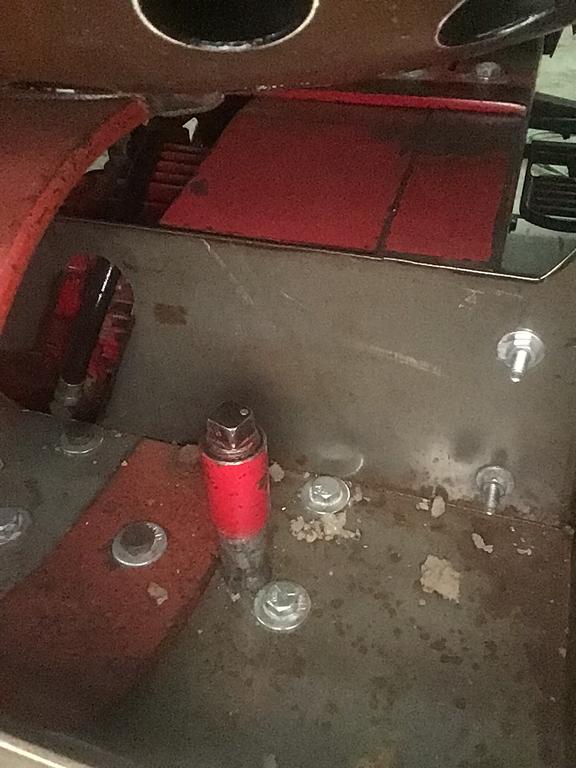

Mr Magoo 226 #1 Posted November 21, 2019 I have a C-120 I am working on and it has a dipstick where the rubber seal is falling apart. Am I correct to assume that this system needs to be under pressure and that is the reason for the rubber seal on the dipstick? I am worried that pieces of the seal are or have fallen down inside and may cause a blockage. Does anyone have a fix for this or know where to find a replacement? Ken Share this post Link to post Share on other sites

Pullstart 68,944 #3 Posted November 21, 2019 I assume the pipe size is 1/2” for the dipstick tube. This Charger 12 trans has a threaded dipstick similar to an engine’s. Maybe you could use that style as an easy replacement? Here is a picture of “Frank’s” toolbox area... 2 Share this post Link to post Share on other sites
