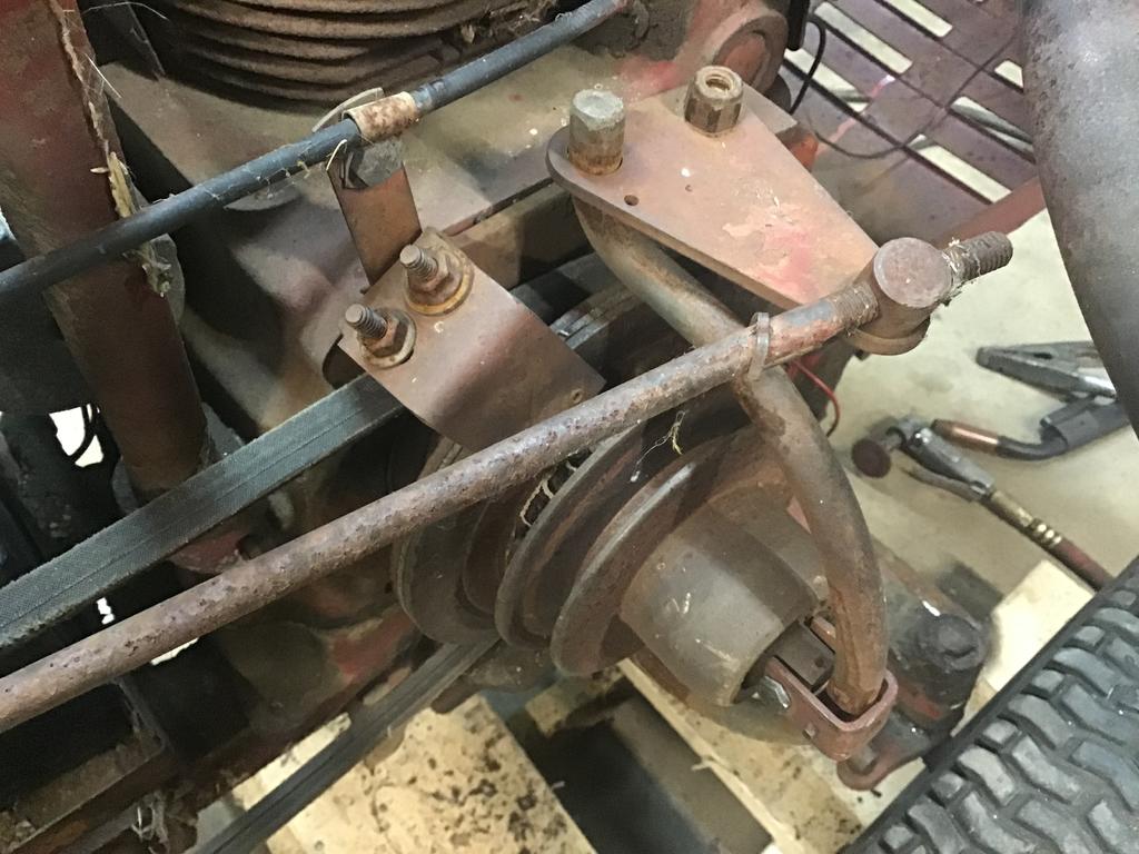

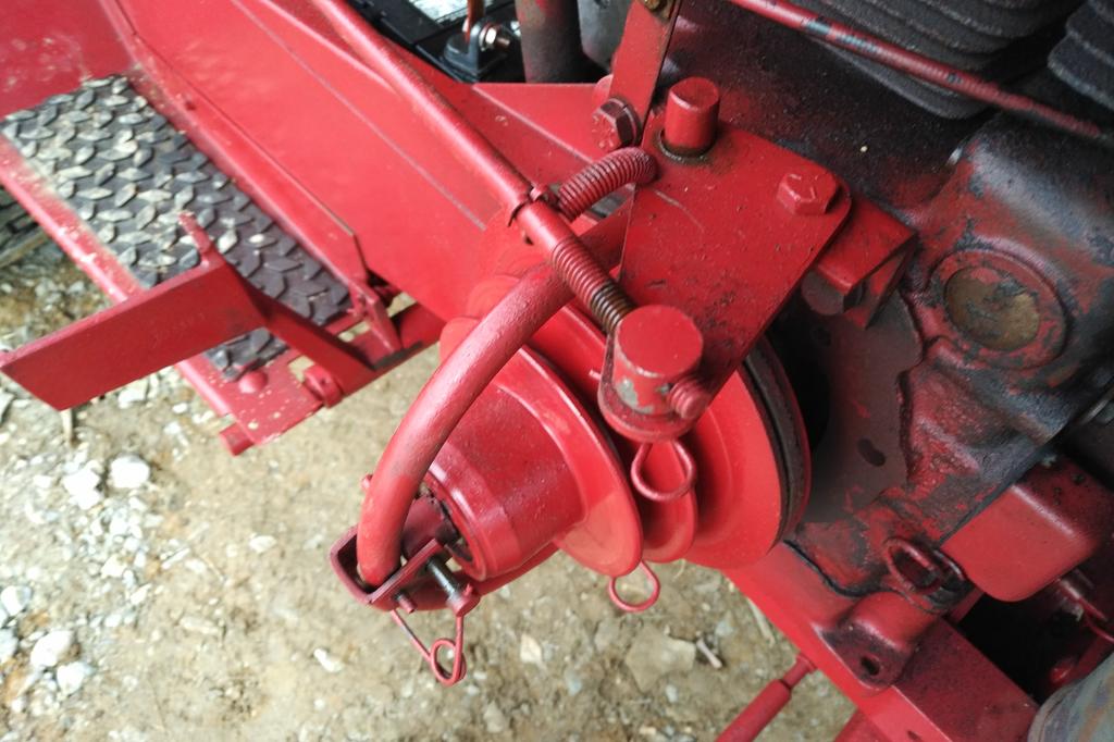

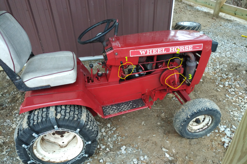

cjb398 40 #1 Posted November 21, 2019 I just picked up a C-160. I bought it with a snowplow attached, so didn't notice that the PTO seems to always be engaged.The outer part of the PTO is always spinning and when I disengage it, it doesn't stay disengaged. It just falls together and there is no spring pressure on the PTO handle like on my 312-8 that keeps the clutch plates apart. The first picture shows the spring between the rod and the triangular plate (not sure what it's called). Is it connected right? It has no tension and actually seems too big. Also, in the second picture in area 1, there is no return spring like on my 312-8 that keeps the PTO handle in the disengaged position. Should there be? Or is there a spring in area 3 in the hub that keeps the clutch plates separated? The IPL's I've seen are fuzzy and I can't make it out. Thanks. Share this post Link to post Share on other sites
Pullstart 71,520 #2 Posted November 21, 2019 If I haven’t said hi yet, ! it looks like that spring is much too large. It also appears you are missing the pro brake components. This C-160 doesn’t have the spring, but it does have the brake at least. Share this post Link to post Share on other sites
cjb398 40 #3 Posted November 22, 2019 Thanks. Actually that spring was kinked when I took the picture. I straightened it out and it fits without a bend in it. However, it has no tension when it is engaged and very little when it is disengaged. So I think it is too big, too. Would the missing brake pieces cause the problems I'm having? Seems like there's still a spring somewhere that should provide tension that is missing or stretched. Just not sure how it is supposed to work. Share this post Link to post Share on other sites
Pullstart 71,520 #4 Posted November 22, 2019 I will have to look around to see what else I have for reference on that style PTO. The spring helps keep it in position (I think engaged and disengaged both alike) and the little brake stops the spinning when it is disengaged. Have you looked through manuals and parts lists for the machine to see what the proper spring is? Possibly if you have trouble finding one you could pull that spring and take it to ACE or another hardware store to match up to a similar spring. My local store has about every spring one might imagine in the GT size range. 1 Share this post Link to post Share on other sites

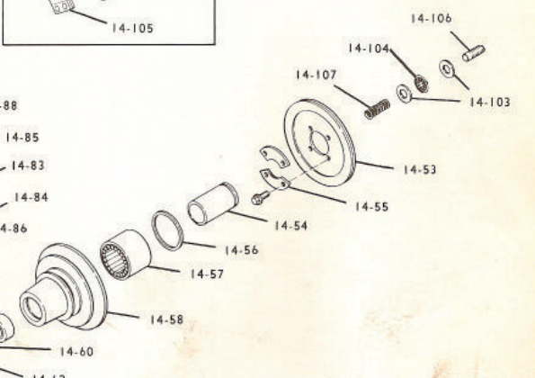

rmaynard 17,644 #7 Posted November 23, 2019 (edited) Just an observation, but you are missing the brake. PTO will never stop spinning without it. Also, the little spring on top is only used to keep tension on the rod to keep it from rattling. Inside the PTO at the end of the crankshaft, there should be a stud (14-106 in drawing) screwed into the end of the crank. Over that stud should be a spring (14-107) that helps push the PTO out when disengaged. This spring pushes the PTO or against the brake pad to stop it. The gap between the pad and the PTO bell when disengaged should be .012". In later models the stud and spring was eliminated and the PTO bell was held outward by the action of a redesigned engage/disengage lever attachment at the end of the PTO bell. Edited November 23, 2019 by rmaynard 1 1 Share this post Link to post Share on other sites
cjb398 40 #8 Posted November 23, 2019 Thanks RMaynard. Spring 14-107 is probably missing. I have the brake parts on order. Share this post Link to post Share on other sites

Lee1977 7,809 #11 Posted November 30, 2019 (edited) It looks to me that the thorttle cable bracket has it jambed in place. If it mounts there it should be on the back side out of the way PTO triangle. Edited November 30, 2019 by Lee1977 Share this post Link to post Share on other sites
cjb398 40 #12 Posted November 30, 2019 2 hours ago, Lee1977 said: It looks to me that the thorttle cable bracket has it jambed in place. If it mounts there it should be on the back side out of the way PTO triangle. That's actually not a problem. The picture is deceiving. Share this post Link to post Share on other sites
