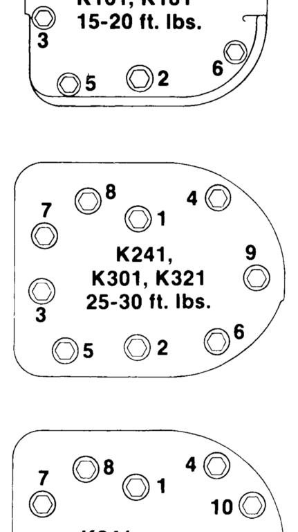

Rick Ferrucci 17 #1 Posted November 21, 2019 Hello everyone, I’m about to re-install the head on my GT14. I got a new gasket, and I resurfaced the head. Does anyone have a reference where I can find the head bolt tightening sequence for a K321 engine. Thank You Rick Share this post Link to post Share on other sites
953 nut 69,581 #2 Posted November 21, 2019 This manual will give you all the information you may need. Remember to hot torque the head after it has been run a few minutes. 4 1 Share this post Link to post Share on other sites
The Tuul Crib 7,354 #3 Posted November 21, 2019 3 1 Share this post Link to post Share on other sites
WHX?? 58,238 #4 Posted November 21, 2019 You guys are my heros. .can't do that on a stupid tablet In case I haven't done so Rick I have good luck going to 25 then as Richard suggested going to 30 or even 32/34 thead conditions allowing. Your choice of thread lube helps. Share this post Link to post Share on other sites
The Tuul Crib 7,354 #5 Posted November 21, 2019 And where are my manners! to 1 Share this post Link to post Share on other sites
Rick Ferrucci 17 #6 Posted November 21, 2019 This is so great excellent! I knew I could count on Red Square. Thank you everyone. Rick 4 Share this post Link to post Share on other sites
