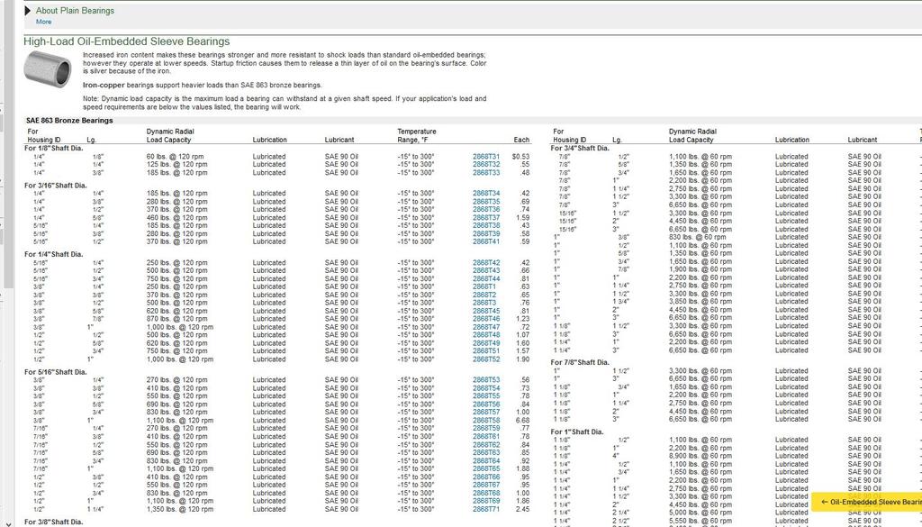

pfrederi 20,870 #2 Posted November 19, 2019 I find the bolt wears faster than the hub a new bolt may help. or you could drill out the and press in something like one of these. 1 Share this post Link to post Share on other sites

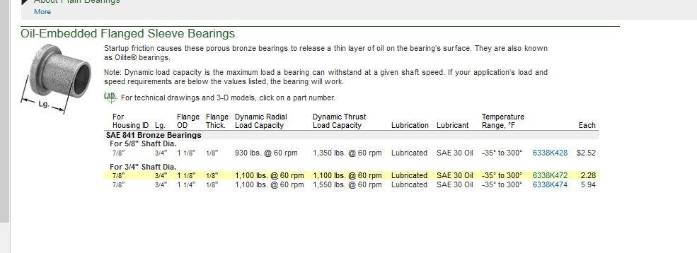

pfrederi 20,870 #4 Posted November 20, 2019 They are Flanged sleeve bearings 1/2 ID 7/8 OD 5/8 long (Flange is 1/8" thick) Couldn't find them at McMaster 3/4 OD was biggest they had for 1/2 ID Share this post Link to post Share on other sites
pfrederi 20,870 #5 Posted November 20, 2019 (edited) 26 minutes ago, Bill D said: I thought of that. I was hoping to find a bearing that would fit. I've been making my own shoulder bolts using grade 8 bolts and steel tubing. Bill If you upped your shoulder bolt to 5/8" you could do these. I looked at Fastnal and MSC only thing i found MSC had Polyethene in that size for $11.22 each Edited November 20, 2019 by pfrederi Share this post Link to post Share on other sites

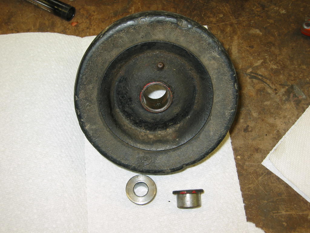

pfrederi 20,870 #8 Posted November 20, 2019 Picture of wheel with bearings out. You could sleeve the hub down to fit flange bearings. note that there is one hole in the hub for grease and it is opposite the grease fitting. Share this post Link to post Share on other sites
