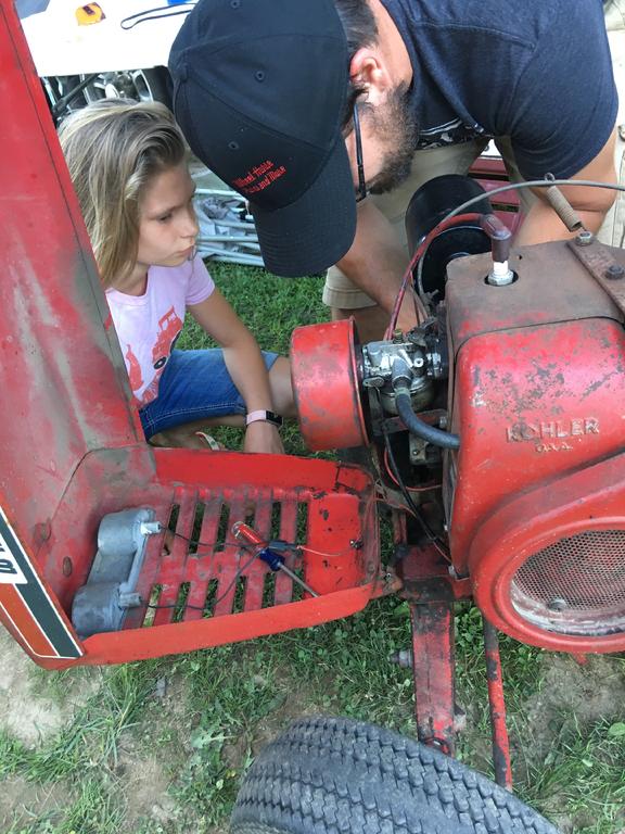

Pullstart 71,520 #11 Posted November 18, 2019 I’m not so sure we’ve met, so.. Hi, I’m Pullstart/Kevin! back to !! I have all kinds of fun with my wife and daughters on the tractors, my now 10 year old even bought herself her own 1076 in March! Most the stuff I work on gets customized from mild to wild and my kids have been shop helpers for pretty much their whole lives. I can’t wait to see your “clean up” work! 1 3 Share this post Link to post Share on other sites
